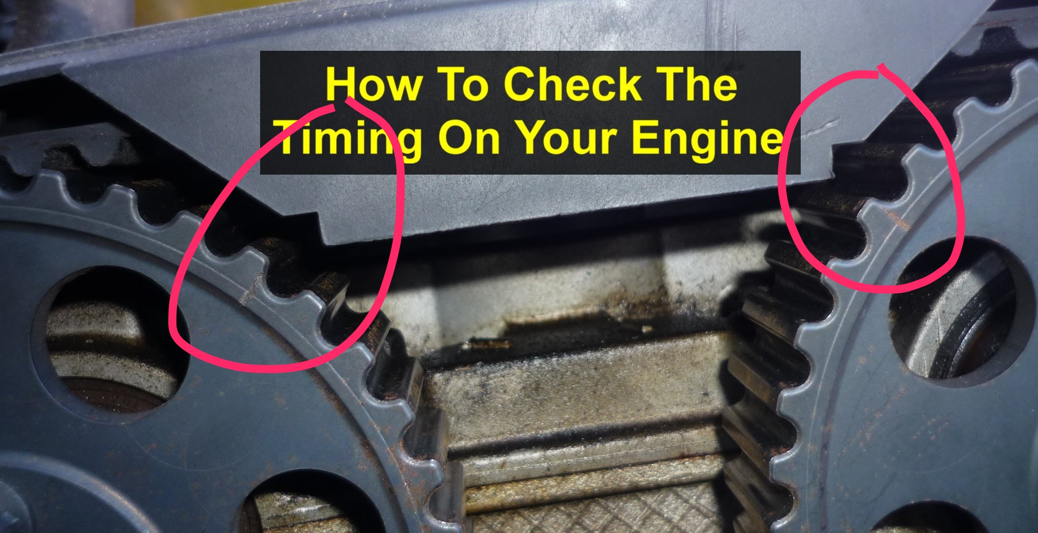

I would do this first, before removing the intake again... I would crank the engine until you get it to fall into the default timing position. To test this you will have to remove the timing belt cover. (You only need to remove one 12mm bolt to take off the main face of the timing belt cover) crank the engine until it falls into the default position. You may have to do this a lot if you have bad luck (you can also self crank the engine if you want, that's its own process). There are two etch marks in the cams sprockets that show when you are in default timing. Crank engine until it falls on the right timing. If the etch marks don't line up you have timing issues, but I doubt that happened. The etch marks will line up with the cut corners in the upper timing belt cover seen in picture below. etch marks in Picture below.
Once you have the etch marks lined up from crank roulette or manually cranking the car, remove the distributor and cam sensor. (question: did you remove the spark plug wires from the distributor when you removed it last? Maybe you put them in wrong order?)
Remove the distributor and the cam sensor and make sure the router and cam sensor guide are in default positions. (I have put them in backwards) view pictures below to see default positions. I would remove the router and make sure the bolts that hold the cam sensor guide and the routers base cam plate are tightened down snug.
If you remove both the router and the plate it rests on as well as the cam sensor guide you will see the end of the cams and both grooves in the end of the cams should be flat and lined up with the where the cam cover meets the head. See picture below. (Ignore yellow circles and just look at end of cam where router should be.. see how it's lying flat?) if both cams are lying flat, then the router and cam sensor guide should look exactly like pictures above)
I have had that bolt under the router loosen up just from replacing the router, I have put in the router plate backwards and had my routers timing off, same goes for the cam sensor guide. Make sure all these things are lined up.
