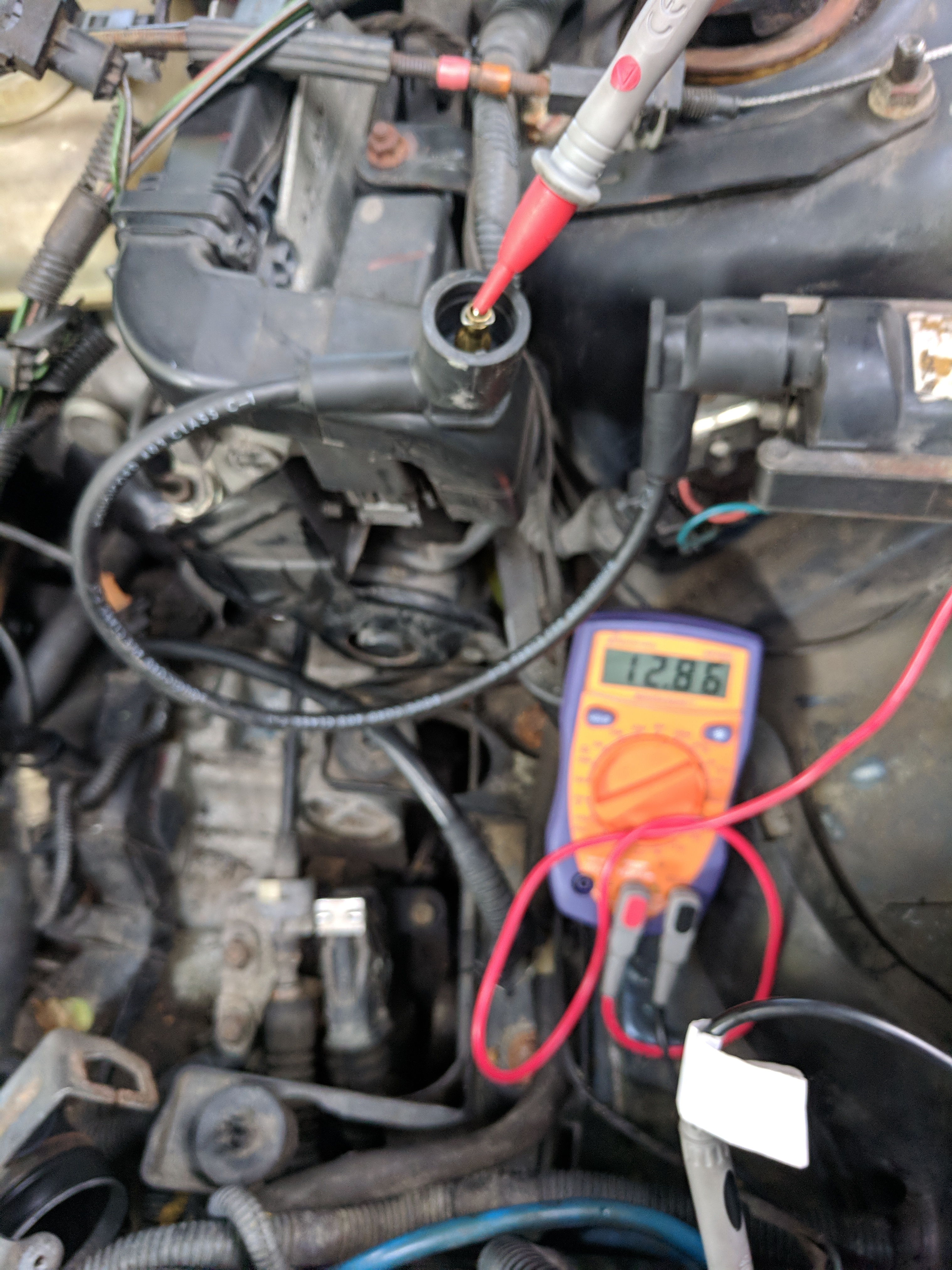

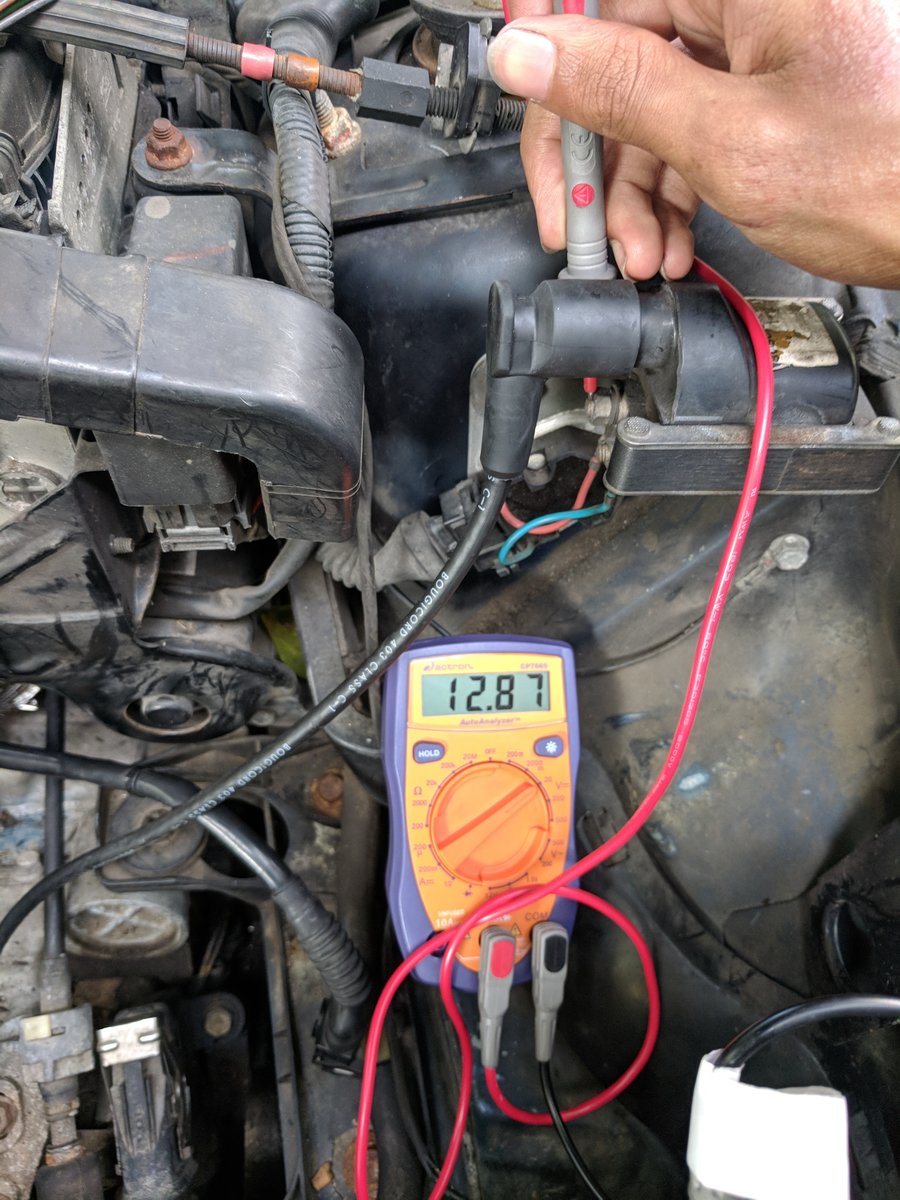

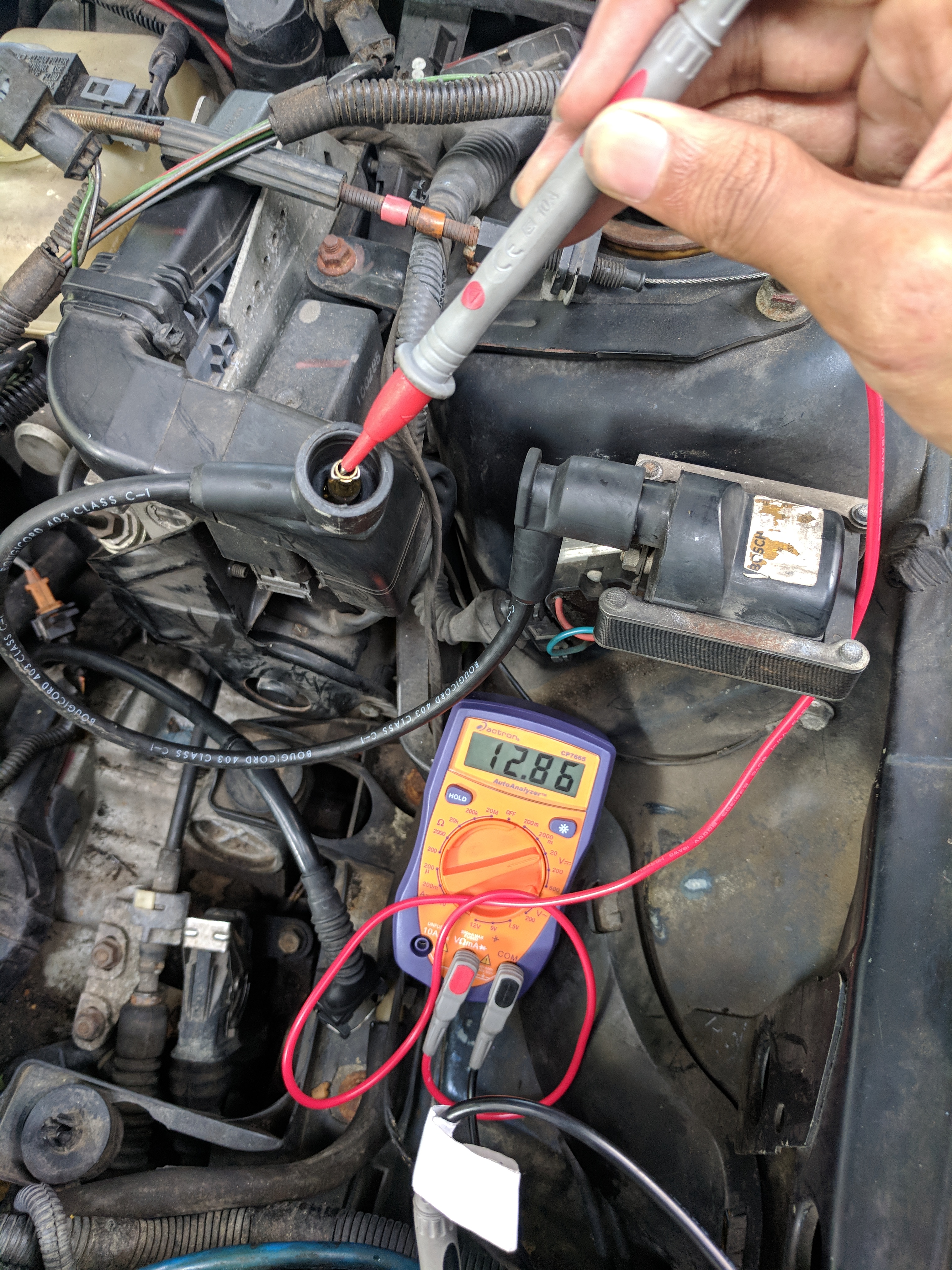

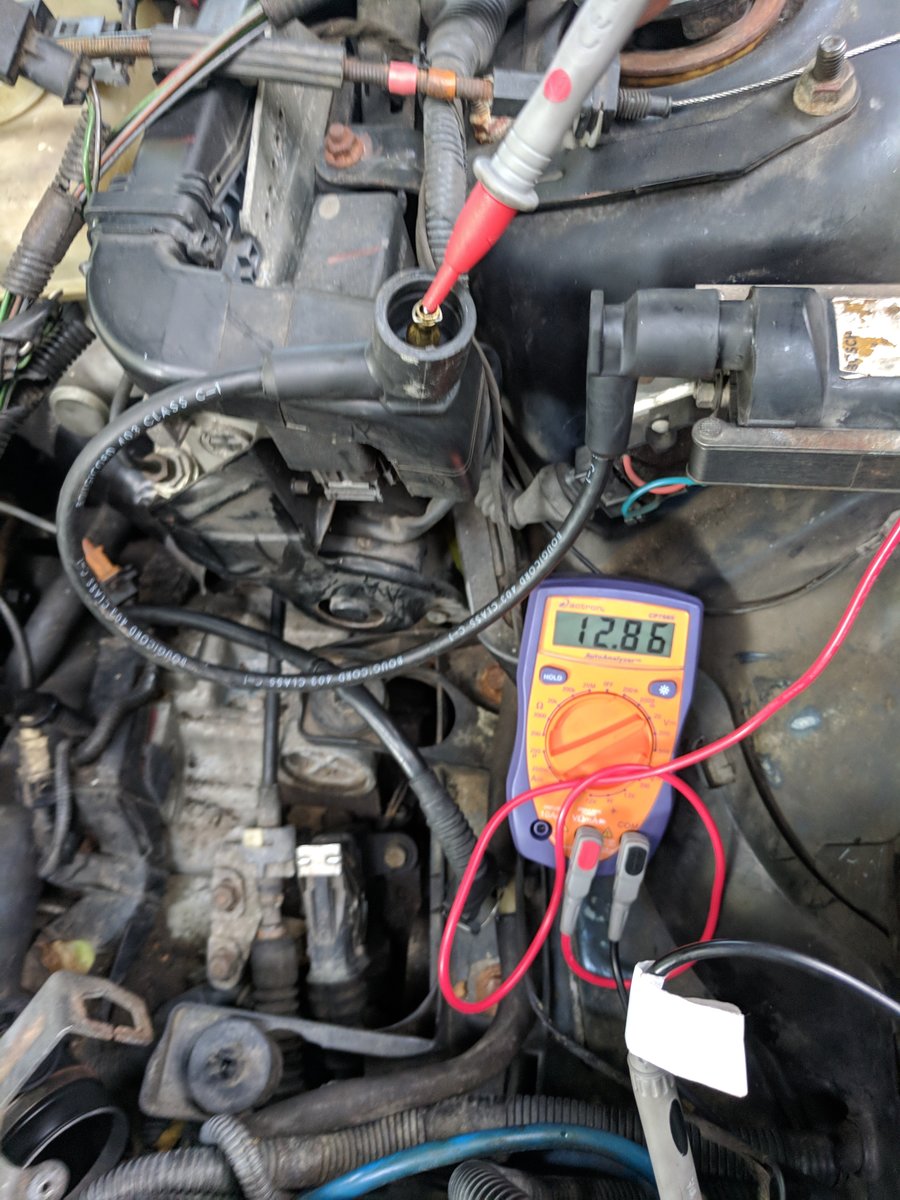

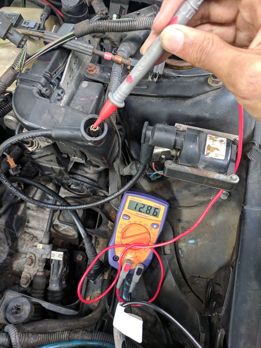

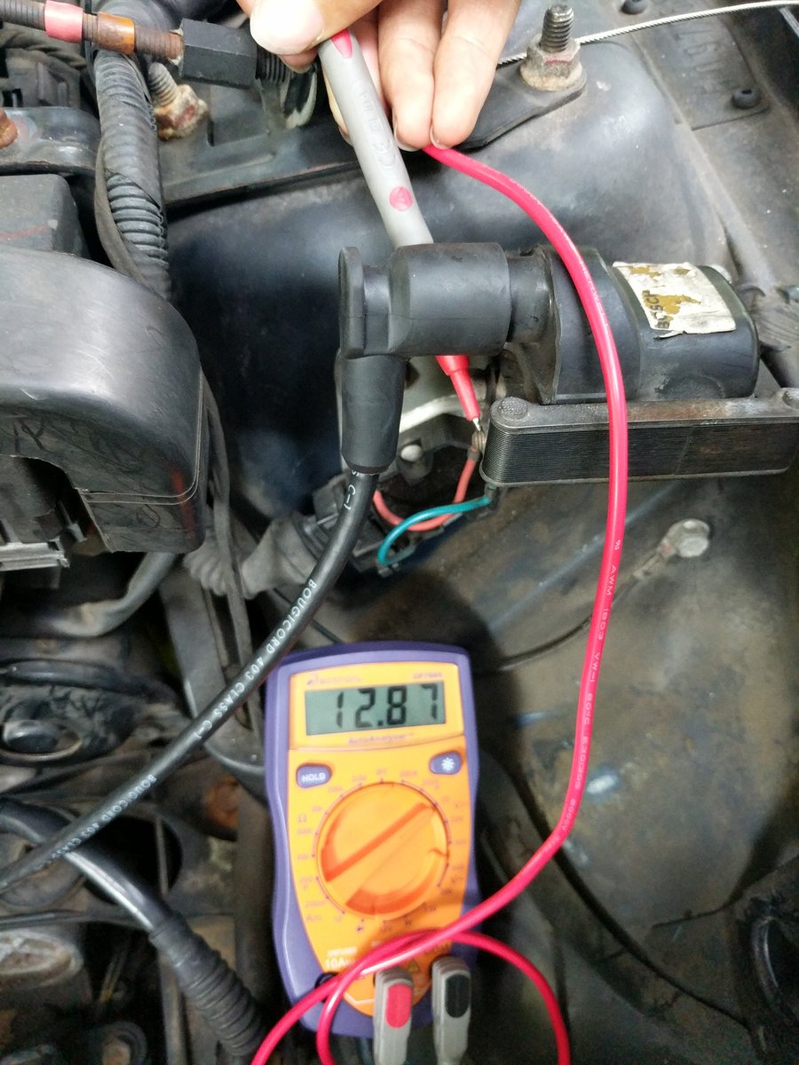

Testing ignition coil components:
1) Plus side: 12V
2) Negative: 12V
3) When cranked, fell down to ~11V

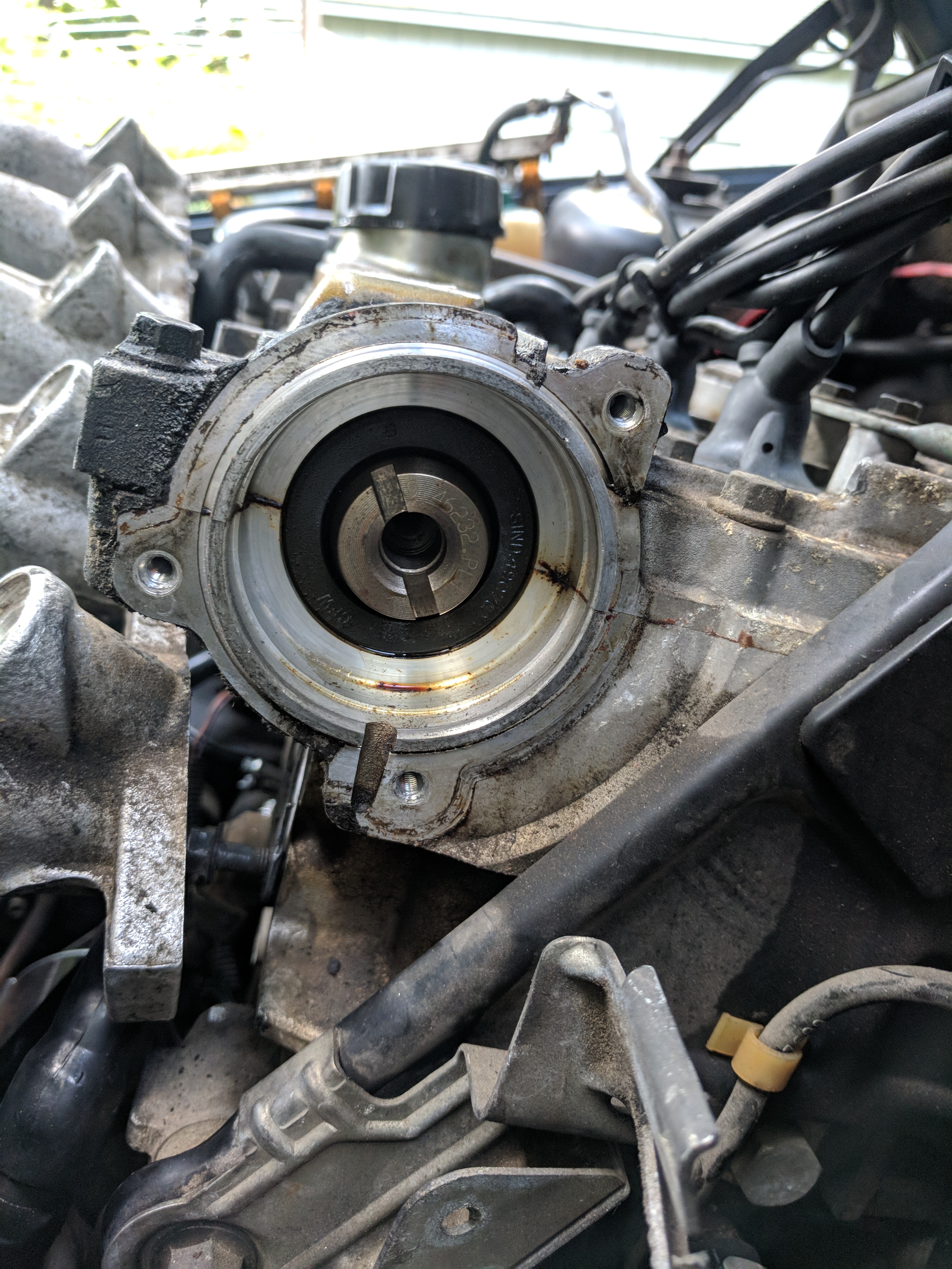

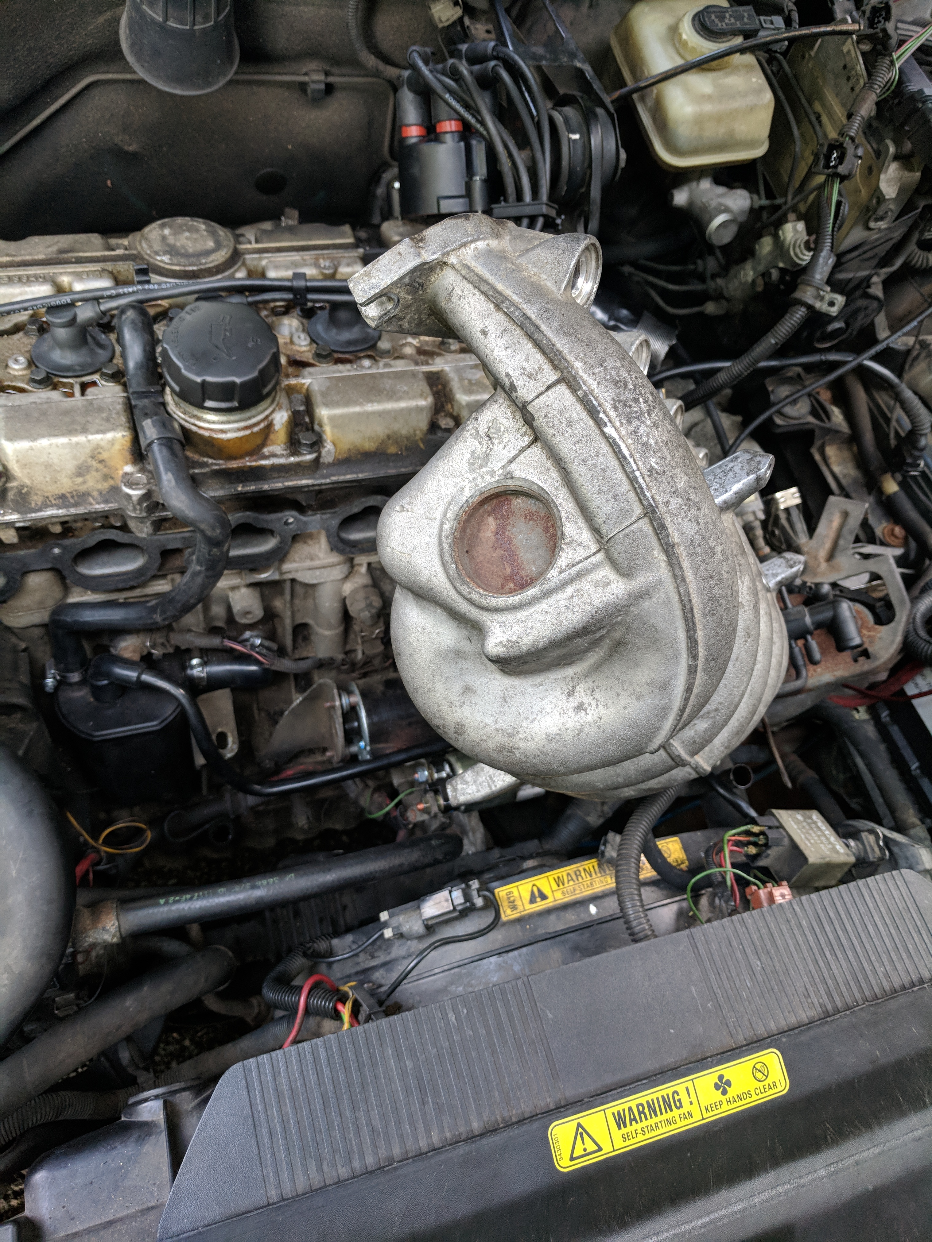

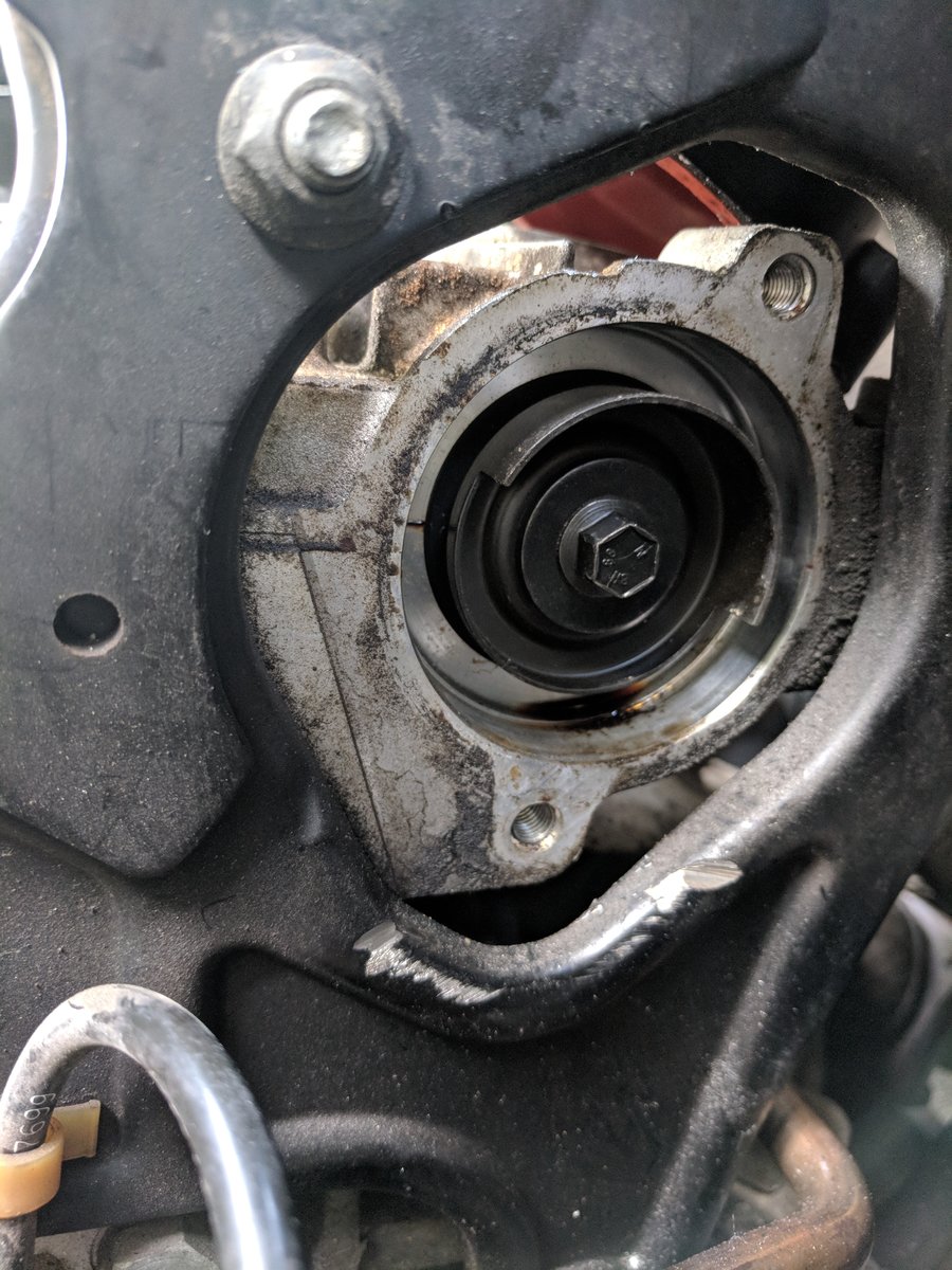

Cam and rotor (and rotor plate) removed:
My intake doesn't have a vacuum tube on the left side of it. I was confused too, don't worry...
Key in position 2, end of ignition coil:

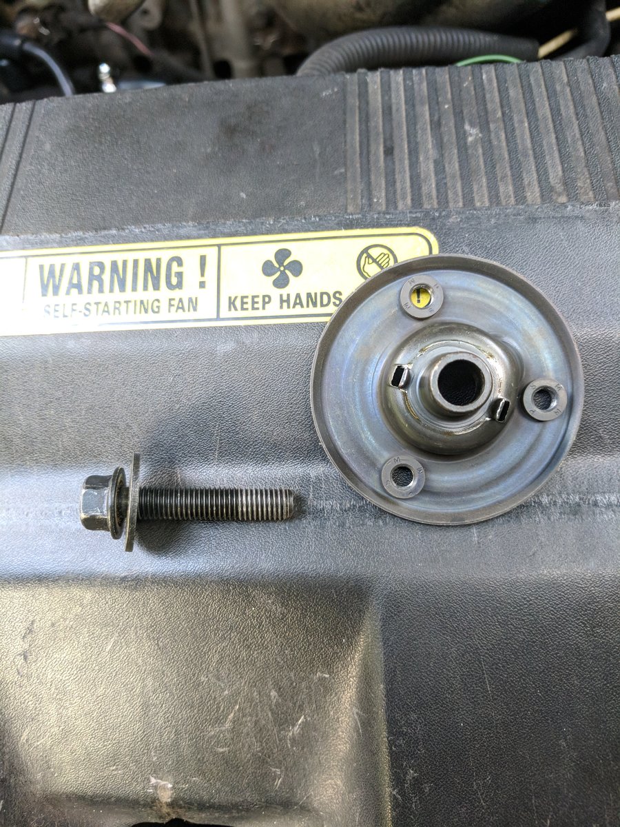

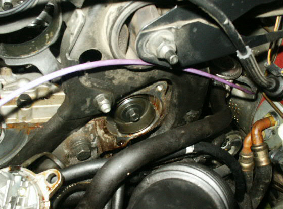

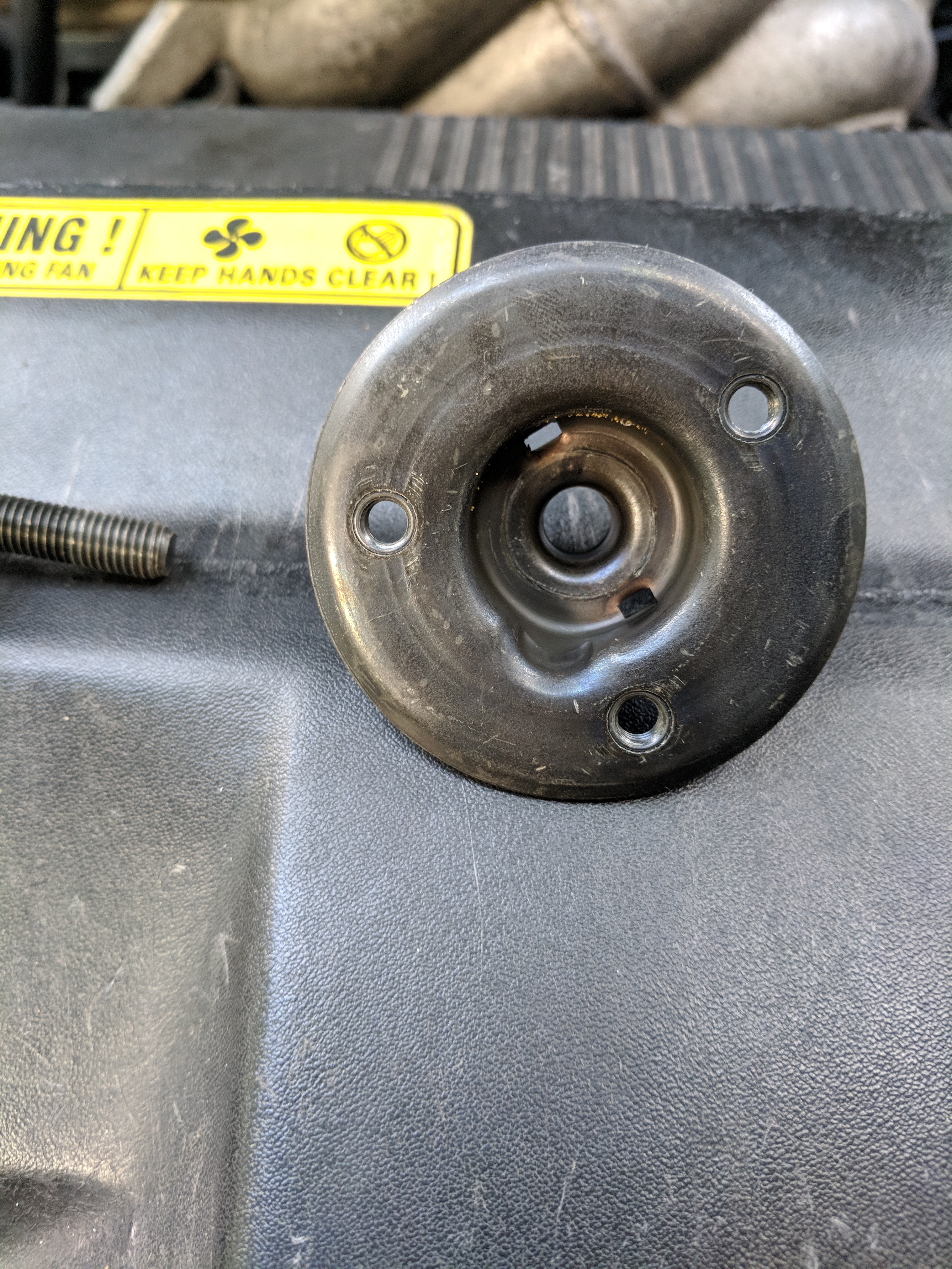

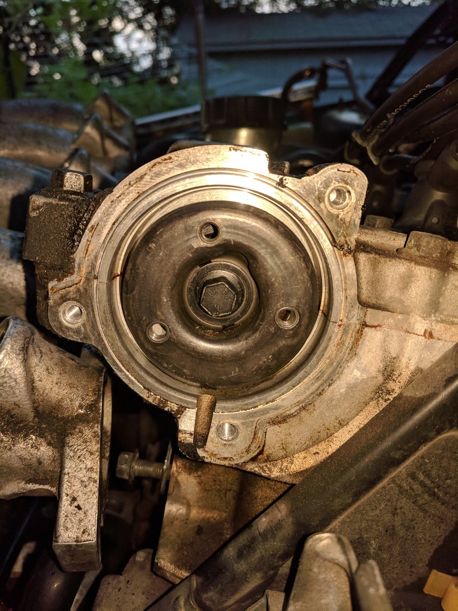

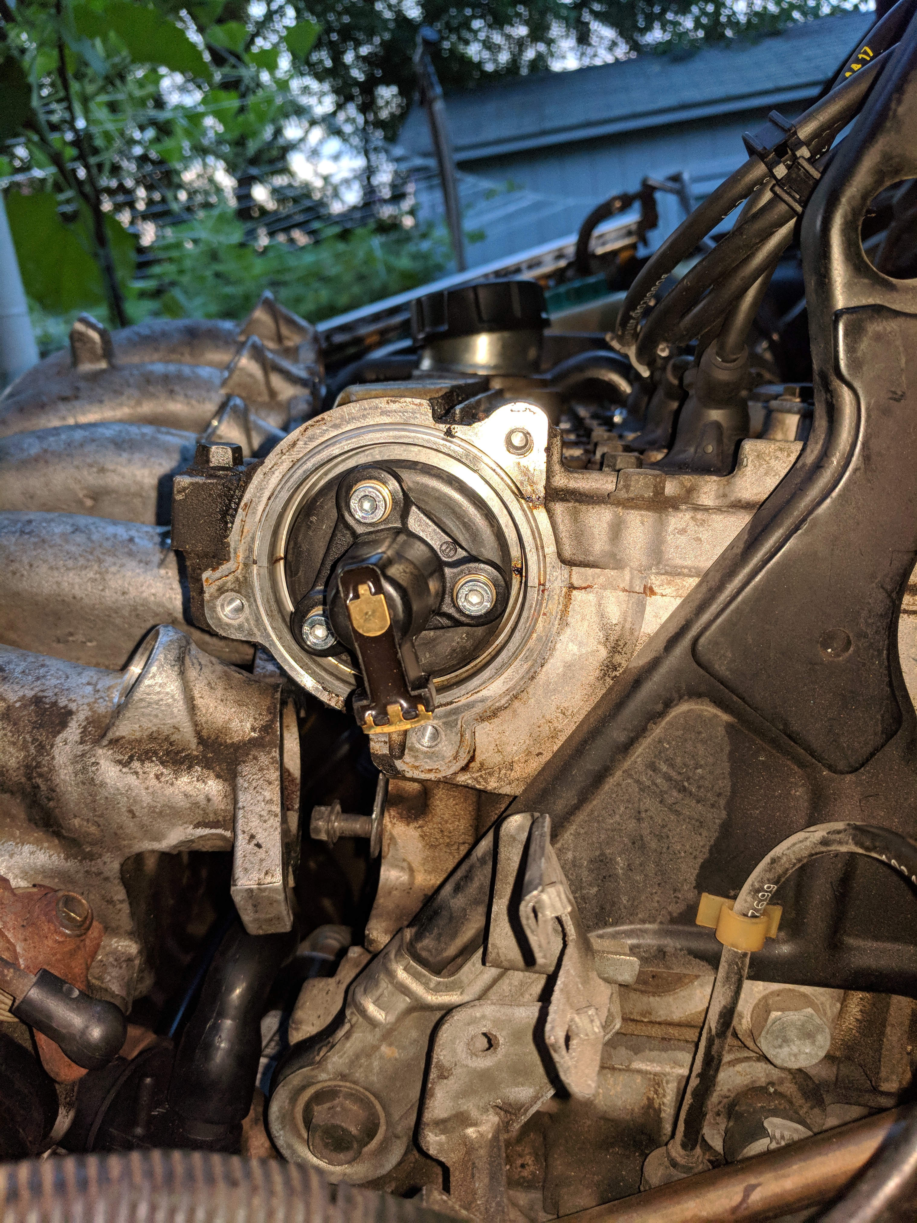

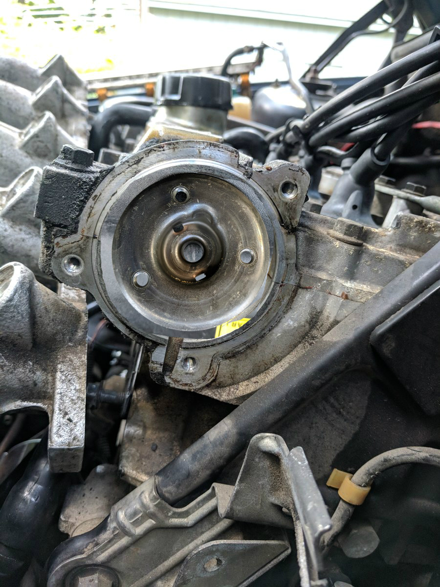

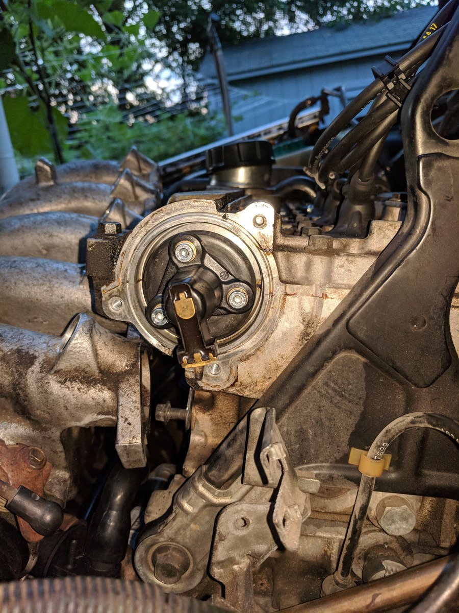

if you haven't cranked the engine from previous photos your rotor is on backwards. The rotors arm should around 15 degrees in front of the cam sensor guides front lip. looking at the position of the cam sensor guide I have drawn where the rotors arm should be facing. That is *if* the problem is not the cam sensor guide, but something is wrong. Flip the rotors base plate and see if it matches what I drew. Take a picture for me
The two photos below from my previous post show where the rotor should be in relation to the cam seansor guide

Here are two pictures you took. if these are the positions of your rotor and cam sensors guide plate then one of them is wrong. It looks like no cranking was done in between these two photos.

Ok so I took the picture you took of the end of the cam shaft and then created a layer of the base plate picture you took. It looks like you have your base plate on backwards.
Did you ever remove the cam sensor plate that is bolted into the end of back exhaust cam? It is possible that is the problem if you did.
But judging by me lining up the rotors base plate with the cam shaft, I believe you had your rotor on backwards. This means the cylinders were getting fired way way late.
Put rotors base plate in like picture below. Notice that all screw holes are not the same distance.
Its still possible if you removed that back cam sensor plate you may have put that on backwards and my guidance is built on bad information.

I never removed the plate behind the camshaft position sensor, but I also don't remember taking off the plate behind the rotor either. Whatever the case, thank you for pointing out my error, I applied it in again, this time properly. :D

Post by dj_v70 »
Dmck, if the OPs car doesn't fire up, would you be willing to test voltage of your coil while cranking. I think the 11V is too high. Even if rotor is on wrong, the voltage should have been correct. Of course, it might be my senility acting up again. I'd try it regardless out of curiosity, but my cars are too new... ie. 2000 :) No longer have central ignition coil.
