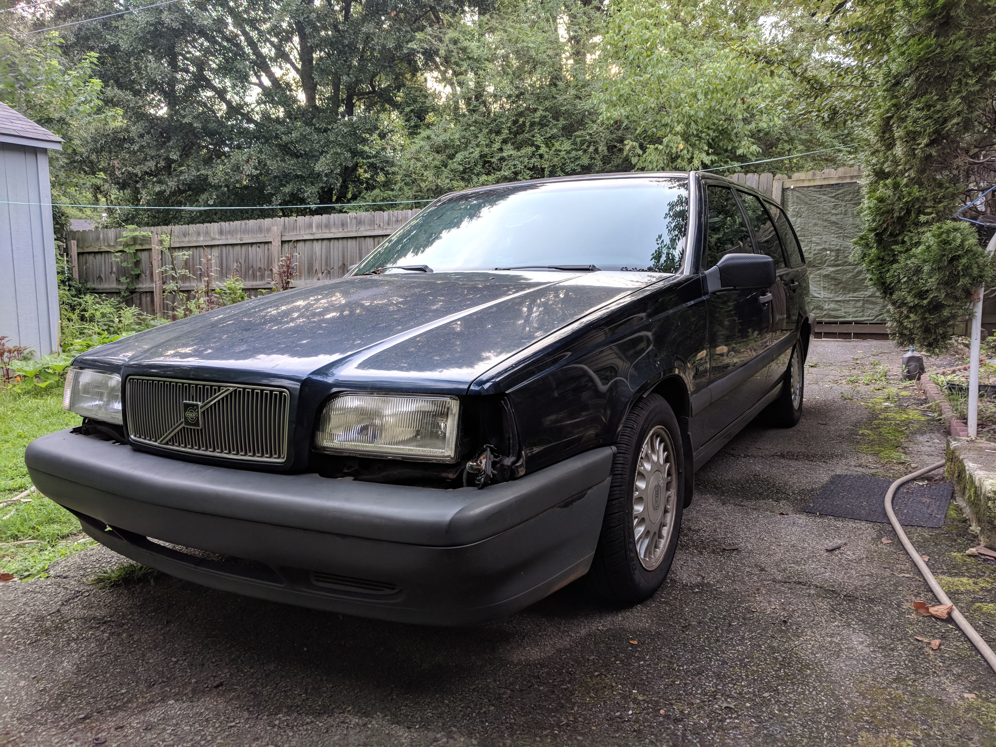

Hey guys, my name is Shihab, I'm 17 years old, and I own a '95 850 Wagon. Up until 2015, I can't say I know much about what happened to this car, so I'll talk from what I know.
1995 Volvo 850 Wagon (Base) (Still haven't given it a name, I'm coming up with one though...)
257k Miles
B5254S Engine- Auto only (thinking of a manual swap but not anytime soon)
Emissions: 3 = with EGR, without air pump, with OBDII, Monotronic 4.3L Fuel Injected with Rulo(...?)
Manufactured in Ghent, Belgium in March of '95.

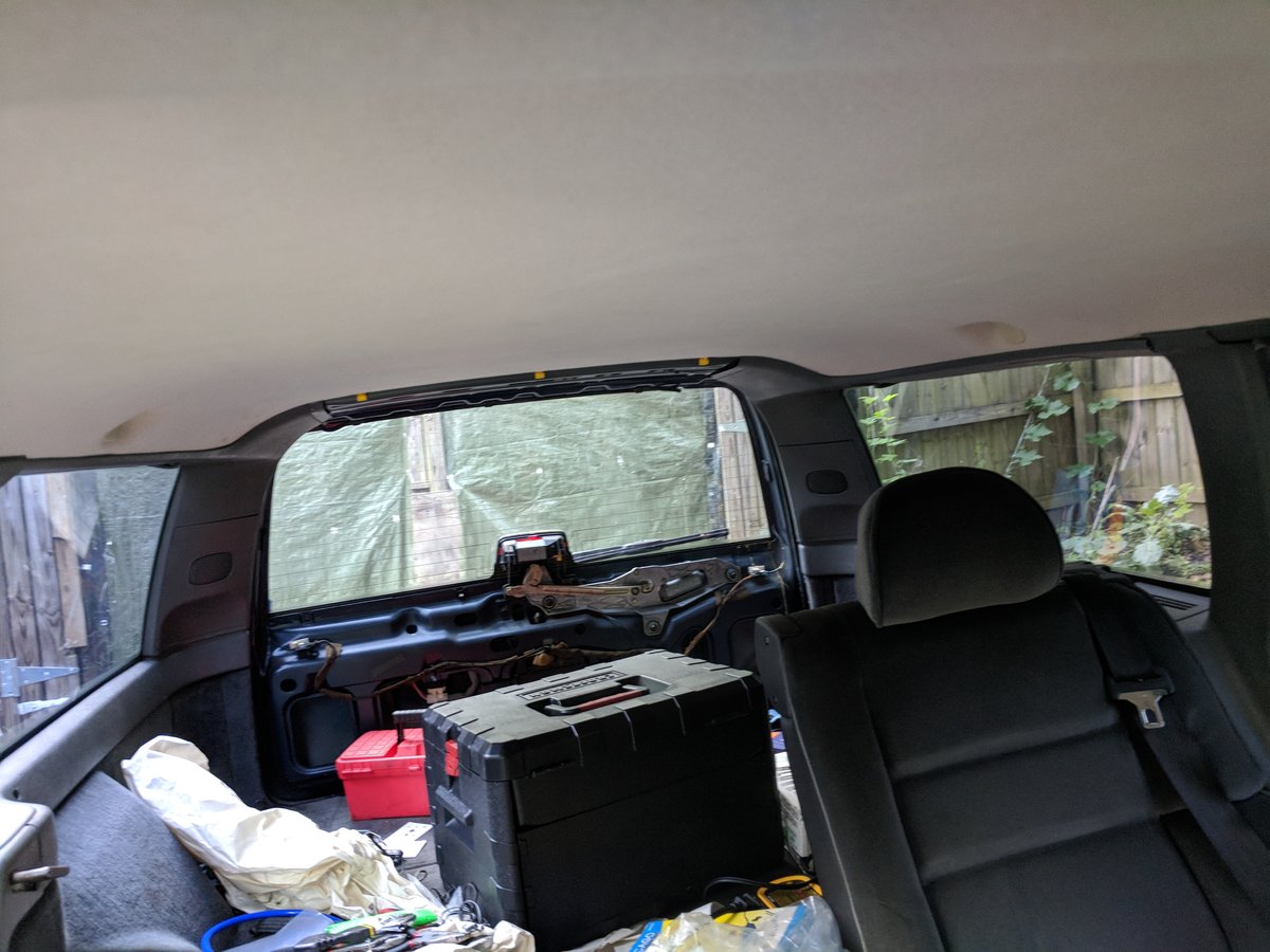

In 2015, my dad bought this car for a mere $700. He drove it for a few months, until the battery started dying on him, multiple times. He decided to sell it, but I made a deal with him, that if I could fix it, I would keep it, and somehow I got him to agree. I narrowed it down to a voltage regulator, and since then, the car hasn't let me down. The previous owners equipped it with an aftermarket security system which no longer works, so notice the aftermarket Alarm siren and the switch next to the steering wheel.
My father also claimed that the engine that's sitting in the car right now was swapped out only 70k miles ago. But since I have no documentation of any sorts of upgrades, I'm going to act as if it has the original engine in it. I'm going to act as if the car came from the factory the way it's sitting in the backyard.
My goal right now is to get the car to the point where it's running like how it was from the factory. Then, we can talk about actual upgrades. I've driven roughly 3k miles with this car, and I'm planning on keeping it for a very, very long time.

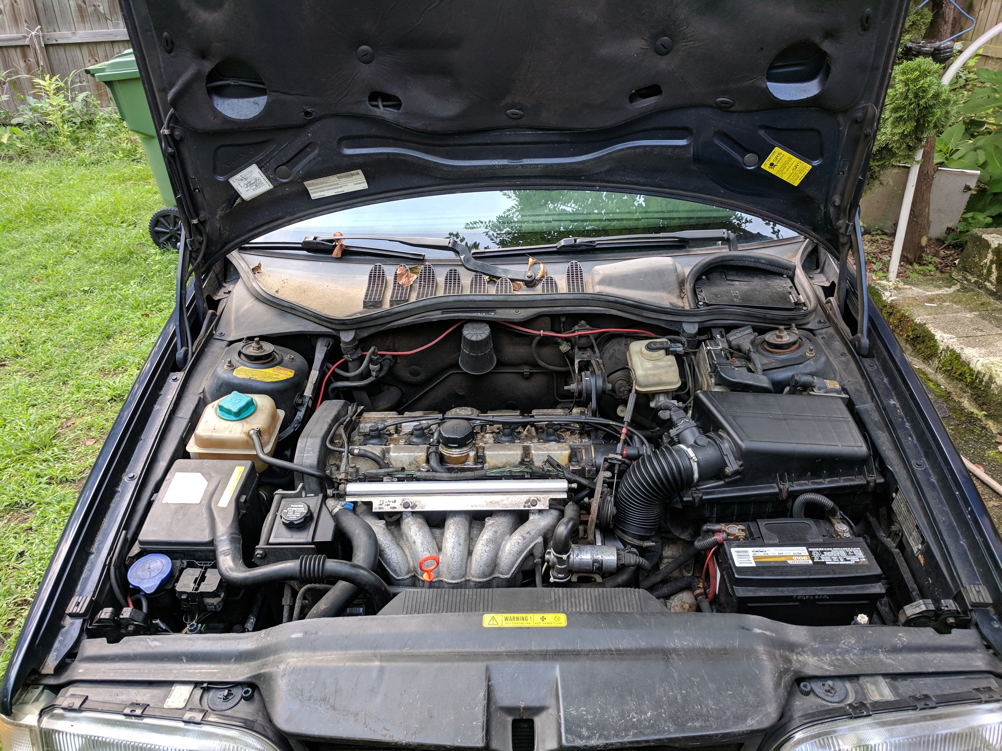

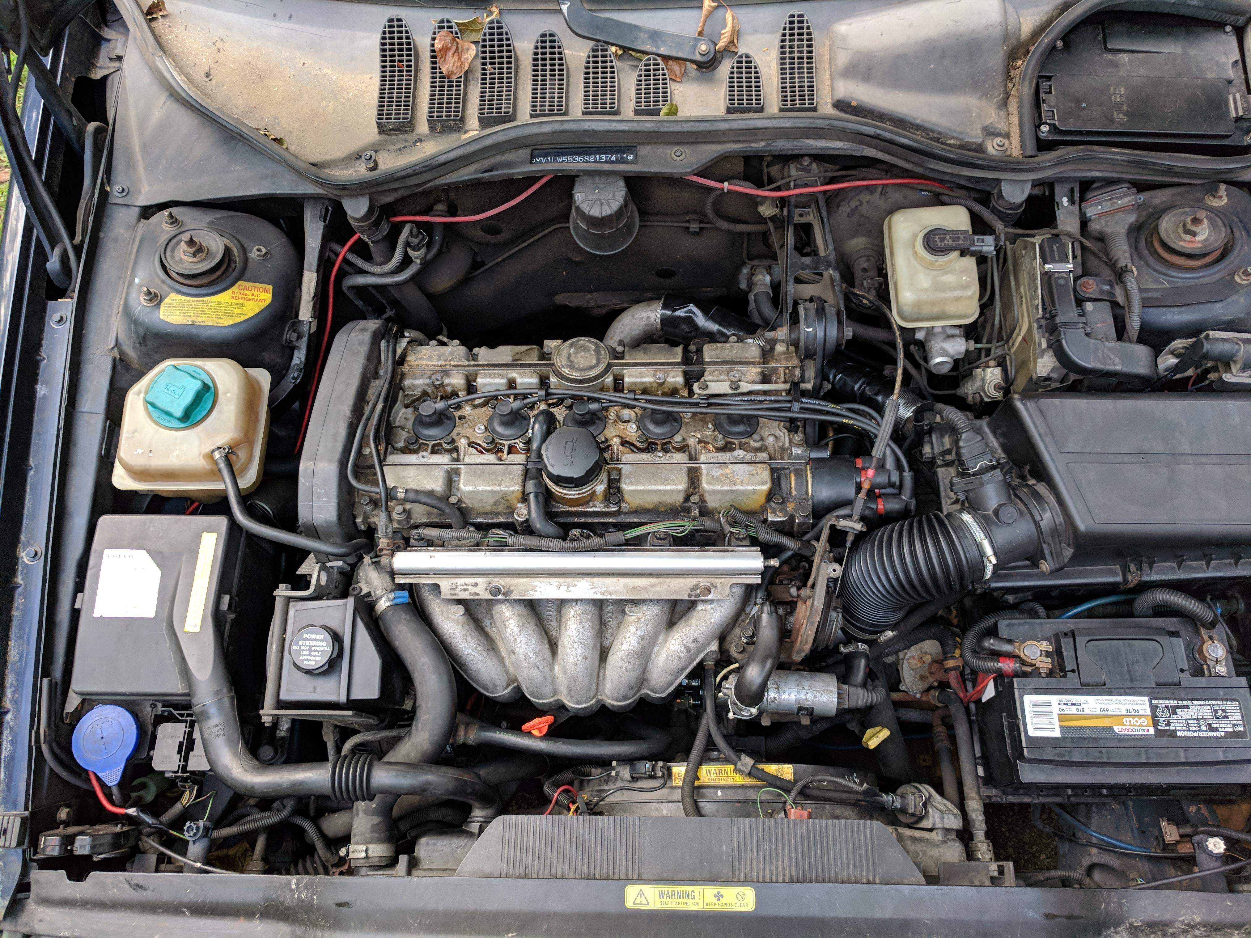

Clean the Idle Air control valve , that’s the small silver cylinder just to right ( car direction) of your battery. Check those hoses for leaks and splits.
There is a famous vacuum port on the far right side of the intake manifold that breaks on high mileage cars, too.

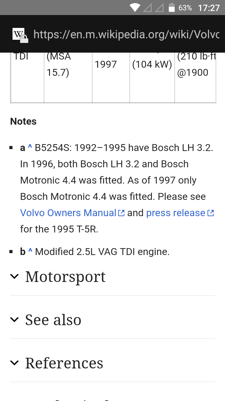

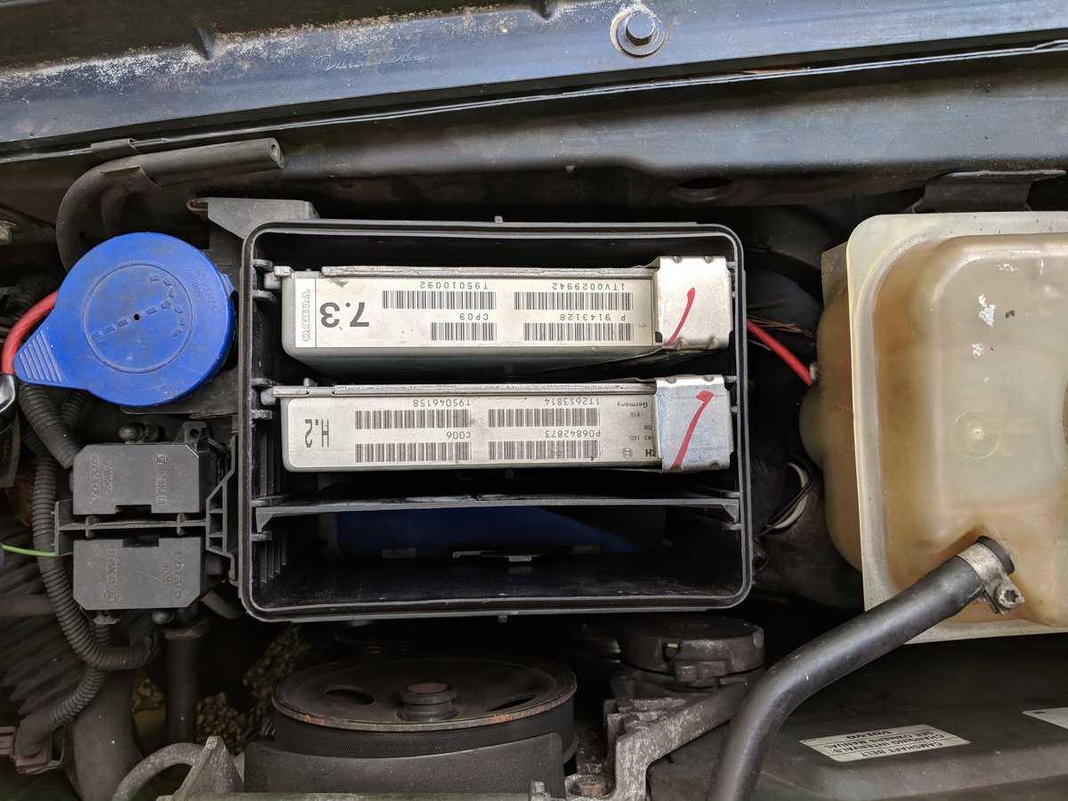

'95 non turbo can't be Motronic 4.3.
It can only be Jetronic,with two separate ecu(s)...one for management one for ignition...and being an auto...plus additional one for transmission....so 3 ecu(s) in the ecu box in total.

Motronic 4.3 is only for turbo models.
With diagnostic ports under the hood....it was LH Jetronic...what is now ....who knows....all i know is that other managements are NOT interchangeable.
When i look back the pictures from under the hood....you have a newer engine with newer style MAF....and it could be that Motronic 4.4 is installed along with an replacement engine.
Like i said....problem is that different managements are NOT interchangeable,wiring is different,pinouts are different....and since you still have OBDI ports under the hood...they are remained from Jetronic management.
I'm surprised and wonder how it starts and run...seriously.
Fluorescent oil dipstick also points that engine is from late '96 or '97.
'91-'96 had red dipsticks and crankcase capacity is different.
