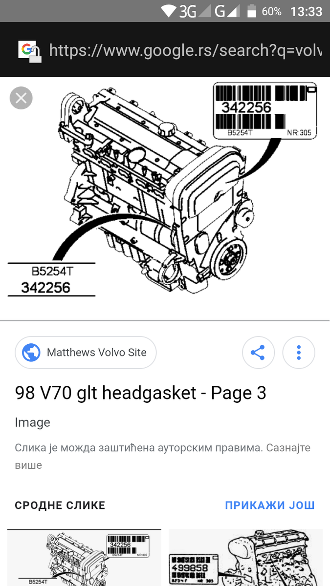

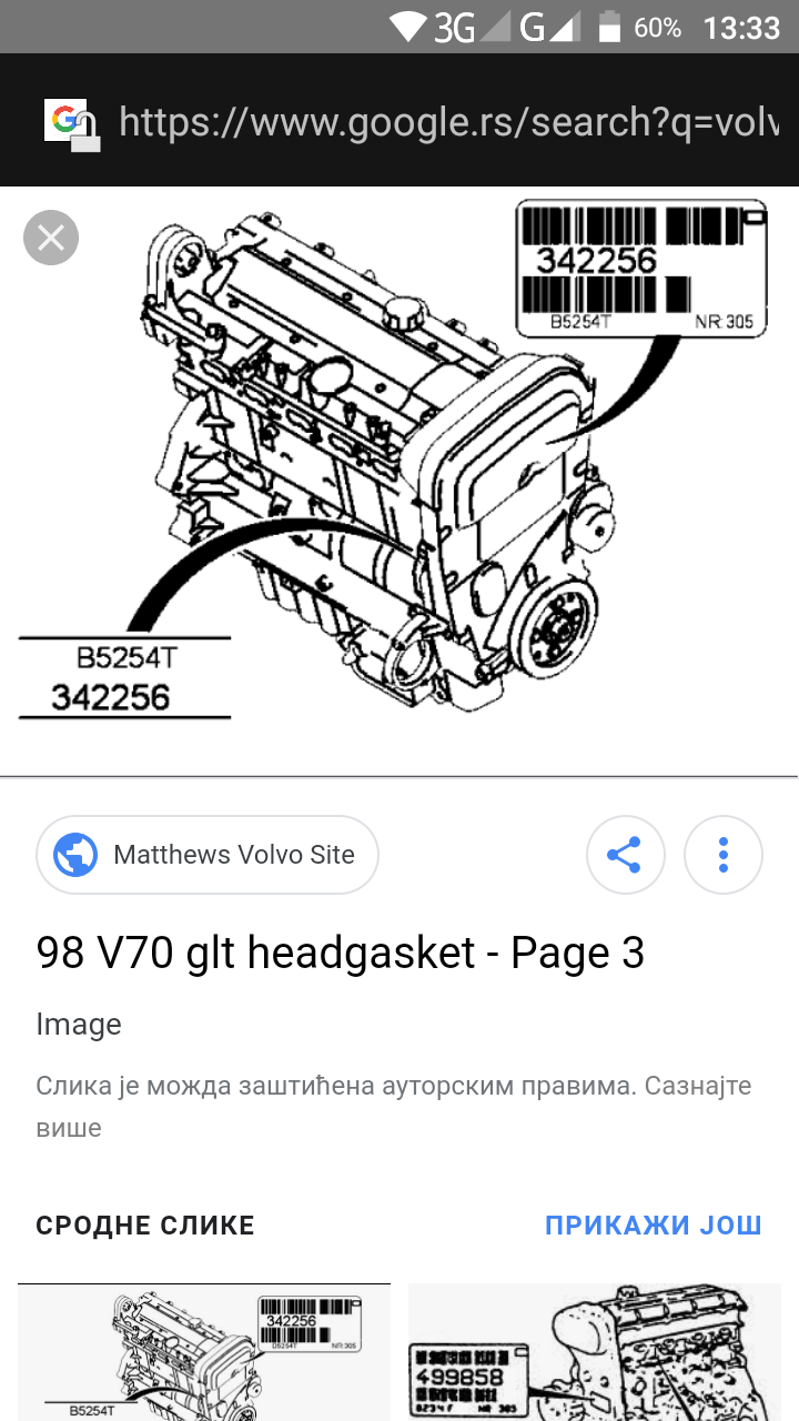

In the meantime, is there any way to check what kind of engine I have and if it is original or not?

It's NOT original.
There is engine mark and serial number back behind the timing belt cover on the block....the numbers are in little dots.
Also post a picture of timing belt cover original sticker(volvo sticker)...the same numbers are on it if it wasn't replaced.
