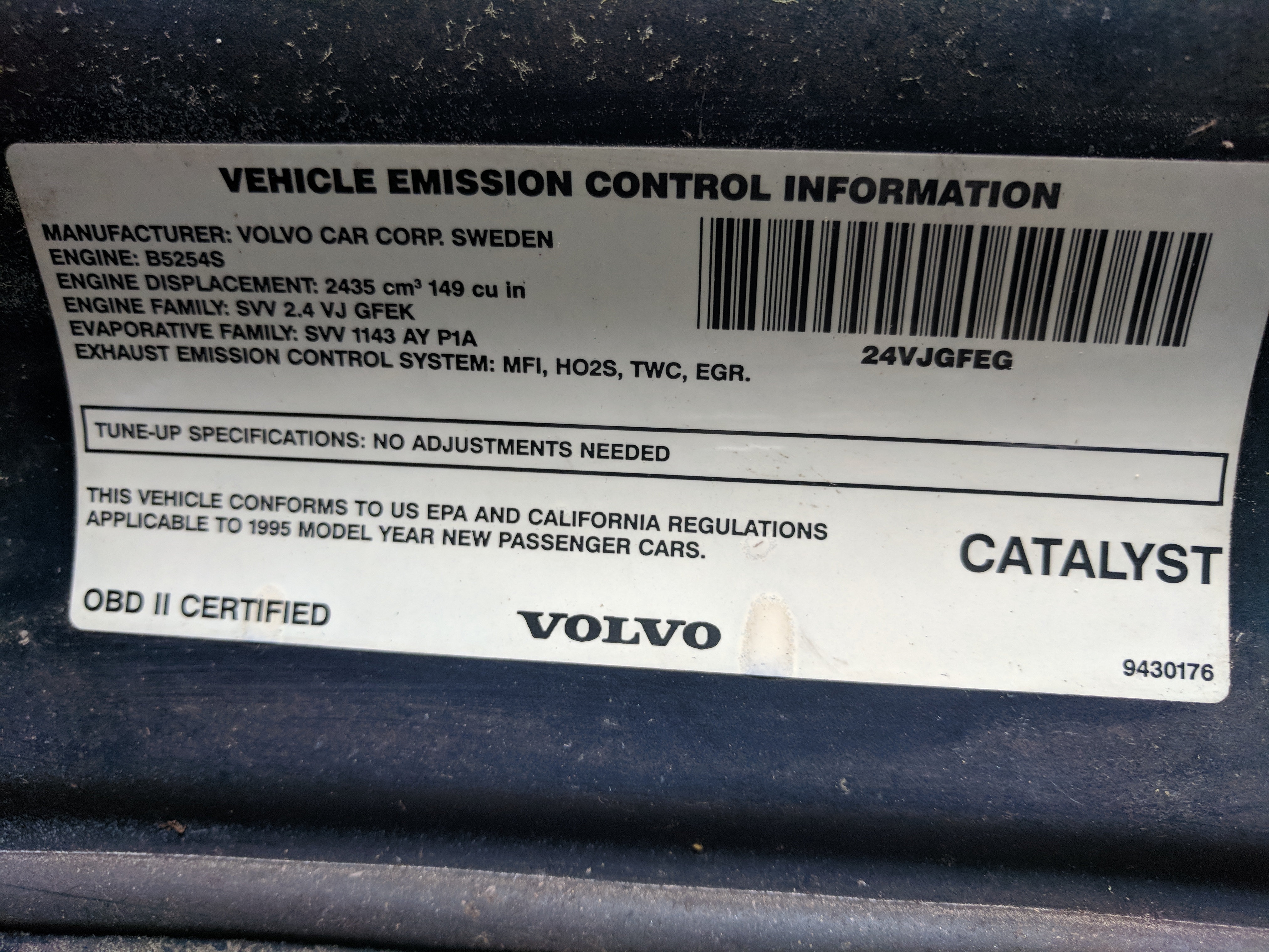

couldn't find the second place with the etched on numbers, but I did find this:
And this under the hood:
Also, Check Engine Light threw an "Engine Coolant Temperature Sensor 1 Circuit Low" -this is the thermostat, right?
Is now a good time to mention that when we pulled out a Camshaft Position Sensor (for my most recent job), we pulled one out of a non-turbo and it started smoking up. So we matched up the part numbers and noticed they weren't the same. So we went back to the junkyard to find one that matched our part, and lo and behold, it belonged to a turbo-ed engine. We were also confused, but hey, the numbers matched.

OBD II certified.

The B5254S are equipped with Bosch LH-3.2/EZ-129K engine management for model years 1995 and 1996.
1997 and on are equipped with Bosch Motronic 4.4 engine management.
