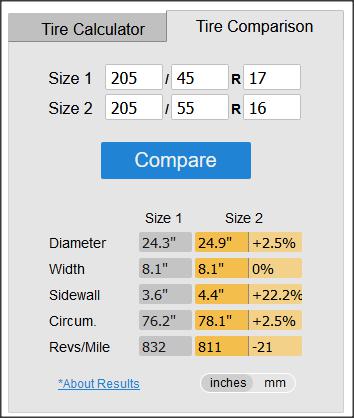

Actually as I continue to work on wrapping my brain around all of this, it looks like even if I did manage to get 15s on here, I would only gain 2/10ths of an inch of sidewall height:
However if I go with the 16s and put 205/55/16 tires, I increase my sidewall height by 1.2":
That sure doesn't seem like much, but I am hoping it might be enough to stop all these blowouts and bent rims?
btw.. great tool for understanding tire sizes: https://tiresize.com/calculator/
