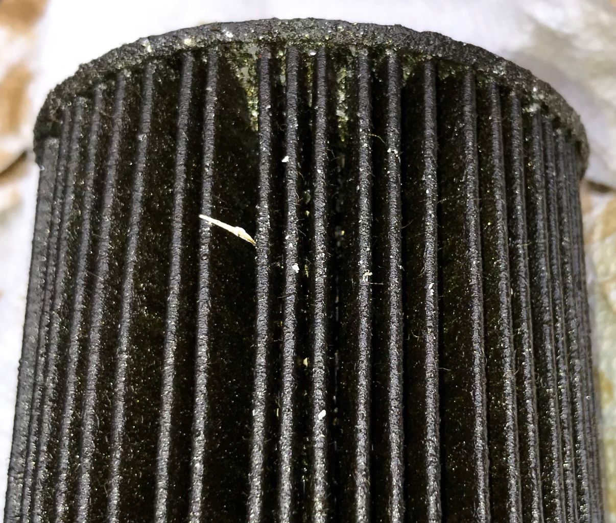

Compression decent in all cylinders. However, from yesterday's oil change... sad face...

I am seeing some metal fragments caught in the filter. If your pistons and cylinders are good (which I doubt) then most likely your bottom end crank bearings and/or rod bearings are history and the crank is scored. Could be a fried oil pump but doubtful. Top end could also be toast.
At this point the only way to tell is to dismantle the engine. I think some of this work can be done with the engine still in the car by pulling the oil pan, but in a worse case scenario the parts will exceed the price of a used engine. If you farm this work out you will be underwater pretty quick and most likely be told you need a new engine.
That said - there are many posts regarding engine swap options. Better yet start another post on the subject. Once you know what engines will work you can shop motor prices and then decide if you want to scrap the car or repair. I have seen motors for as low as $400 on Craigslist and I have a guy that will do a remove and replace for around $500 labor (fluids, gaskets ... are at my expense and desire). Not sure what the rate in Boston is, but if you can get a new solid used motor in the car for under $2k it would be worth keeping if the rest of the car is well sorted.

Yeah sounds like I may need one... no joy. Oil drained into pan looks like a gold miners dream. What metal is goldish in appearance - bearing race?
