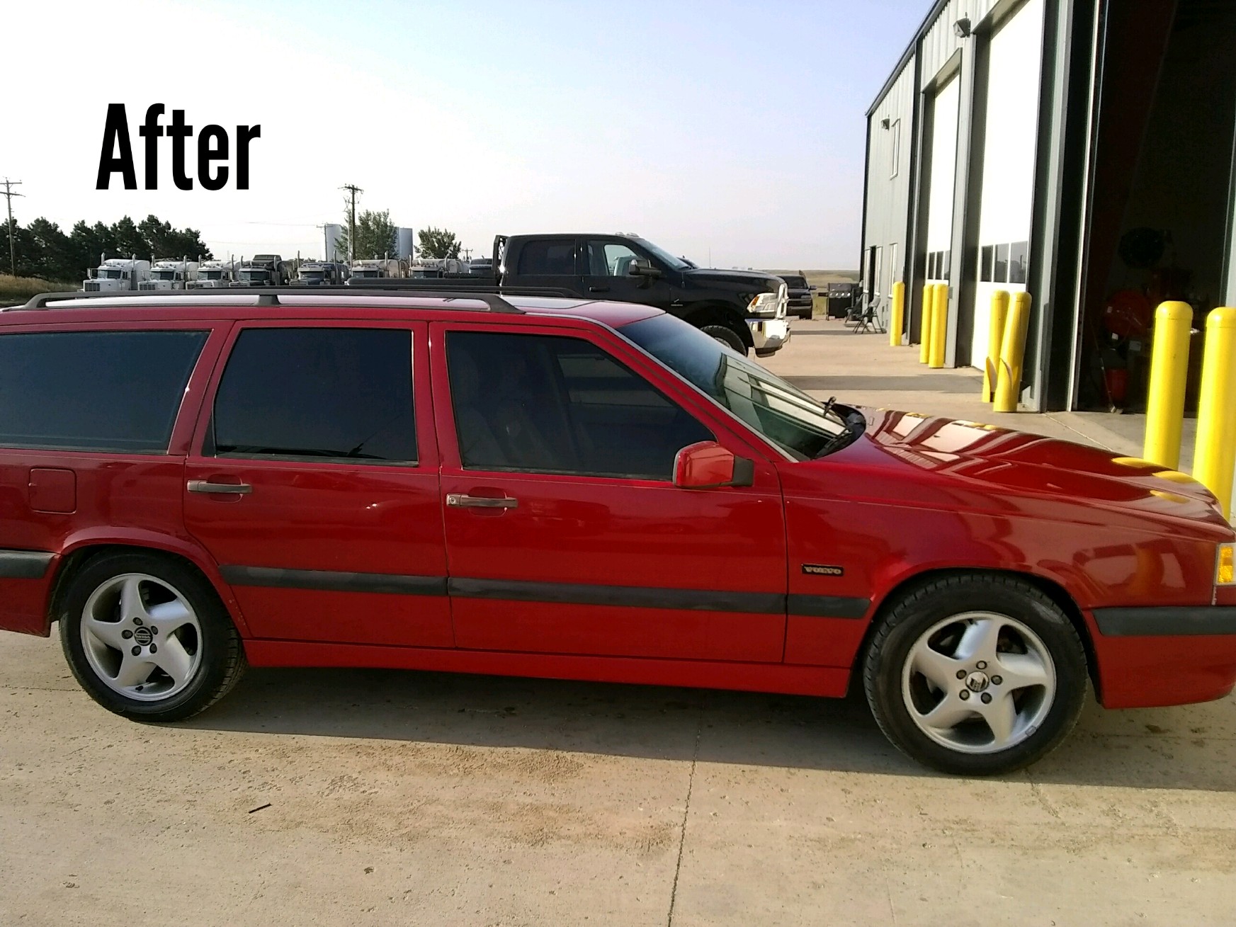

What a difference indeed

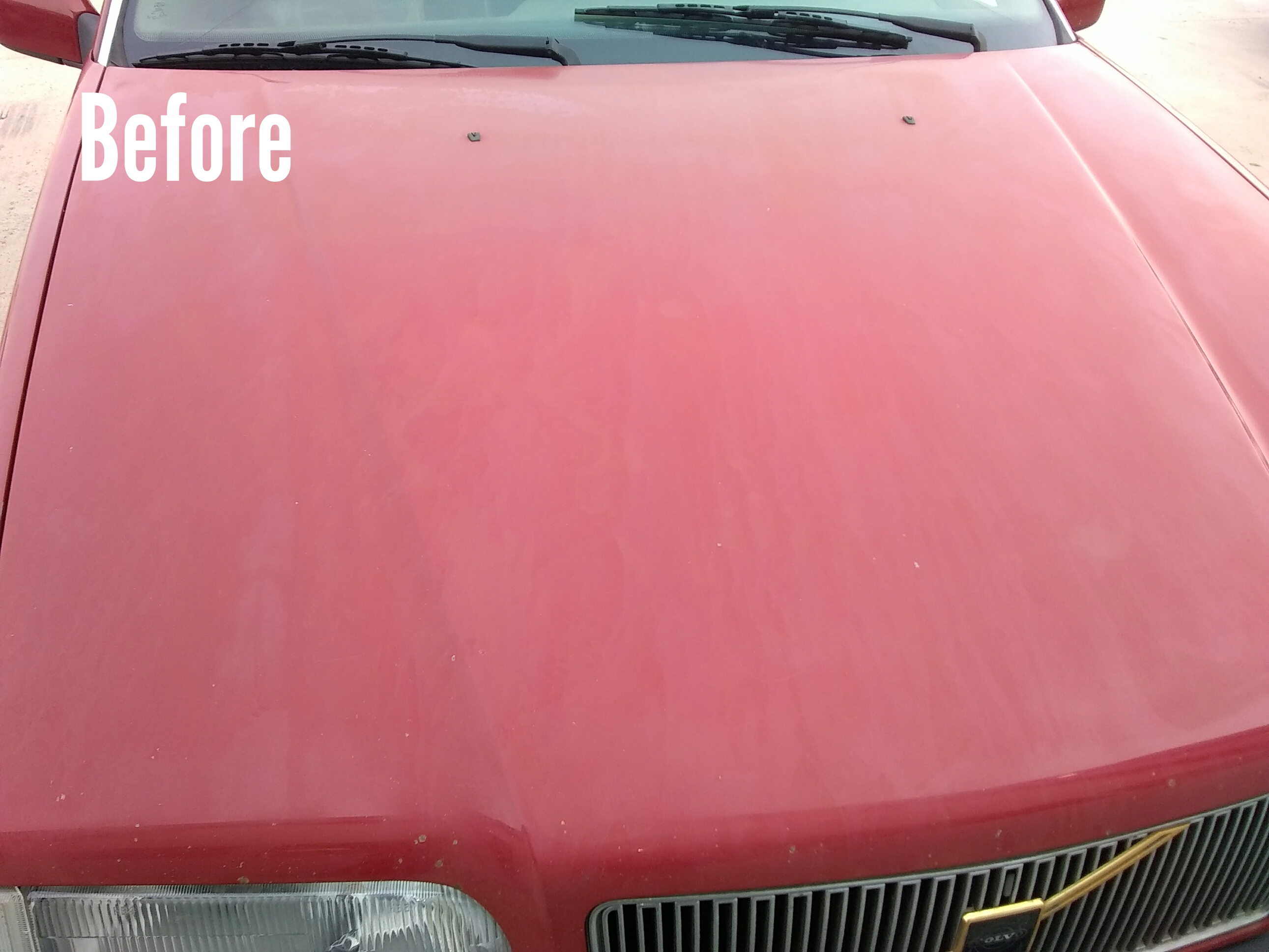

Turned out great! It's amazing how well the red cleans up. It seems all of them you see are faded horribly. All red Volvos are like that.

You should really stay on top of that paint! It looks so good polished. Cars are only factory once especially paint! June

I am surprised as to how well it turned out, the red is so deep and rich.bmdubya1198 wrote: ↑16 Aug 2018, 08:39 Turned out great! It's amazing how well the red cleans up. It seems all of them you see are faded horribly. All red Volvos are like that.
