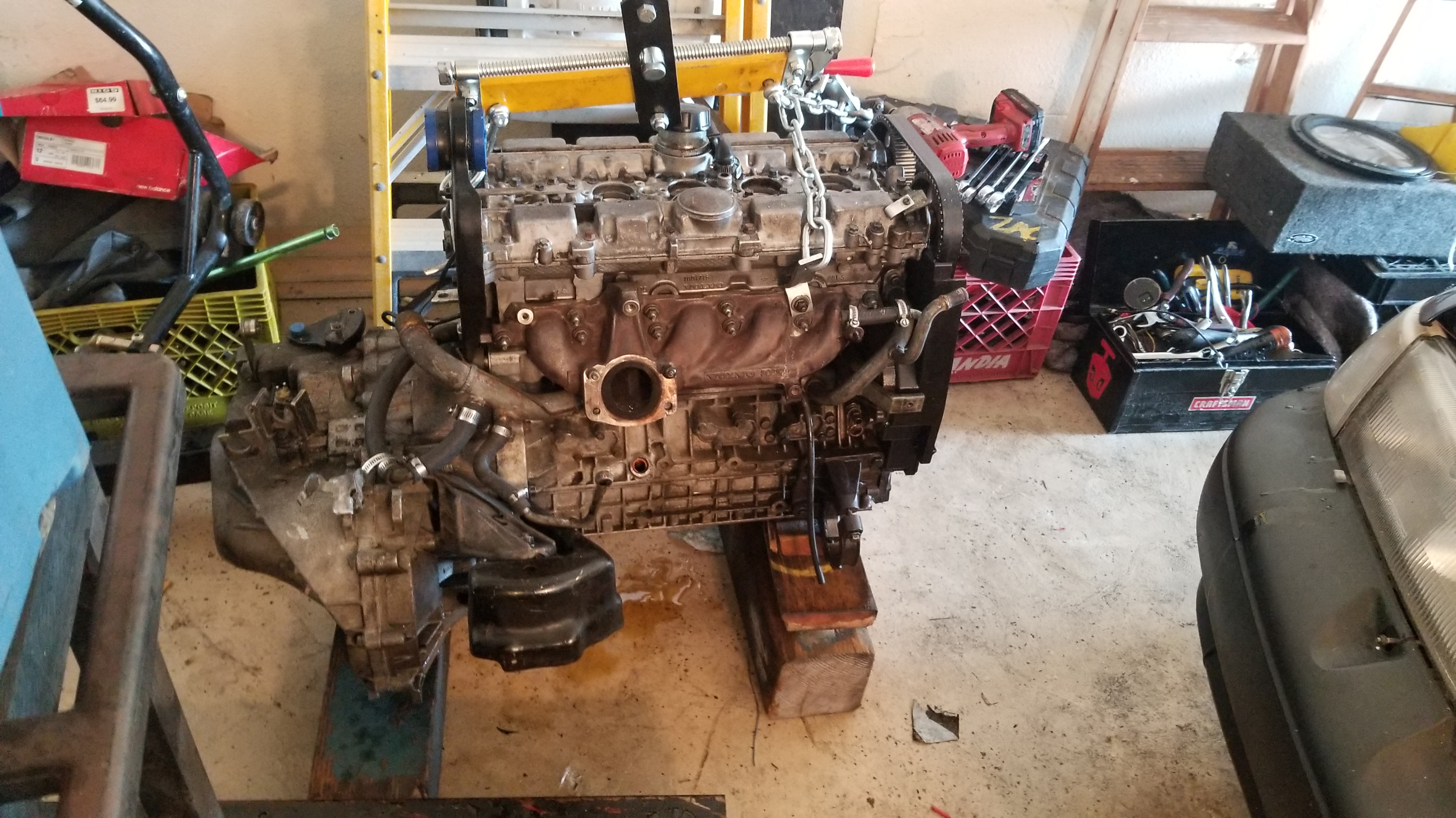

So got the pan off and did a visual inspection of bearing caps. I dont see any visable damage or anything out of the norm. I believe i read a post about actually poppong the caps off and looking under them for damage.. i guess i may as well since it isnt going to fix it self, no helper around today so its almost impossible to turn motor and watch up close at the same time. Think i will take a break until my daughter is home in the morning so i can have her rotate while i watch and listen, then depending on outcome maybe pop a cap or 5 caps to inspect.

Well the verdict is in 2 spun rod bearings and damaged crank journals. The sound was rod knock and not the gentle kind. . Motor 90% pulled already.
Sourced a motor locally and will be picking it up along with my new parts car tomorrow. This brings my yard count to 2 parts p80 cars plus my good one... so ill be the proud owner of 3 now..
Still a whole lot of wrenching to reach the finish line but it is finally on the horizon . Thanks for the suggestions and support!

Since you have the replacement on the ground, why not pull the pan and the rod caps on that one for a quick inspection of the bearing inserts and journals. Bag the caps with their inserts to keep wear parts together. If there's any discoloration of the bearing inserts that might not be the best motor to use.
With the pan off, you'll also see any buildup of deposits and will have a chance to clean the oil pickup screen and replace the o-rings, etc., the new ones in your bad motor should be fine to reuse. Also, in the light of day you'll be able to see any scoring in the lower cylinder walls. Then you'll know what you're starting with.

Good call. I will absolutely do that. I would be pretty bummed if i got it swapped out and tested, only to hsve a like event or failure once i begin to work into high boost . One nice aspect of it all is the replacement motor has 85k less miles on it. Just sucks loosing ao much known good state info from other motor.
