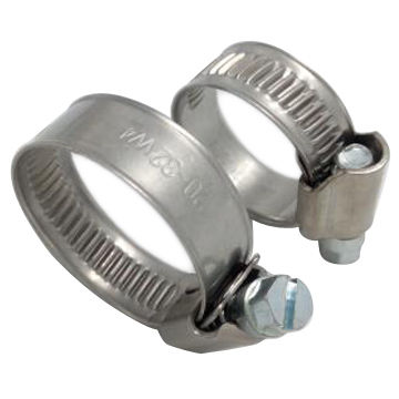

Durenol wrote: 21 Aug 2018, 13:15 As someone passing by this thread, what's the advantage of using these clamps vs the normal screw-tightening kind? These appear to be more expensive with no obvious benefit.
There's two types of screw (worm gear) clamps, the german ones are less prone to loosen with vibrations, while the hardware ones always loosen up. Imo, these may not stay tight enough, especially with temperature variation. Maybe the german one is safer but the problem here is playing with the rack - it's a bad and expensive job on this car.
the hardware store ones with straight holes
and the 'german' ones - what Volvo uses in the engine bay - with bent holes.

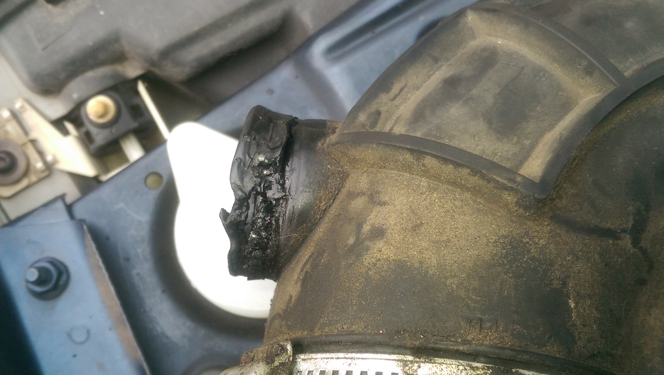

Another reason, screw clamp dug in and ripped it.

More accurate is probably that overtightening damages stuff. You can break pretty much anything using a screw on clamp if you tighten it enough.RickHaleParker wrote: 21 Aug 2018, 17:28 Another reason, screw clamp dug in and ripped it.IMAG0213.jpg
