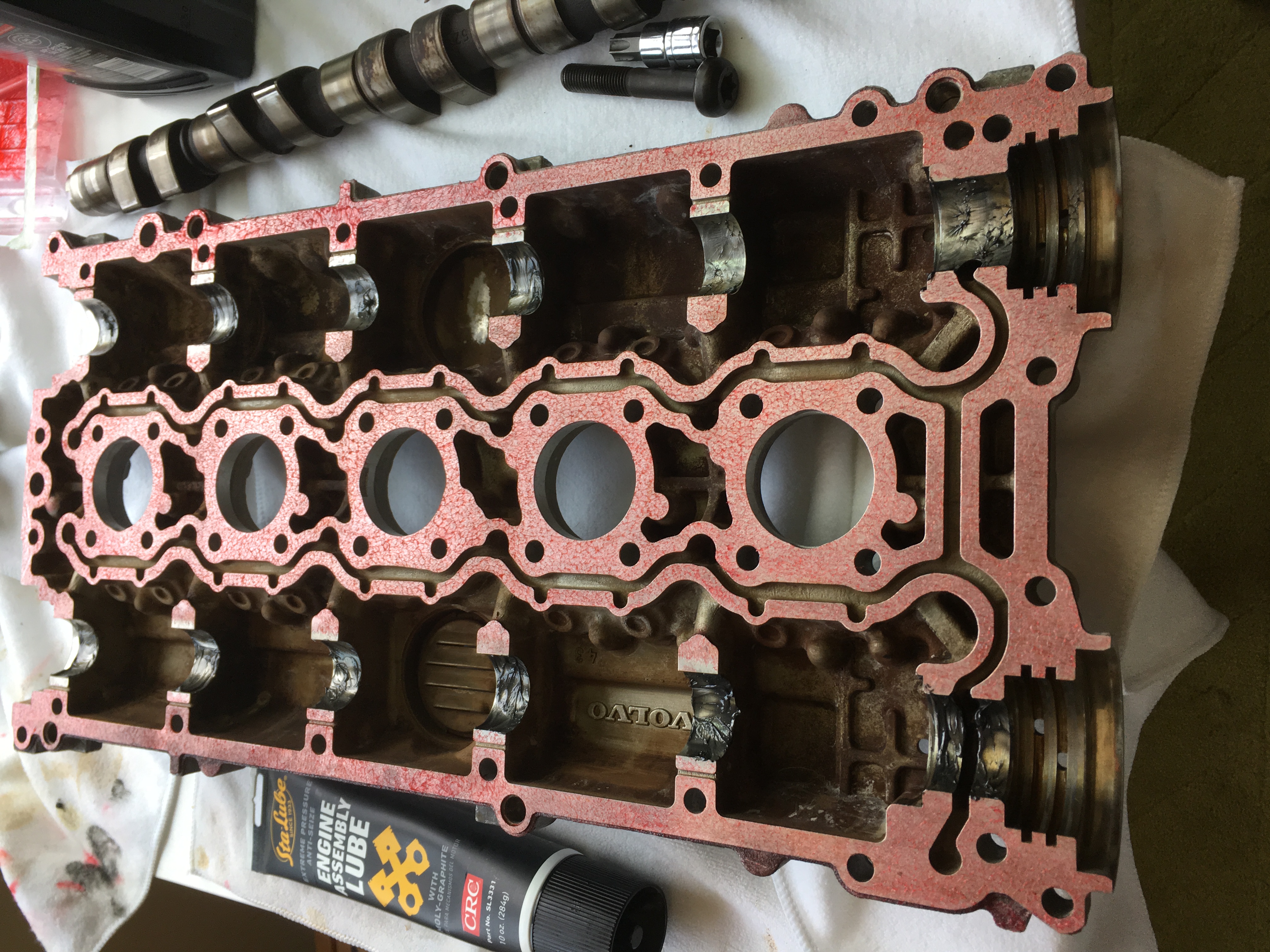

OK, I'm a dope and being too careful.
The VVT hubs have to come off anyway in order to replace the oil seals, so it's not necessary to install the hub on the cam before setting the top of the head. Besides, the sprocket wheel bolts get in the way when you're trying to align it on the dowels.
But finally some progress!
Some notes:
- The cam lock tool bolts are likely a hair too long and will bottom out in the hole before the tool is snugged down. This is what caused my mistake in the first place - trying to crank it down snug and I snapped the bolt. So I stacked some washers under the bolt head - a 1/4" or more - and snugged it down with one hand on the ratchet. Plenty tight, the teeth are engaged with the cam. The big cam bolt came off easily with a T55, 1/2 to 3/8 adapter, and a normal breaker bar.
- The anaerobic stuff is very sticky. Hard to get it spread evenly on your roller. You don't want globs on the upper head. Even with a very thin film, there is some squeeze out - this is a very precise fit between halves. I used most of a tube.
- Be careful of the wire you use to "hang" the cams from the upper head when upside down. The only big mistake I made (other than sticking my thumb into the sealant) was getting that wire (mine was almost coat hanger thick) pinched on the oil seal flange of the intake cam. I had started to snug all the bolts down and realized the wire wasn't coming out. Had to back off all the bolts, pry it up a couple of mm, then pull the wire out. No damage done, just time.
My surgical "clean room." All good until the cat jumped in the window and almost walked across it.
The cam lock tool has a little flange in the center that swings - hook it over the top of the cam cover to hang the tails of the cams from the cover. You DON'T want to put any leverage on those aluminum "fins" in the cover at the sprocket end.
Be careful of the wire. I would use something lighter than this. The bolts will keep falling out until you get it flipped over. Don't touch the red goop!
Clean, new o-rings, assembly lube at bearing surfaces. I shop vac'd all my grit out of the lifter cup recesses, removed and cleaned all the cups, liberally oiled them, and slid them back in. ONE AT A TIME - PUT THEM IN THE SAME HOLES.
I rented the pull-down tool from my friend the VW-Audi mechanic. Goes much faster. Be careful of your spark plug threads however.
Stack some washers to prevent bottoming these little bolts and over-torquing them.
My homemade timing scratch marks in lieu of paint.
Some notes:
