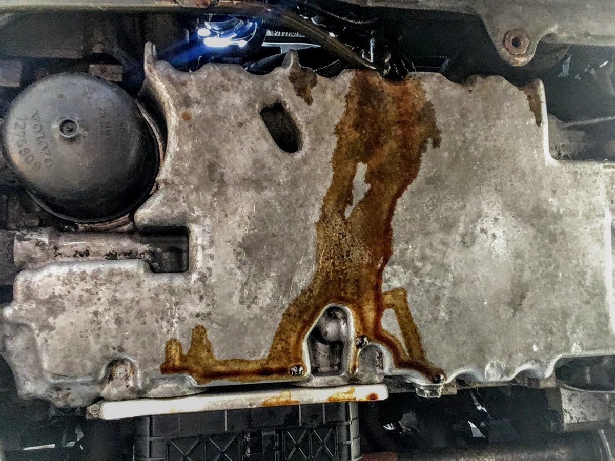

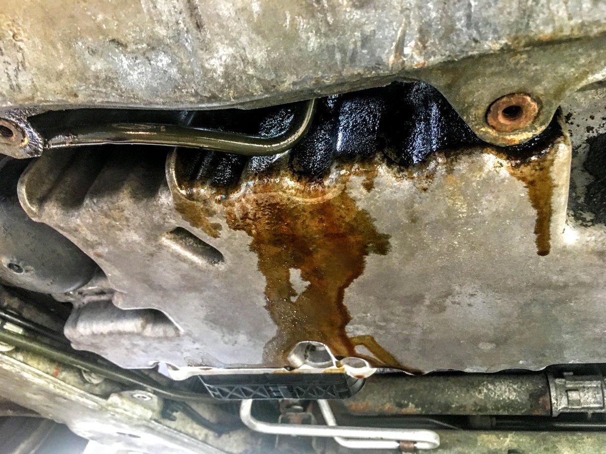

I noticed oil was starting to pool up on the driveway again, and the entire bottom of the oil pan was coated with oil. I cleaned up the oil pan and then started the engine and let it idle in the driveway for about half an hour. No signs of oil. Then I took it out for a 10 minute drive with a couple of turbo boosts. Pulled back in to the driveway onto the ramps and found this:
Slightly different angle where you can see up the side of the oil pan a bit:
I can't see the exact point of origin of the leak, because I believe the actual leak condition only occurs during the drive. However, I can definitely see excess oil coming down the intake side of the oil pan and then flowing across the bottom and dripping from the exhaust side of the oil pan under the oil cooler and drain plug. There's a lot of crud built up on the intake side of the oil pan which you can see from the second picture above.

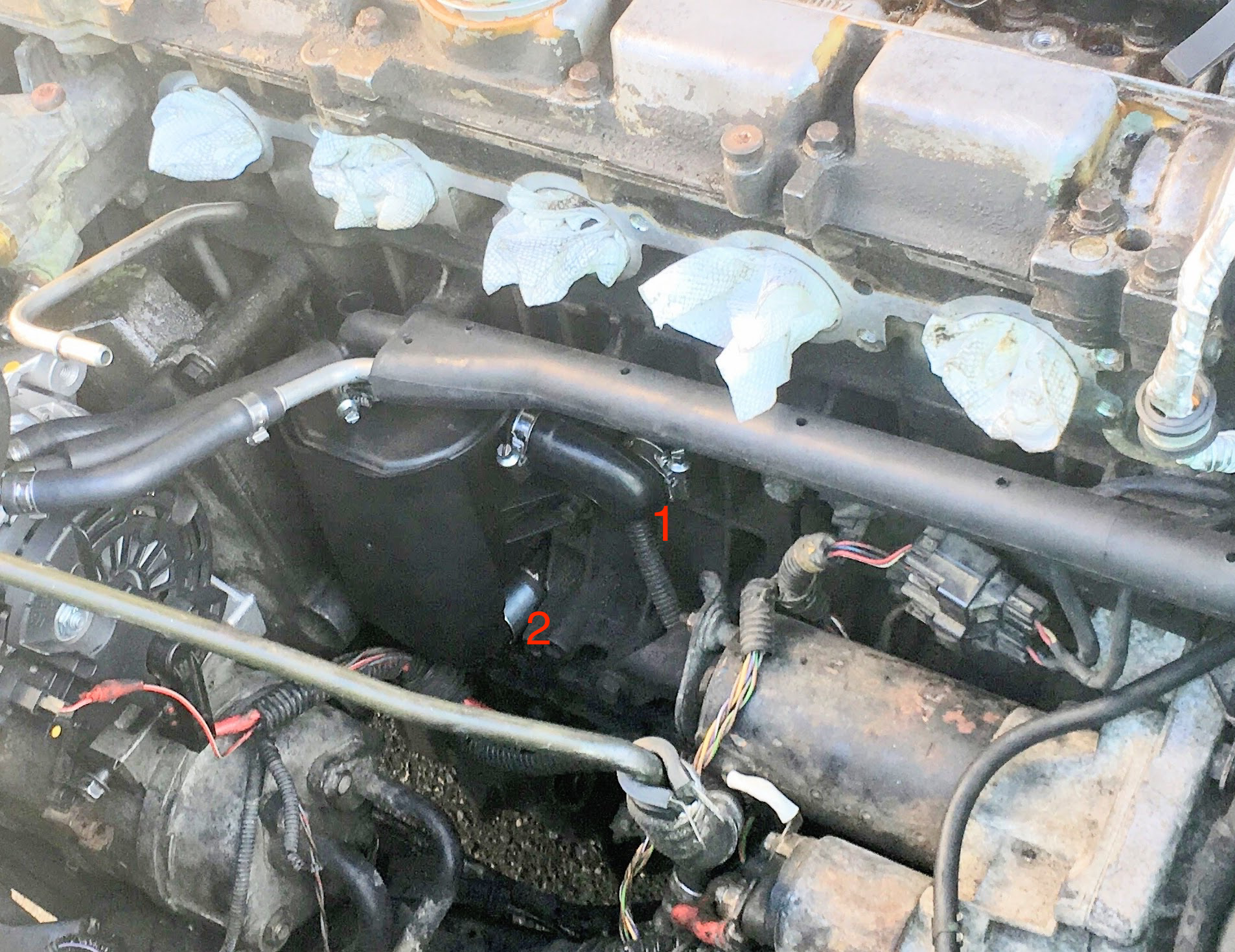

It seems that #1 in this photo is directly over where the leak emerges at the front edge of the oil pan. Both are right in the center. It could also be #2, but that one is more off to the side.
Compare this:
To this:

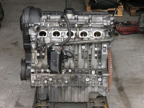

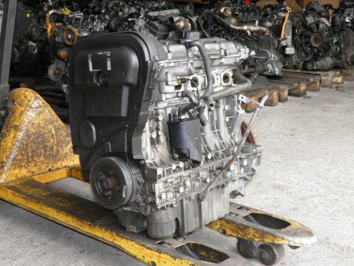

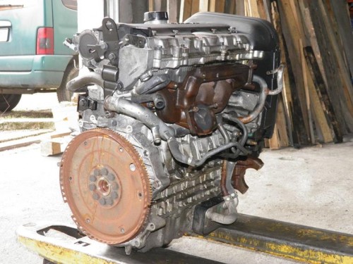

This page has photos of a B5244T3 engine stripped down:
https://ergmoto.pl/pl/p/SILNIK-B5244T3- ... -XC70/1700
I pulled them off for posterity here. The images are kind of small but we might get some detail by zooming in:

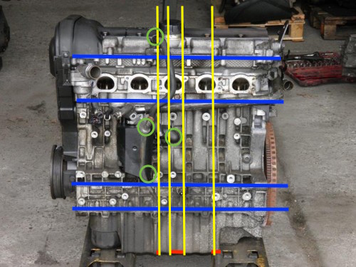

I marked up the front photo into a diagram:
- Red lines for the areas where oil was spotted hitting the bottom of the oil pan
- Blue lines to show mating surfaces between the oil pan, bottom and top engine block, cylinder head, and cam cover
- Green circles to show PCV system connecting points
- Yellow lines to trace upwards from where oil leaks emerged. The middle two indicate the boundaries of the wider leak in the middle.

Another question to consider is whether each leak spot on the oil pan corresponds to a separate leak that traveled straight down, or if a single leak could have spread out and caused all of the leak spots.
