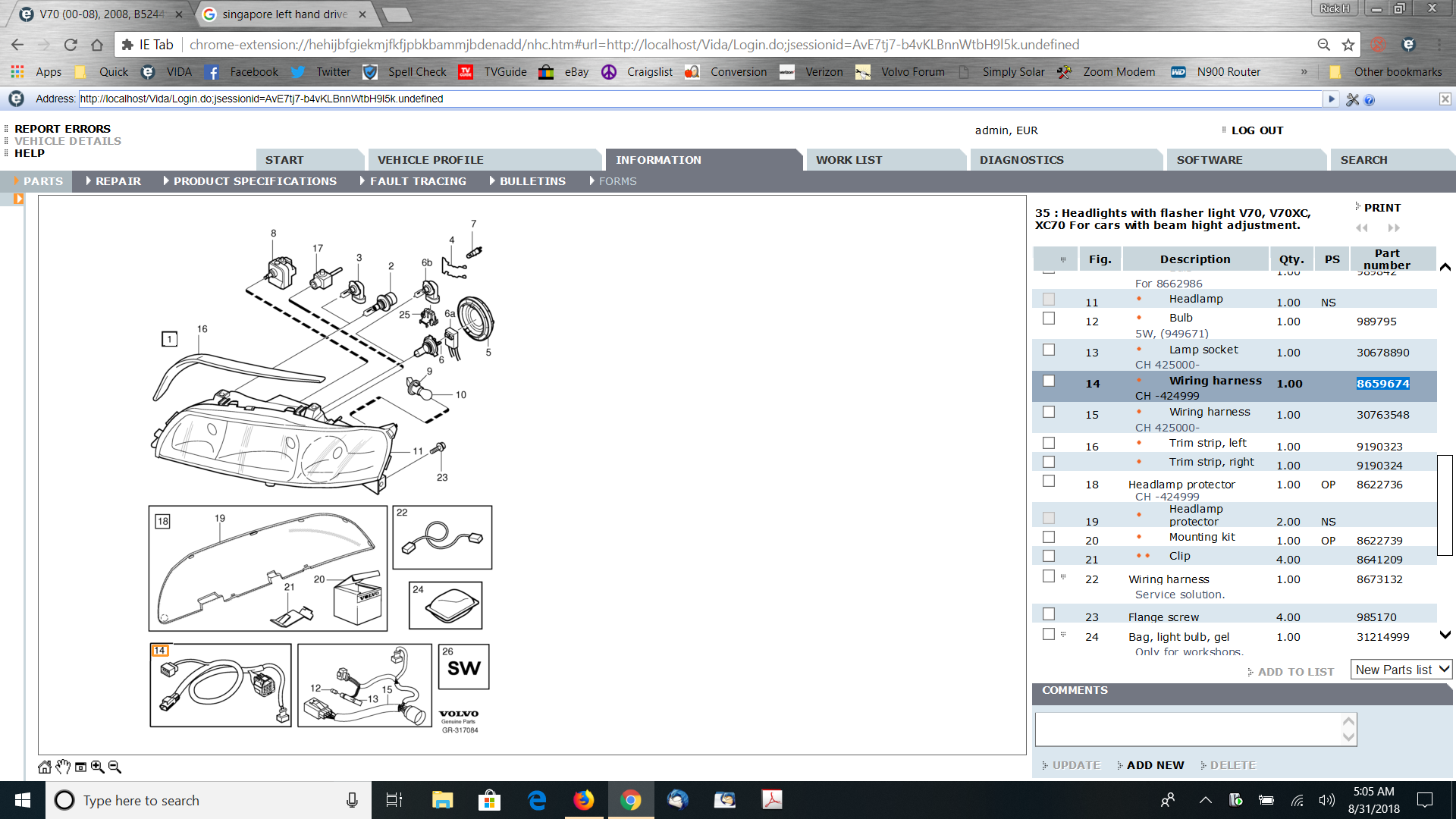

You can buy them. First you need to figure out which one.
With or Without beam hight adjustment?
Is your chassis number lower or higher then 425000? (last six digits of VIN number)

For Right Hand drive car ... Volvo part number 8659674.

If that is not your harness, you must have a 2008.5 V70. Halogen Headlights?
