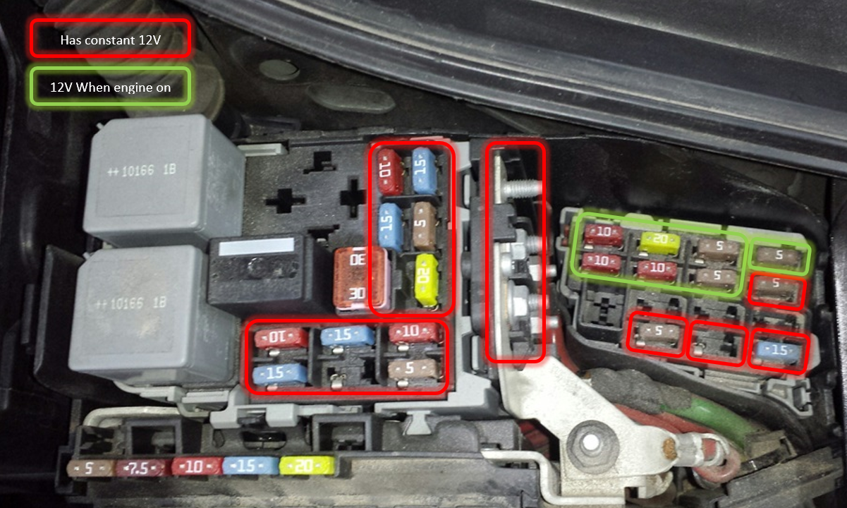

Using a DMM, and once the car has settled down, I measure current draw at the following fuse locations in the engine compartment: F35 0.07A, F36 0.01A, F37 0.40A, F38 0.10A, F39 0.03A (this draw remains for hours so I expect it is constant indefinitely).
Those measurements were taken one fuse at a time (replacing the fuse each time). When all are installed, there is a total draw of about 0.53A which, of course, is a little less than the aggregate of the individual measurements.
I downloaded the wiring diagram PDF and found that every one of these fuses is connected to the socket for pin 87 of relay 10 (R10). This is where it gets funky (at least in my mind) and I could use some help from the group. When I remove R10, there is still current at each of the fuses I mentioned earlier. I guess I don’t see the point of having a relay if there’s power on the switched circuit regardless of whether there’s a relay installed or not. I can only assume there’s a short somewhere. I bought a VIDA Vadis SERVICE REPAIR MANUAL off of eBay recently which seemed like it would be helpful in showing me how to disassemble the fuse box, but the instructions were actually very limited; there are way more clips to disconnect than what is shown. Anyway, I tried but gave up after fighting with the fuse box, I’m guessing the tension of the wires inside the box are creating enough resistance to frustrate my being able to completely take it all apart.
Would anyone be willing to confirm somethings on their car? I’d like to know if you get an approximate 12V measurement at socket 87 of R10 (this is the one most closest to the left side of the car).
Just pull the relay out and measure between ground and the socket. I measure ~12V at sockets 30, 86, and 87 of R10.
If you want, you can verify if your fuses are hot with the car off as indicated in the following photo.
And last, but not least, has anyone else dealt with this issue? Any suggestions?

On my 2010 XC60 the fuses in front of the underhood box that you highlighted are not hot all the time. The back three 36,37,38, 39, 40 (not used), 41, and 35 just behind those are fed through the fuel system relay, 2/32 (AKA R10) in the back left corner of that box (back right from driver's seat perspective). You might find them powered if the leak detection pump is being run but that would be 30 min or more after shut down. They will stay powered up for 4-8 min after engine was run until ECM goes "to sleep".
