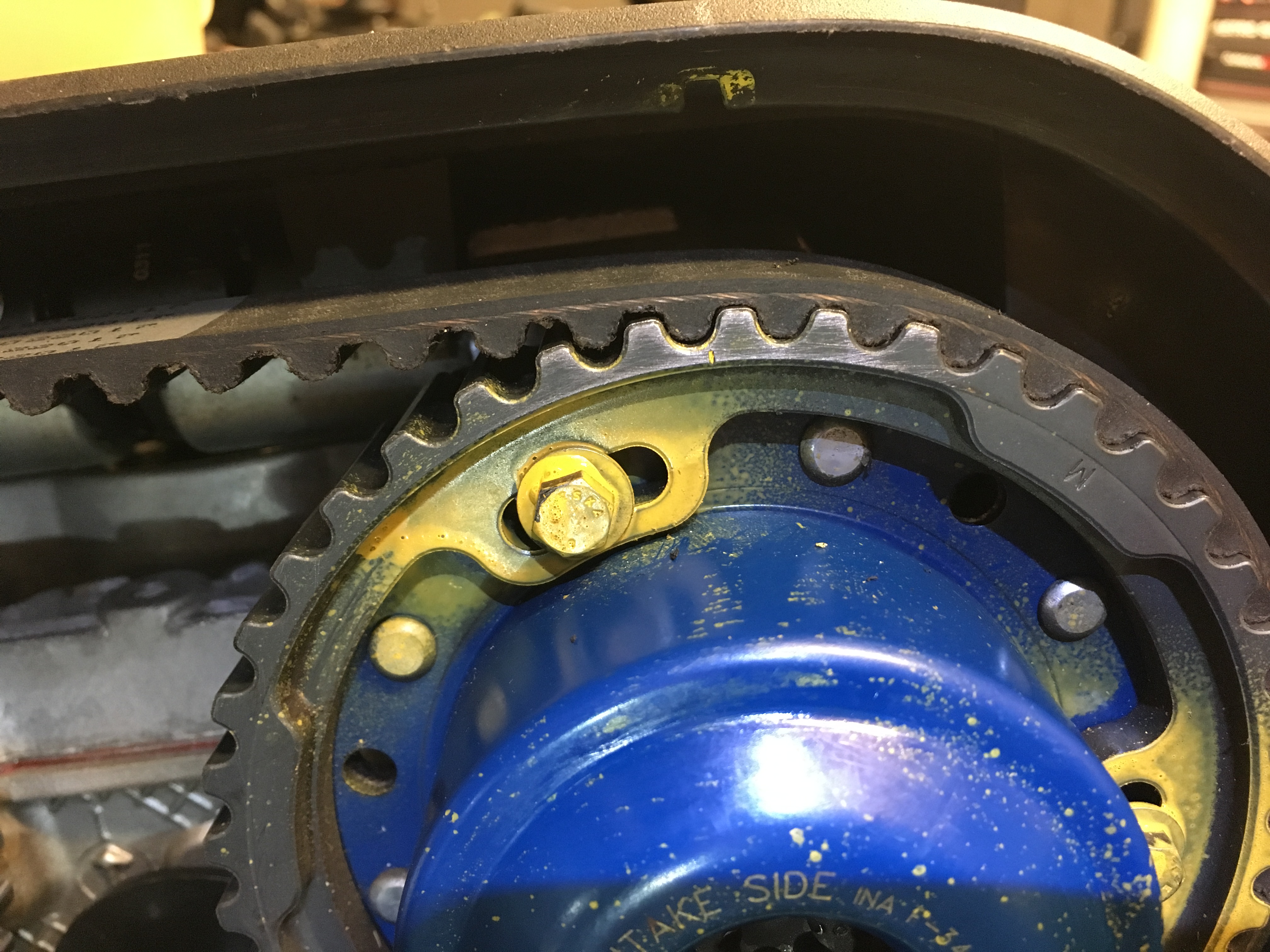

SO....I started over from scratch with the VVT cam set up. Very concerned that I had turned the engine over by hand with the timing off and not sure how much force it takes to bend a valve. Why even put it together if you've wrecked the head?! Because you have to.
On the crank timing mark, double checked with mirrors and fingers. Cams locked again. Both cam wheels tight to their clockwise stop, then align (always clockwise!) with your upper cover timing marks (maybe fudge a hair short if you think they'll move when you crank down the bolts - mine didn't move at all). Then crank the bolts down to 88 without the pulleys moving (are these bolts stretching and should be replaced?). Check all your marks again. Carefully put the belt on, keeping the crank-to-intake-wheel taut, keeping the cam wheels on their marks, keeping the cam-to-cam relationship straight, then working around your tensioner etc and set up the tensioner correctly. Roll it over by hand twice and check marks. Once you're sure you've got it right, then pull the cam lock, replace the rear seals, and go about reassembling everything.

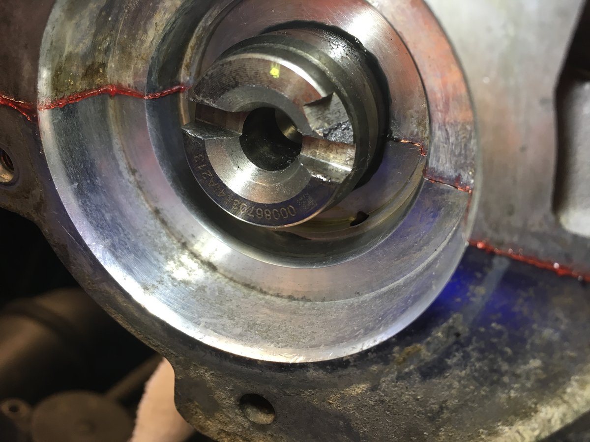

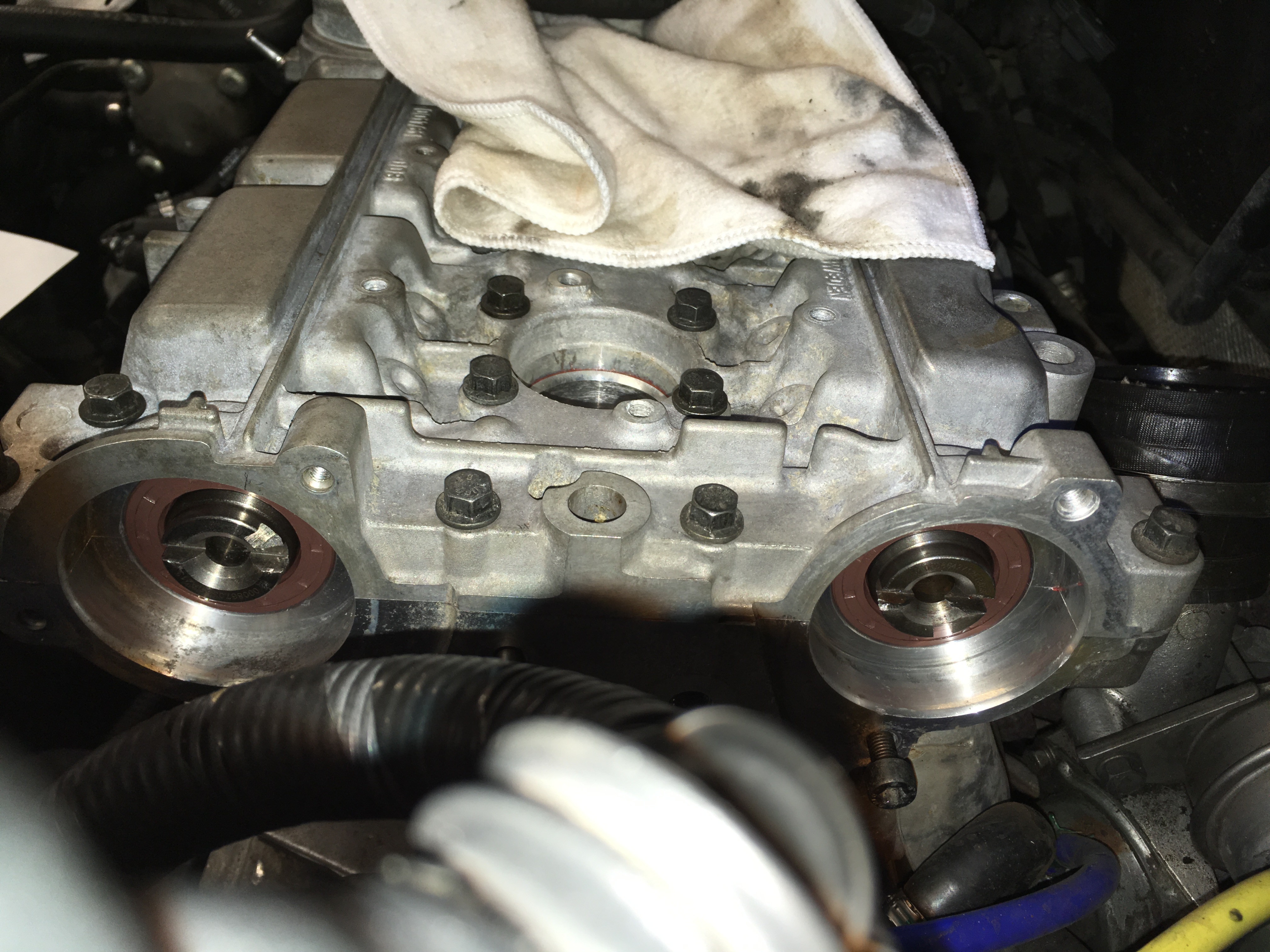

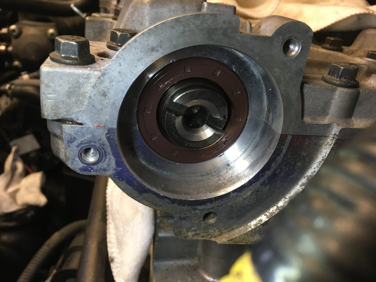

This much off first attempt. Enuf to bend a valve? I thought so at the time.
Chipped intake slot - careful with that lock tool. Clean out the red anaerobic goop - this is where your cam seal goes.

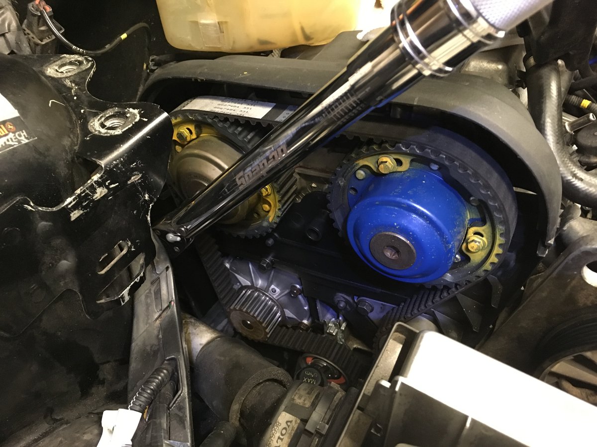

All back together - this is as close as I could make these. (paint was from me assuming I had to move the sprockets)
88 ft-lbs, nothing moved.

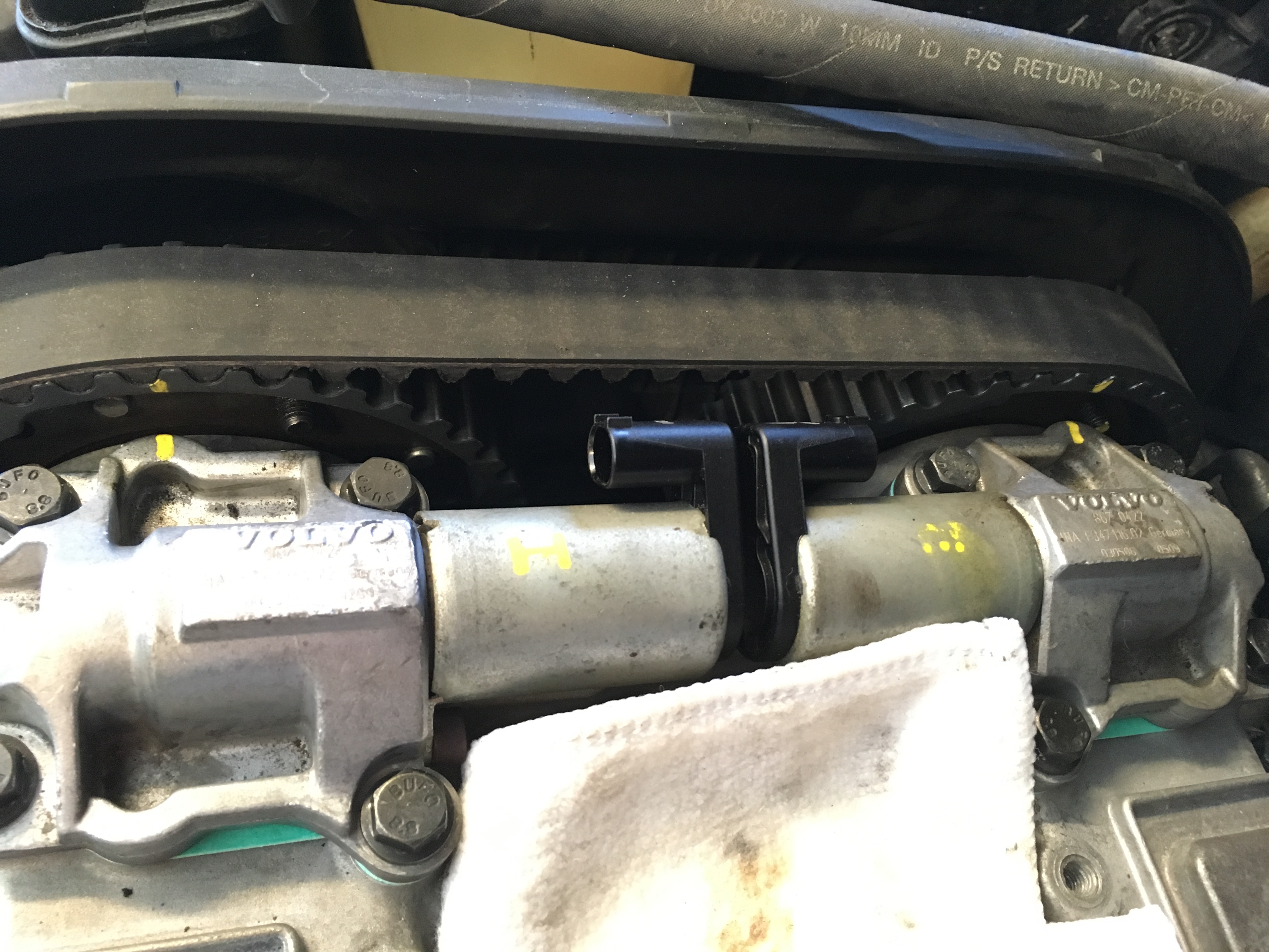

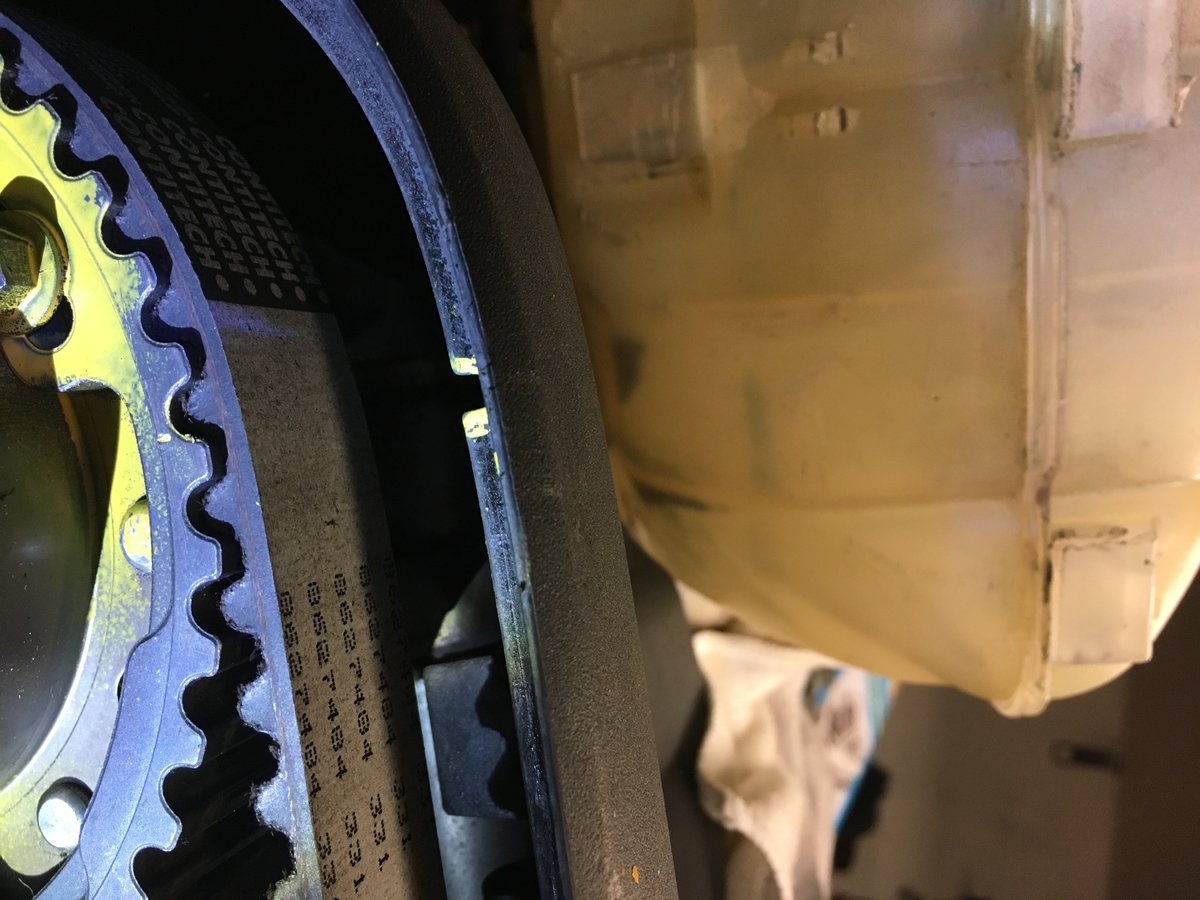

Cam slots nice and horizontal..
Old marks line up!

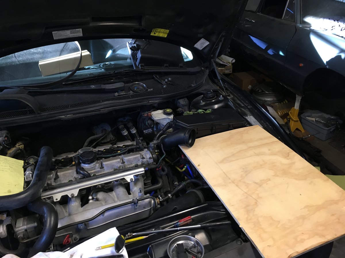

I have to keep myself organized. And if I don't know what to do next, I just clean. This engines was a mess.
My work platform to get to the turbo and back of the engine. Sits on rad support and empty air box.

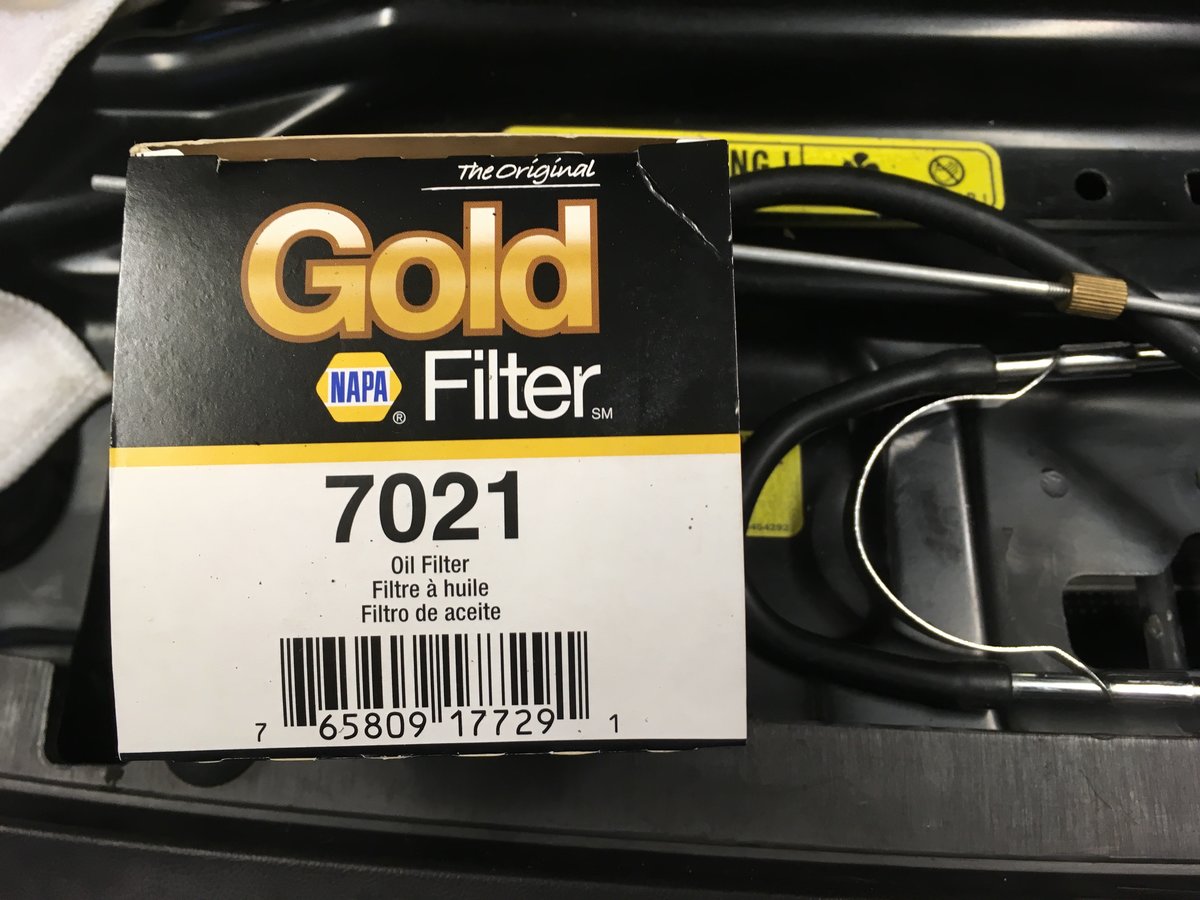

It won't be in there for long, but I've had good luck with NAPA gold, which they say is made by WIX. It's the same filter as the German Mann - it's right there on the box. But, the box says Assembled in Mexico (nothing wrong with that) and the filter element itself says Made in China. All very curious. I'll change it again soon and get a pack of the ipd filters for the shelf. I'm going with Castrol synthetic 5-30 for the winter, and start changing it twice a year regardless of mileage (it won't be much, 5k max)

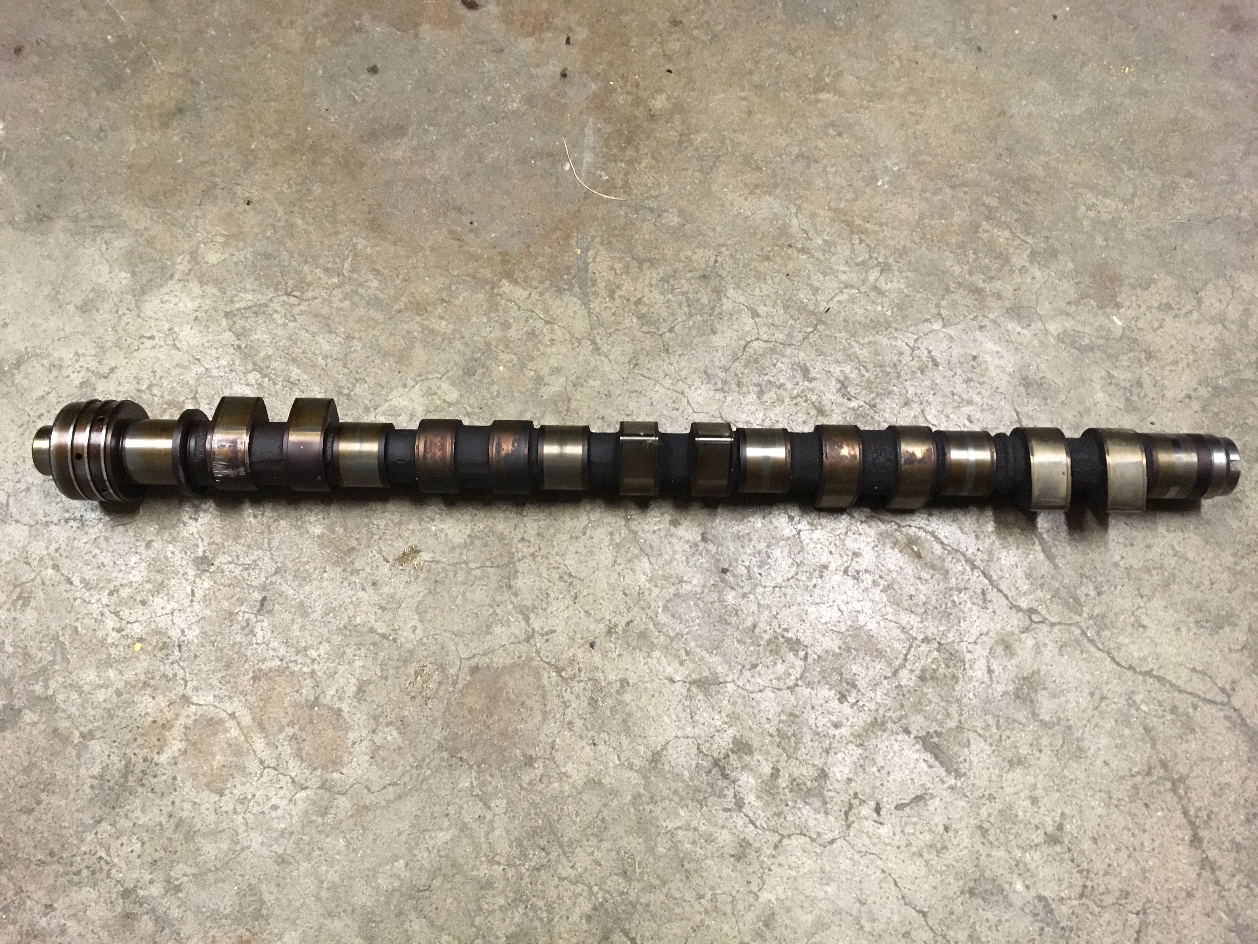

Anybody want a gently used camshaft with a bolt broken off inside? You could saw off a cylinder, put it in your MGB, and that thing will haul!

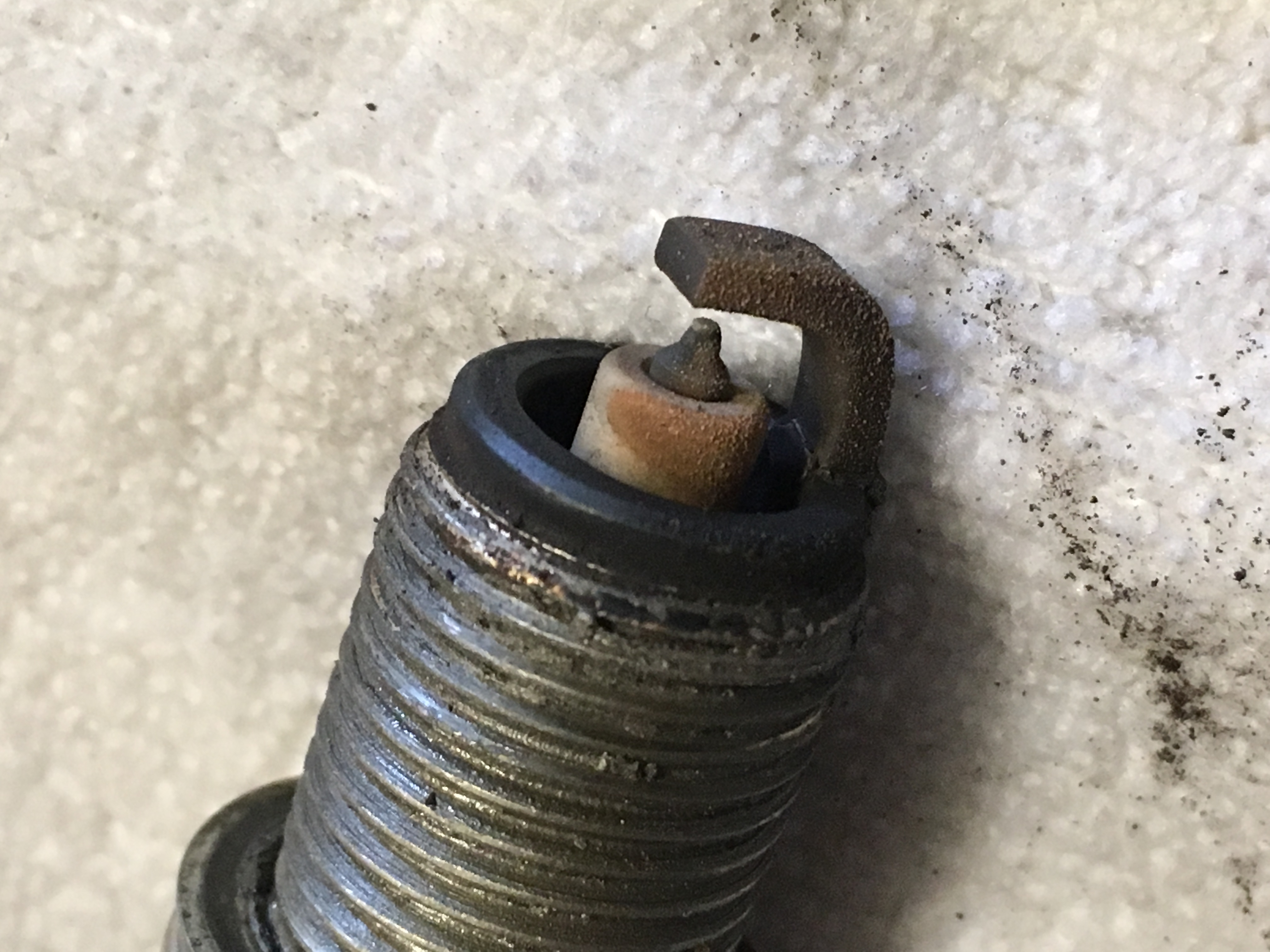

BERU 14FR-7DPPUS2
I cleaned this, gap was close, seems normal brown-tan.
Opinions on condition? I know many of you love your factory Volvo plugs. I believe they're the Bosch platinum at half the price - it says Made in Germany, what else would they be?

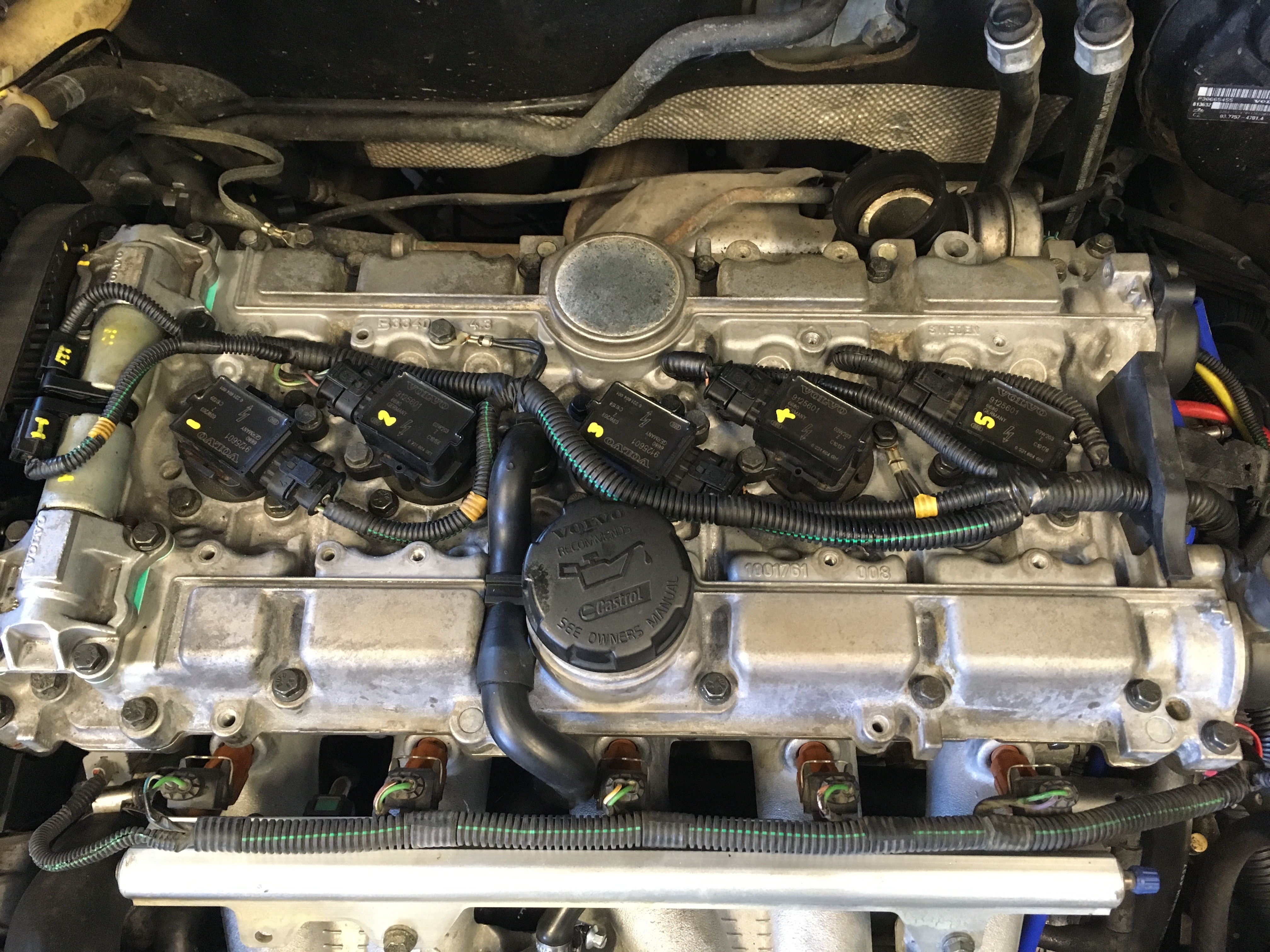

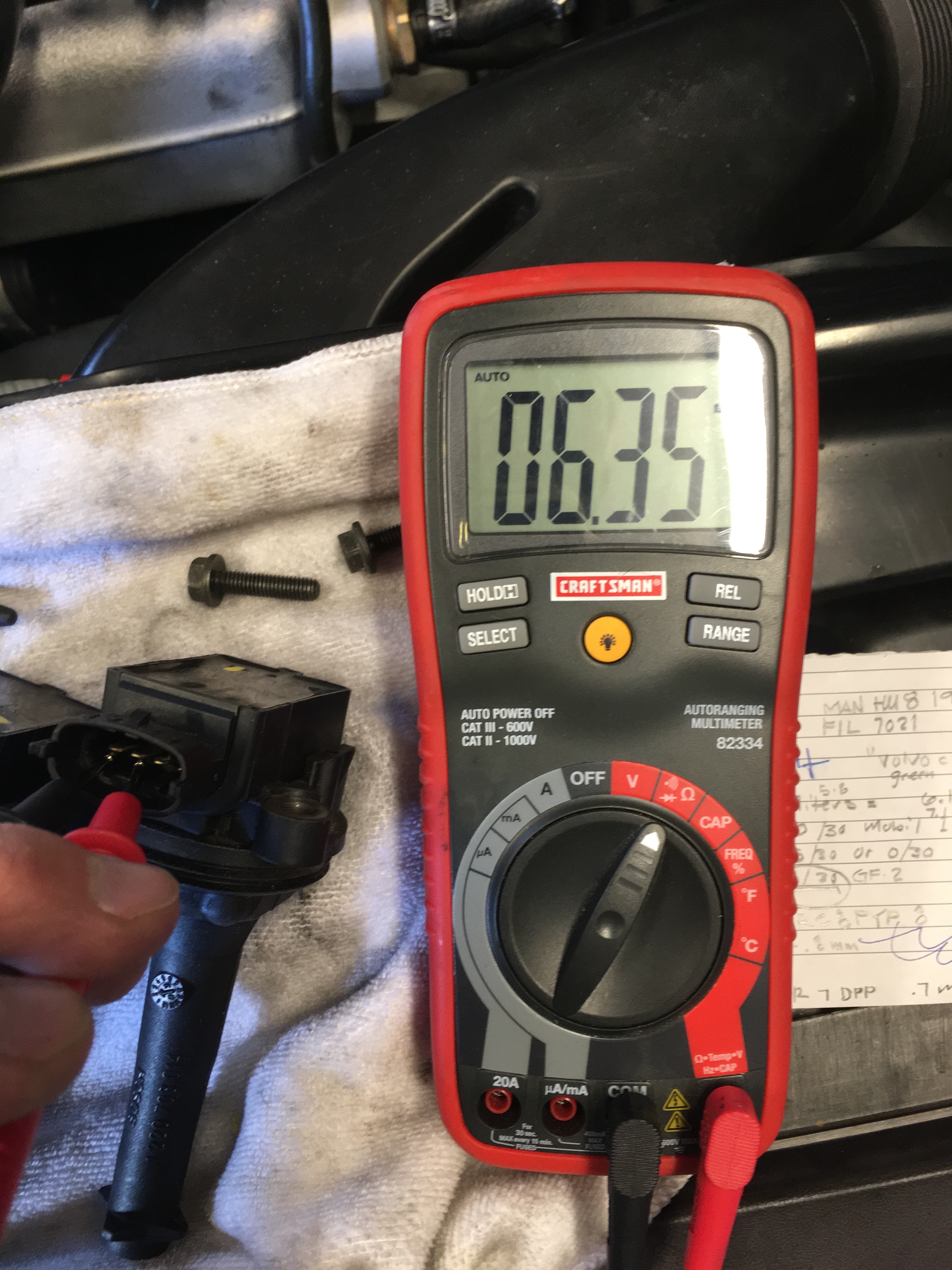

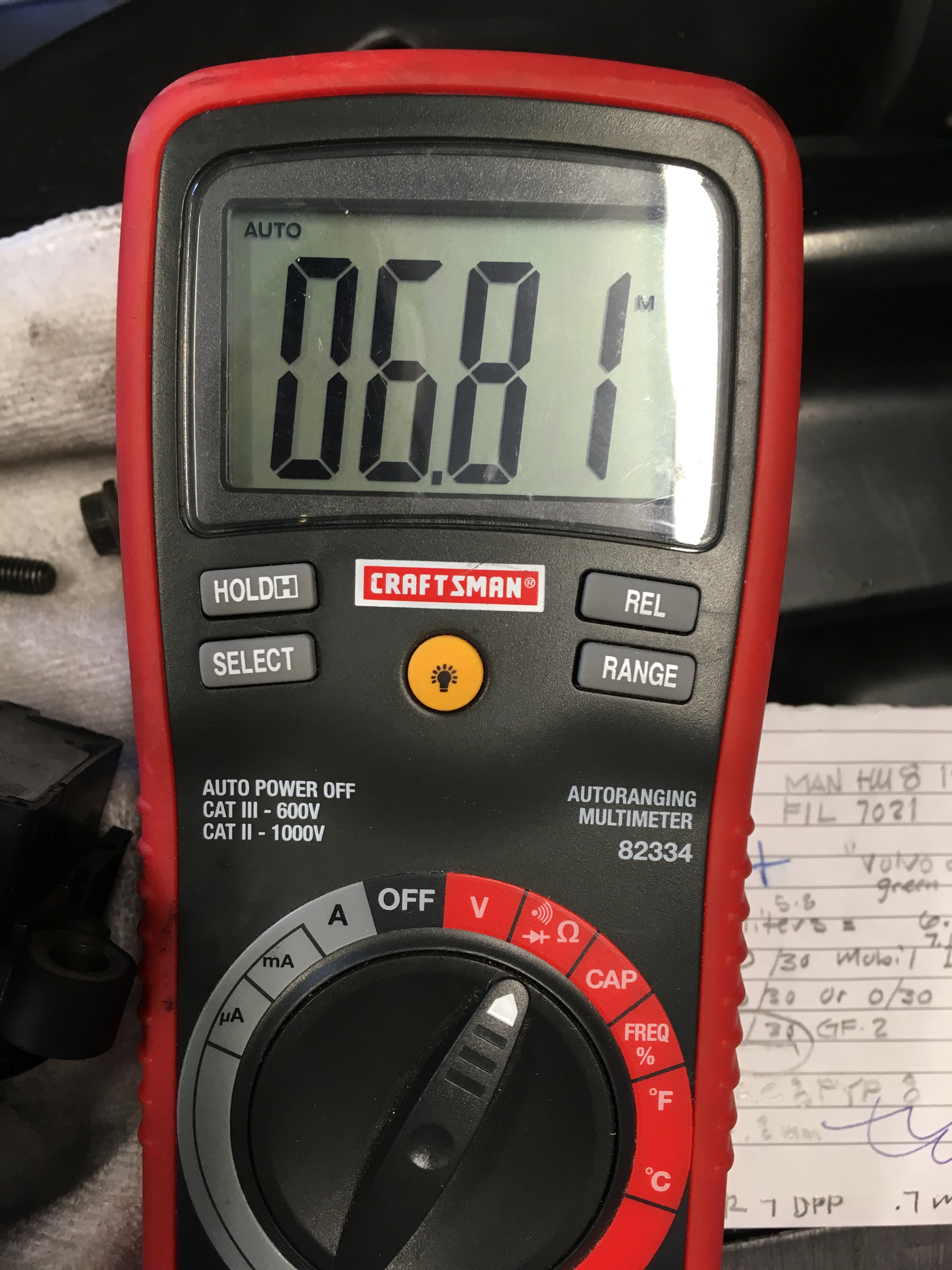

Maybe this should be a new thread, but I'm curious about coil packs, longevity, and how to test.
Videos I saw show 3 prongs at the connector - we have four. BUT...the wiring harness on the engine only has three of those, 1, 2, and 4 locations, looking at the coil.
So going from 2 to 1 with a multimeter, I got these readings. The 6.35 is coil #1, 6.81 is coil 2. 1 is the cylinder that was missing.
I don't know the significance of these numbers and if they're in range. Or it could be the 6.35 is too low and thus the miss at 1.
When have people been changing out their coil packs? When are they failing?

There are so many gems of knowledge in that post, Bart, it will have to wait until after work to cover them all
Extensive coil measurements on a thread - I bookmarked it in my 1999 maintenance log on the T5 Nautic Blue in that Forum area. If you pull the coil part number I have added part numbers to a lot of these threads for real easy searching.
Don't worry about those codes, especially since battery sagged. A low battery can cause all kinds of wrong voltage codes, including high voltage!

y'know.....I just thought of something...
There is a ground in the coil pack harness, about halfway up the head, about between 2 & 3. I couldn't find a hole to bolt it to, except under the plastic cover lip, and there is at least one other ground in that harness, so I just left it off.
Then the misfiring on startup.
Then I bolted it down at one of the plastic cover bolt holes. Maybe each group of coils has to be grounded separately or they won't fire.....hmm.
