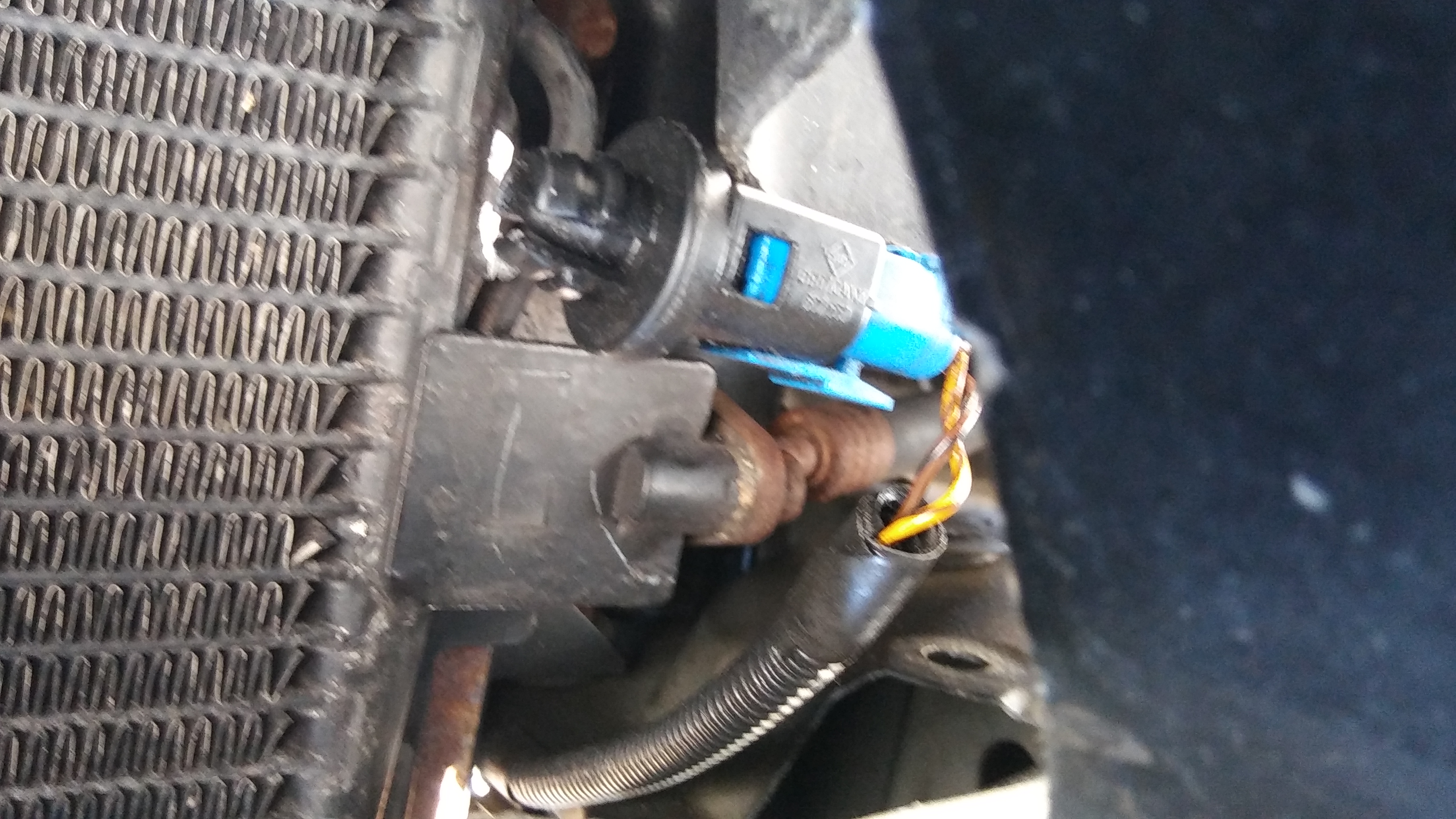

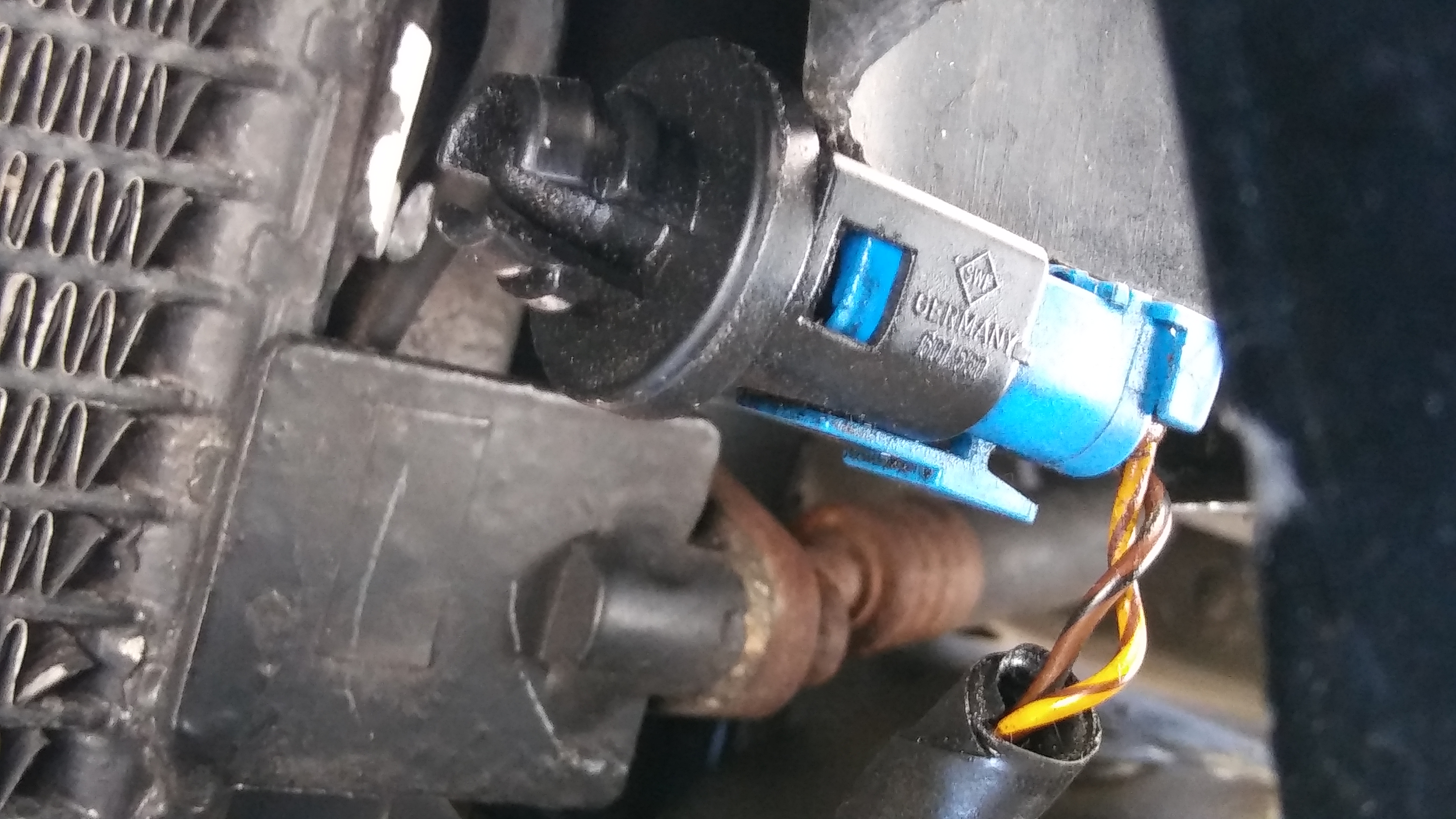

Did you lose them? They are on the vacuum diagram for your car - on sticker under the hood.Ajaga08 wrote: 05 Sep 2018, 12:42 Hi guys,
I'm trying to change All Valves and Hoses one step at a time and now I got stuck with these two strange Vales.( see attached photo).
Do anyone know where to buy those two Valves and roughly how much do they cost ?

You really don't have a reason to replace them unless they are failed.
Simply blow air in both directions....they should let air ONLY in one direction.

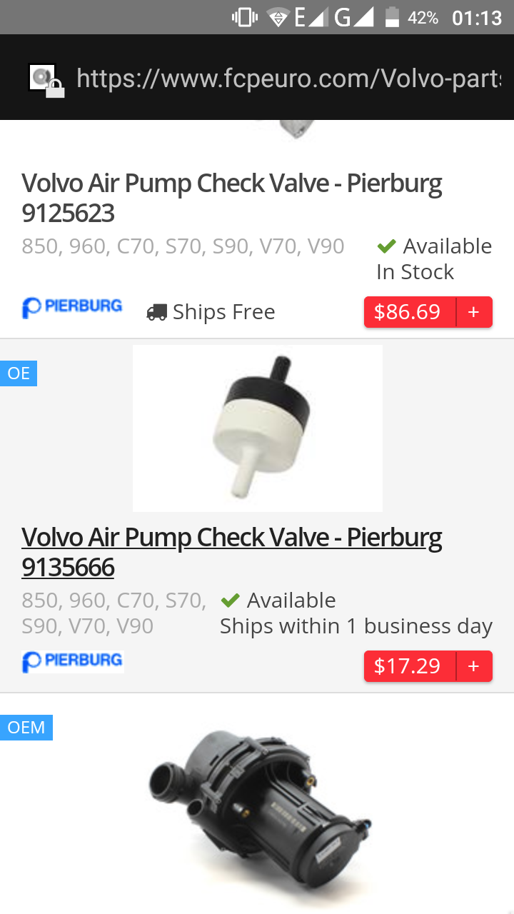

Anything you buy short of MB will be cheaper and crappier than the OEM Volvo ones, even after 20 years.
Thank you all.
@Misha.. After blowing air through them, I noticed that some are going out..maybe due to old age.
Looks like I was able to Freely blow in one direction and a Little bit harder on the other direction. Still.. I was able to blow in air. So.. I was just thinking of replacing the whole lot.

If it lets air in both directions....it's bad.
I'll try to dig a part # for you in my documents.
