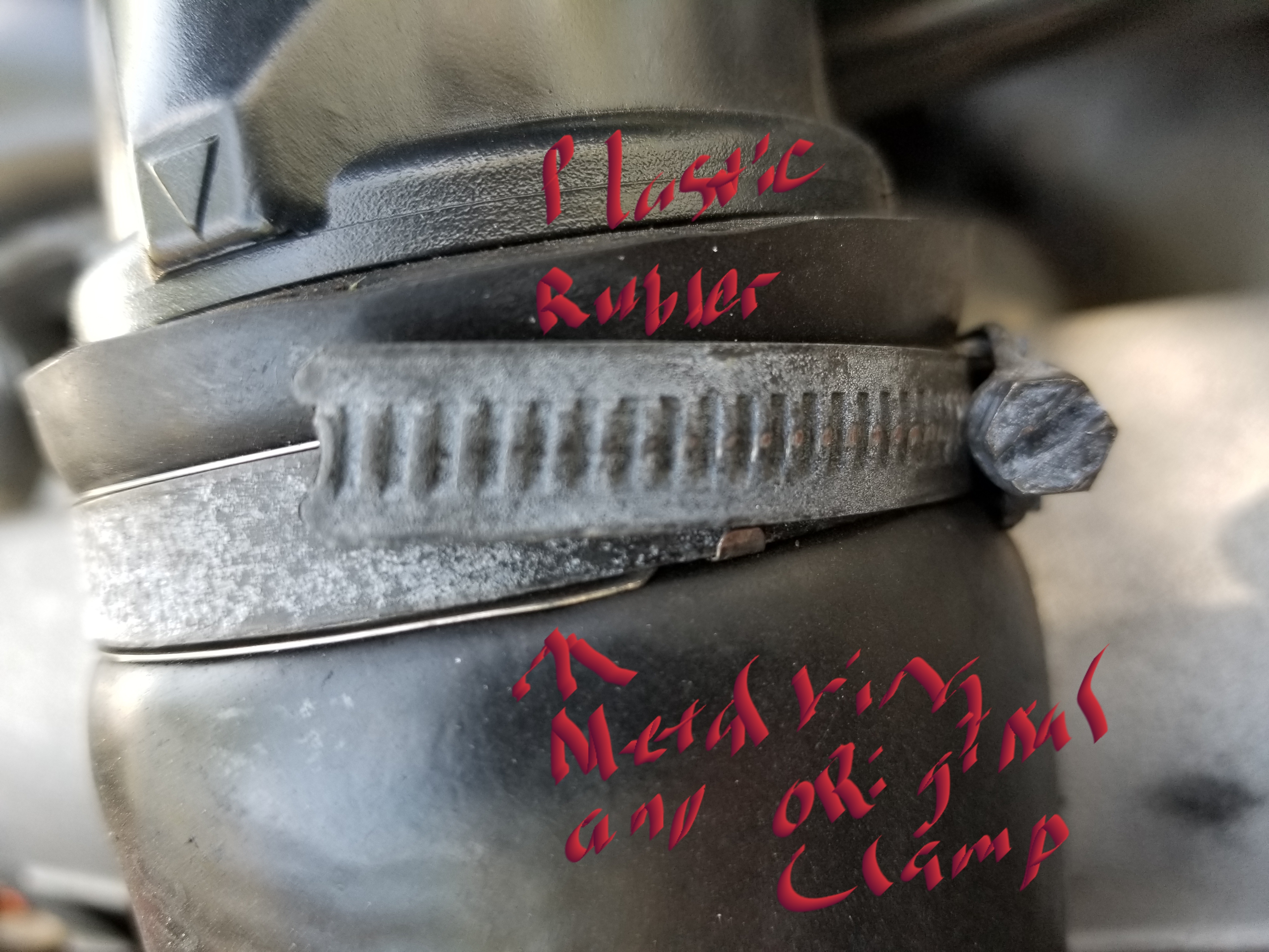

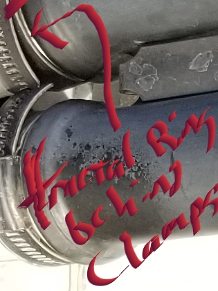

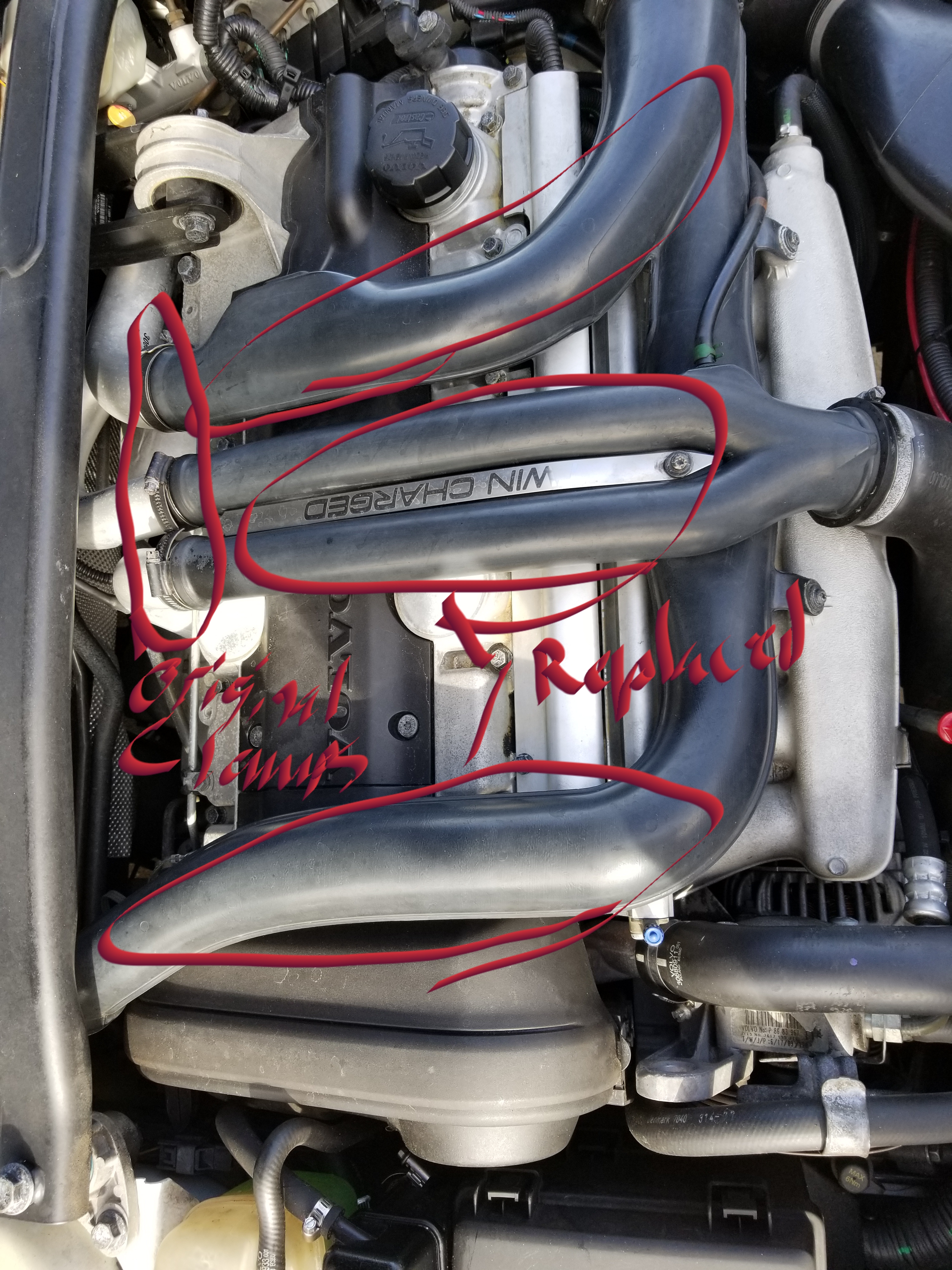

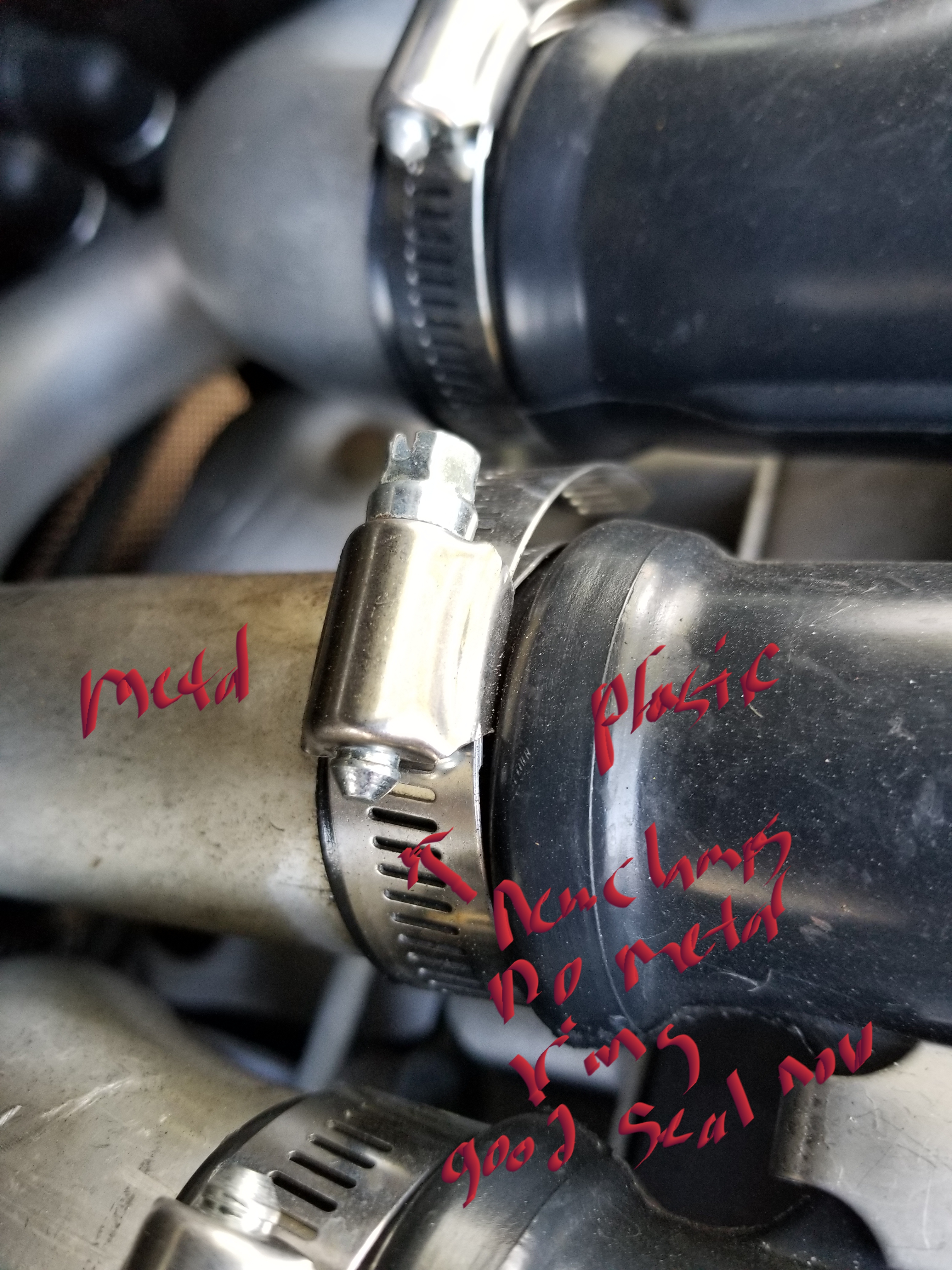

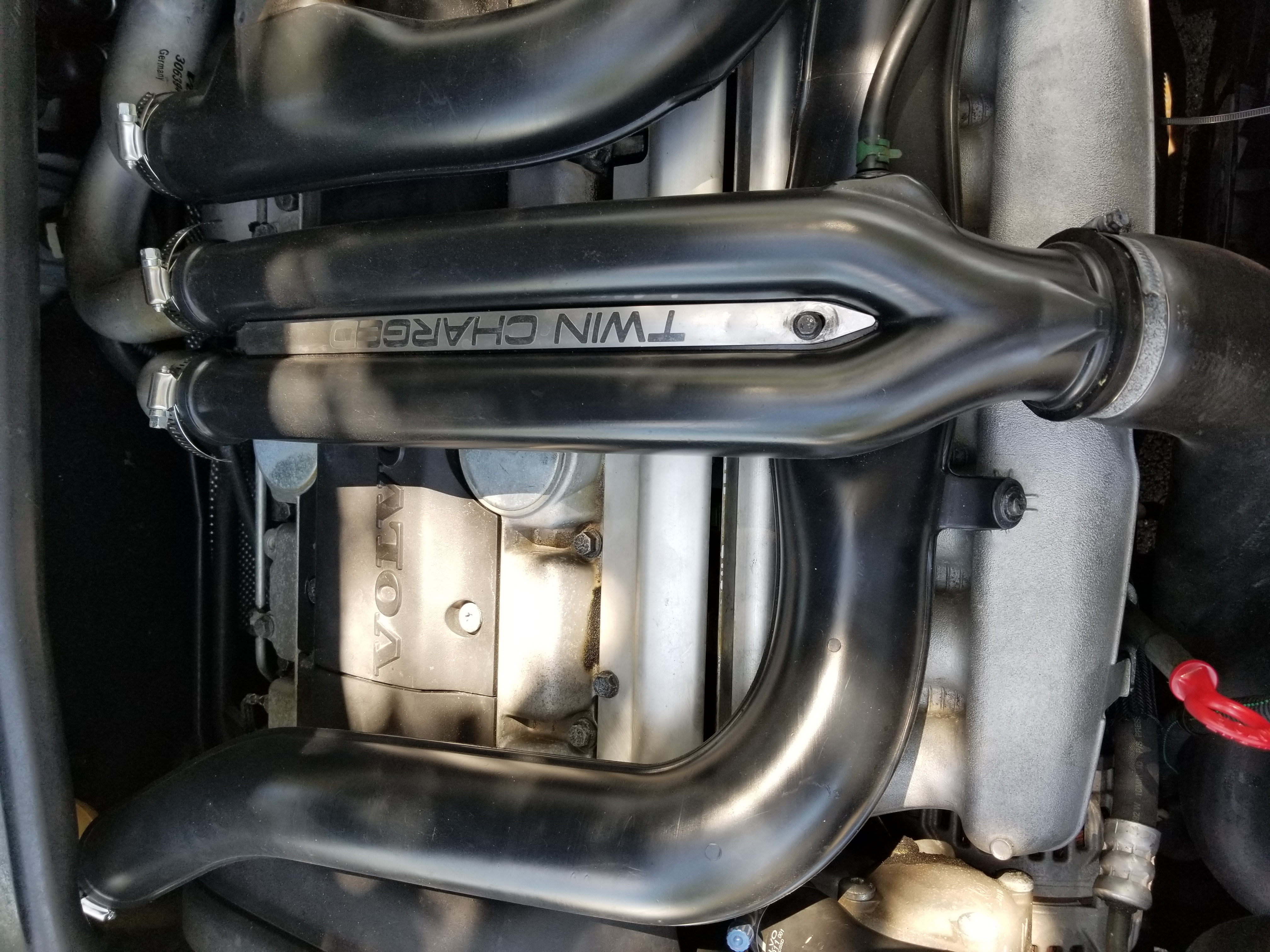

Within the last year my plastic portions of the intake and charge pipes had to be replaced due to leakage. The dealer simply put new parts on. It was the charge tubes that were leaking. I had no engine light or warnings that anything was wrong. After installing the new charge tubes the original clamps still being used as new ones don't come with the tubes would not hold the twin tubes in place under full boost. So the dealer put standard radiator type clamps and no more popping off charge tubes, and no more leaks. The soft rubber tubes are original. My 2004 S80 is a T6 so mine has two turbo chargers. My mechanic at the dealer said the original clamps with the metal backing have trouble with age. June
I added some photos of before tube and some clamps were replaced and now with new hard plastic tubes and which metal backed clamps were replaced with new regular clamps. Yours are somewhat different but likely have the same leak problem where the hard plastic tubes connect to another hard tube, not soft rubber tubes to hard plastic. I hope this makes sense. June

Likely the rigid hose starts getting stiff/brittle with age and the clamps can't exert enough force to squeeze the tube adequately to get a good seal before stripping out. If the hoses are nylon-plastic based you can try soaking them in ethylene glycol to restore pliability. This trick is from a relative who used to work in R&D at a company which one of their primary products was plastic/nylon cable ties.June wrote: 23 Sep 2018, 11:26My mechanic at the dealer said the original clamps with the metal backing have trouble with age. June
Oh, But if the hose has cracked (in June's case) your best bet would be to replace it.

Original metal backed clamps would not hold the new hard plastic tubes in place. Were fine with original tubes with cracks, but kept popping off with new plastic tubes. That is when mechanic put standard clamps in which stopped the problem. He told me standard clamps work better at the joints where the tube is connected to a hard pipe. IDK why that would be, but he is the top mechanic at my dealer. Otherwise I would have been highly suspicious of altering something from factory form. So far no more leaks or popping off tubes. Junemrbrian200 wrote: 23 Sep 2018, 11:46Likely the rigid hose starts getting stiff/brittle with age and the clamps can't exert enough force to squeeze the tube adequately to get a good seal before stripping out. If the hoses are nylon-plastic based you can try soaking them in ethylene glycol to restore pliability. This trick is from a relative who used to work in R&D at a company which one of their primary products was plastic/nylon cable ties.June wrote: 23 Sep 2018, 11:26My mechanic at the dealer said the original clamps with the metal backing have trouble with age. June

Thank you for your reply and photos. Since my original clamp got stripped out, I bought some regular hose clamps similar to the ones in your pictures. I thought they would be able to clamp with more force but they did not seal my leak. I pressurized the system and tried tightening/loosening it and couldn't get it to seal. I used the original metal backing/sleeve as it fit perfectly with the new clamp. I used the original sleeve thinking it would more evenly distribute the force of the clamp. I have not tried using just the clamp alone. It seems to me that there would be a gap under the screw mechanism of the clamp. I didn't mention in my original post that I did buy a new intercooler charge pipe and it didn't seal either. It behaved the same as my old one.June wrote: 23 Sep 2018, 11:26 Within the last year my plastic portions of the intake and charge pipes had to be replaced due to leakage. The dealer simply put new parts on. It was the charge tubes that were leaking. I had no engine light or warnings that anything was wrong. After installing the new charge tubes the original clamps still being used as new ones don't come with the tubes would not hold the twin tubes in place under full boost. So the dealer put standard radiator type clamps and no more popping off charge tubes, and no more leaks. The soft rubber tubes are original. My 2004 S80 is a T6 so mine has two turbo chargers. My mechanic at the dealer said the original clamps with the metal backing have trouble with age. June
