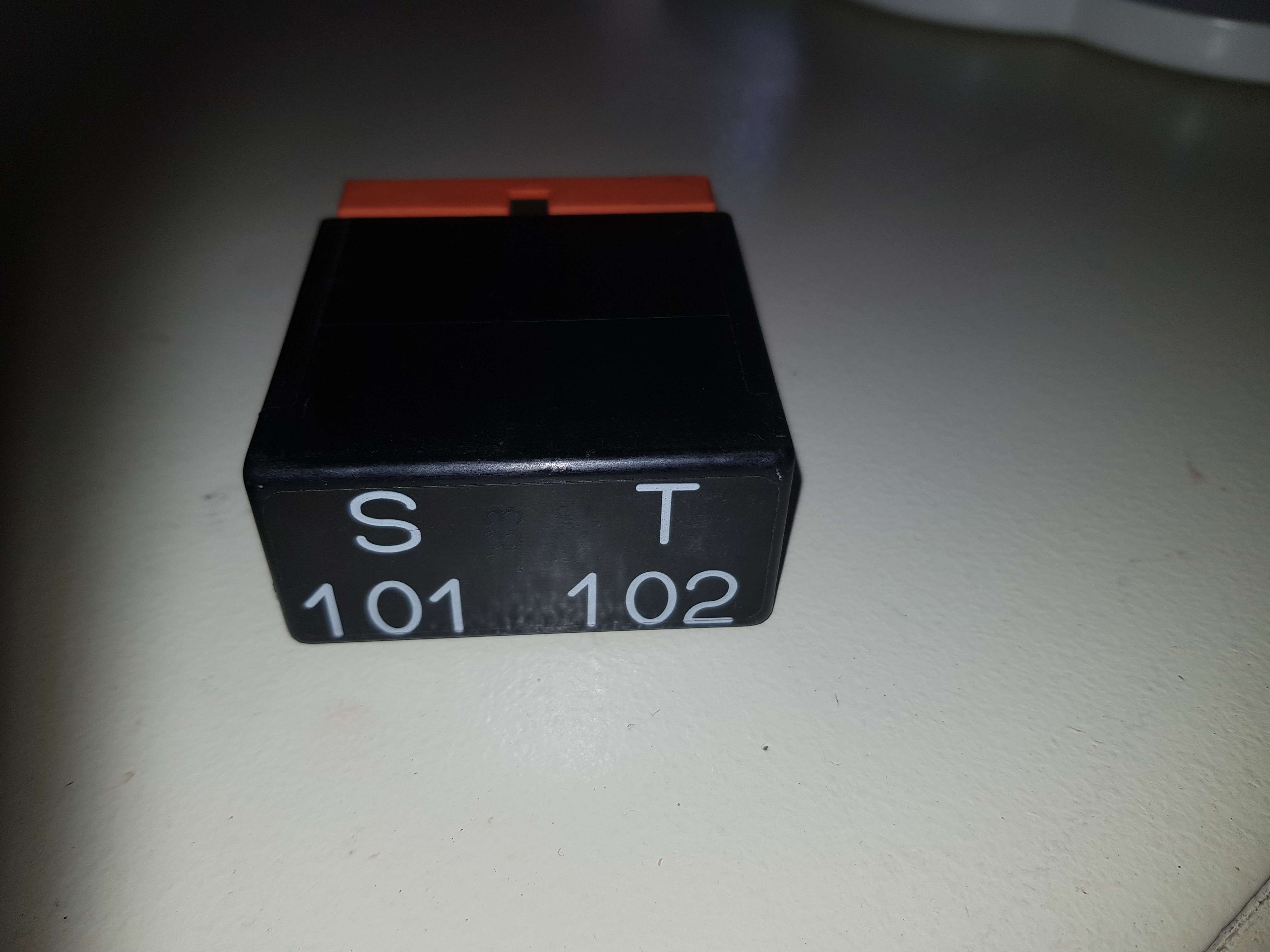

I looked this up recently, also, due to same symptoms in my 96 base 850. I haven't solved mine but I will explore one suggestion: the control module in the fuse box. Somebody confirm this, I think it's the one next to the headlight module. In that post I think someone suggested cleaning the contacts first. If that doesn't work I don't know if there's a way to test it off the pins.
