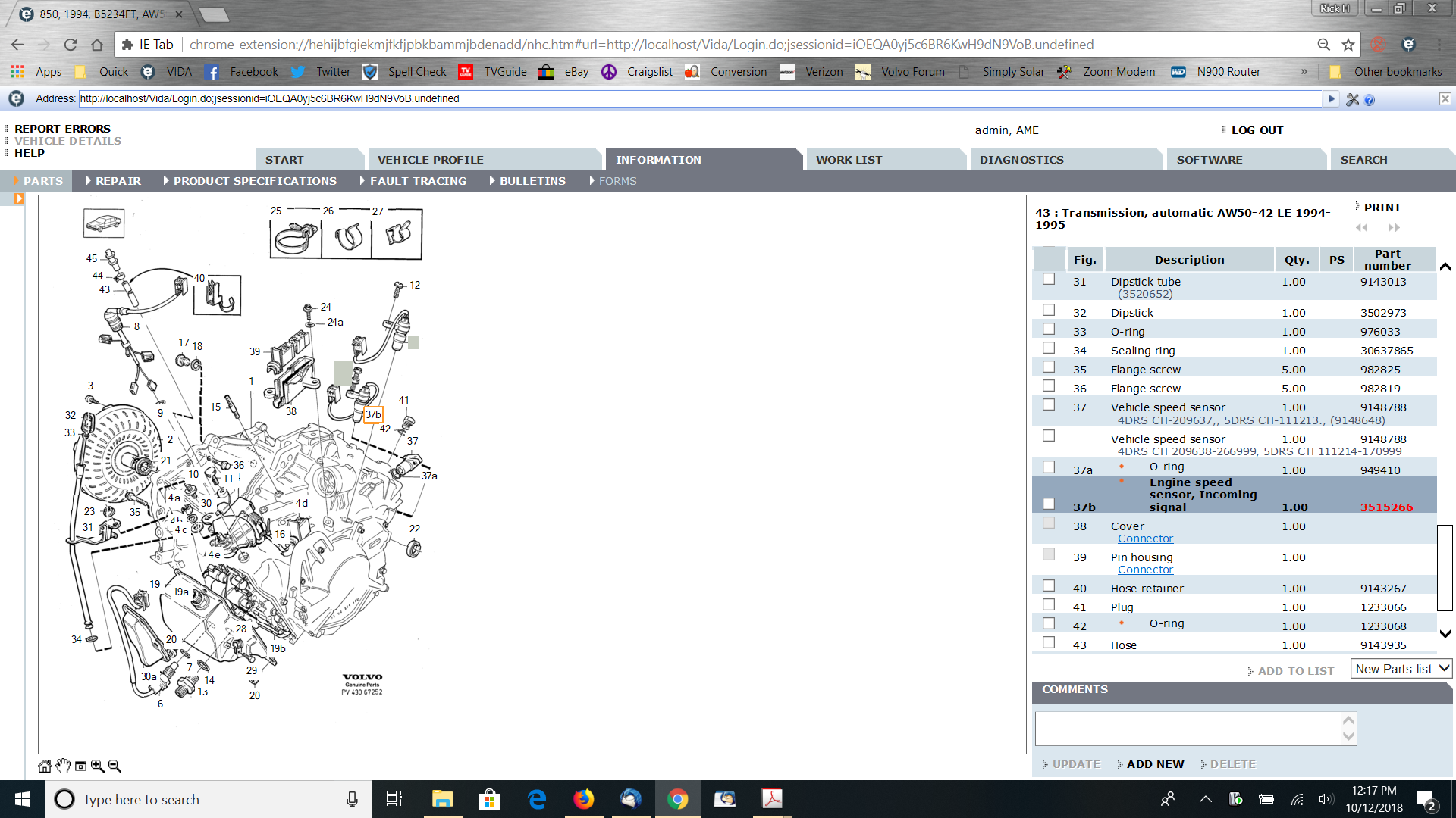

Does this car have a OBD under the hood?
Engine speed sensor or the loom to it, can cause a no spark.
37b = Engine speed sensor.

Hello Rick,
Thanks for additional thoughts. I believe the part you refer to (37B) is what may also be referred to as the camshaft sensor, if so, then Yes, that has been done (pic looks exactly like and location of the cam sensor I changed).
OBD....just in front of the box that houses the ECU and ICU are two ports, OBD-ish looking early type things, much lager pins (8-10mm) that a local technician told me is an early diagnostic readout but that to get a computer to read it is near impossible to find.

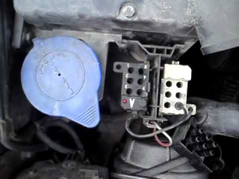

Greg and Misha, thanks for insight...it actually jogged my memory, tech told me not about computer connecting to it, but that when pushing the button on it, it does not activate flash or send code, as if it is shot/bad bulb/new england corrosion/etc. Sorry for the inaccuracy in post. Another technician told me that getting a breakout box to get more specific tracking from the ECU pins was near impossible to find. This breakdown of the 850 has been such a cluster of chaos that my head has not stopped spinning.
Meantime,2 local junkyards told me they found ECUs. One has matching numbers, the other does not. Are the number sets in my first post crucial to be an exact match? It seems almost 99% indicative of the ECU in several peoples minds...is it worth a non-returnable 150 $ part? Cause if that does not fix it, my patience will be depleted and the car likely to scrapyard.
Below is what mine looks like.

Sorry, here is the pic...I hope
- hqdefault copy.jpg (15.44 KiB) Viewed 897 times
- sorry, here is the pic
- hqdefault.jpg (15.44 KiB) Viewed 897 times

Check all fuses in the fuse box and proceed with instructions greg850r allready posted.
Diagnostics on these OBDI cars are pretty easy,just make sure that key is in position II before starting procedure.
