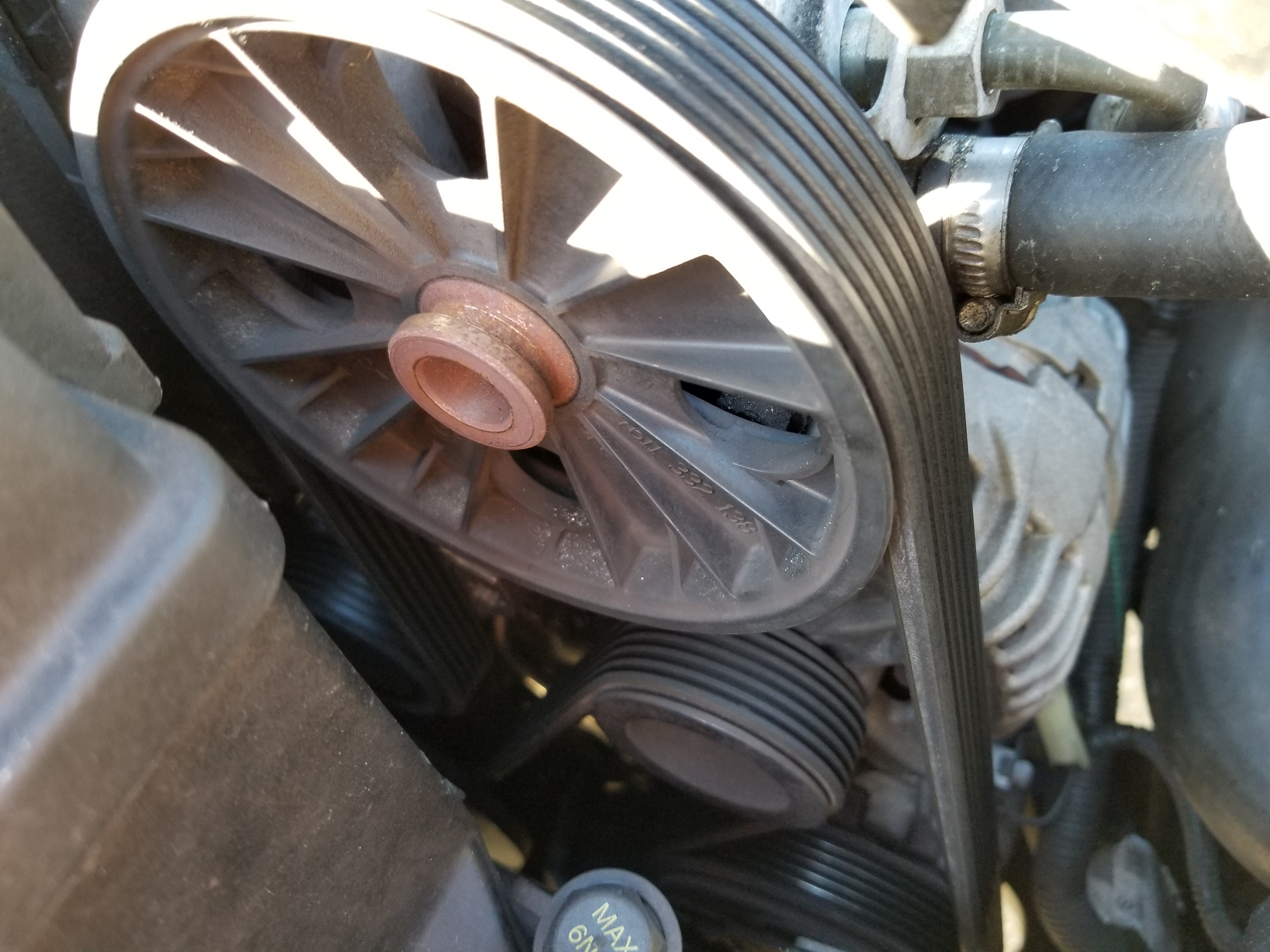

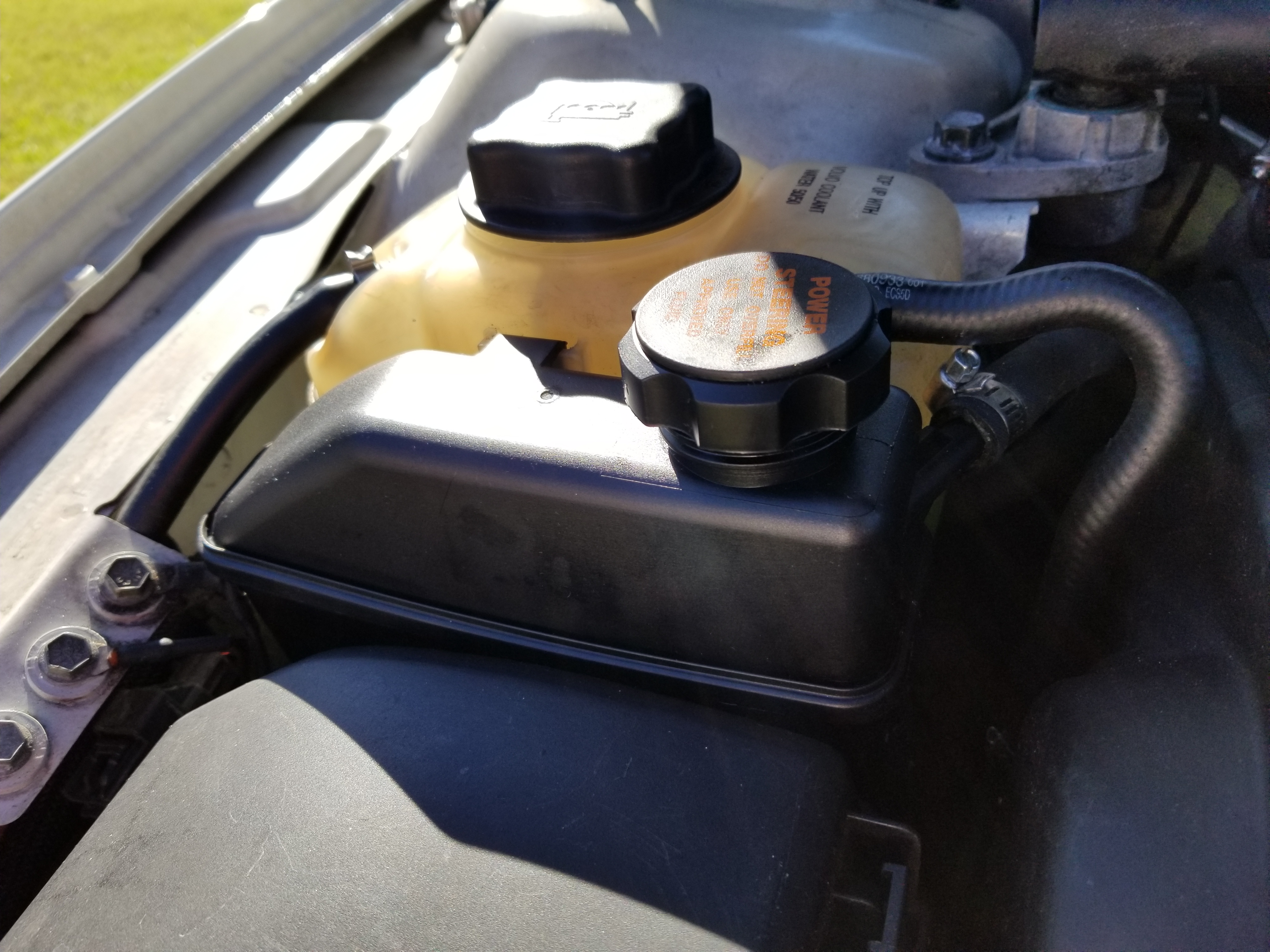

Please keep us updated because I sure would like to know what is in that reservoir that could cause the pump to whine???? It makes no sense to me, that is the main reason I made this thread in case others had the fluid seeping at the reservoir and a strange wine that in my car's case both were related and a simple replacement of the reservoir could fix both.Rattnalle wrote: ↑28 Oct 2018, 13:58 I checked my pulleys a year ago when I did the timing belt. I know the AC pulley bearing needs replacing down the road but everything else is either fine or new. I've been thinking the whole time it sounds a little bit like when the power steering fluid level is a bit low but it isn't and the fluid has been flushed with new fluid.
Since mine is also leaky I'll just replace it and see what happens. I've got the dealership across the street from work and need to get a few vacuum tubes that look dry and worn as well. Might as well not put it off any longer.
And as for mileage it has sounded the same since I got the car about 60' km ago.
Several hundred miles later the reservoir is still dry. Notice the pump is original. June
