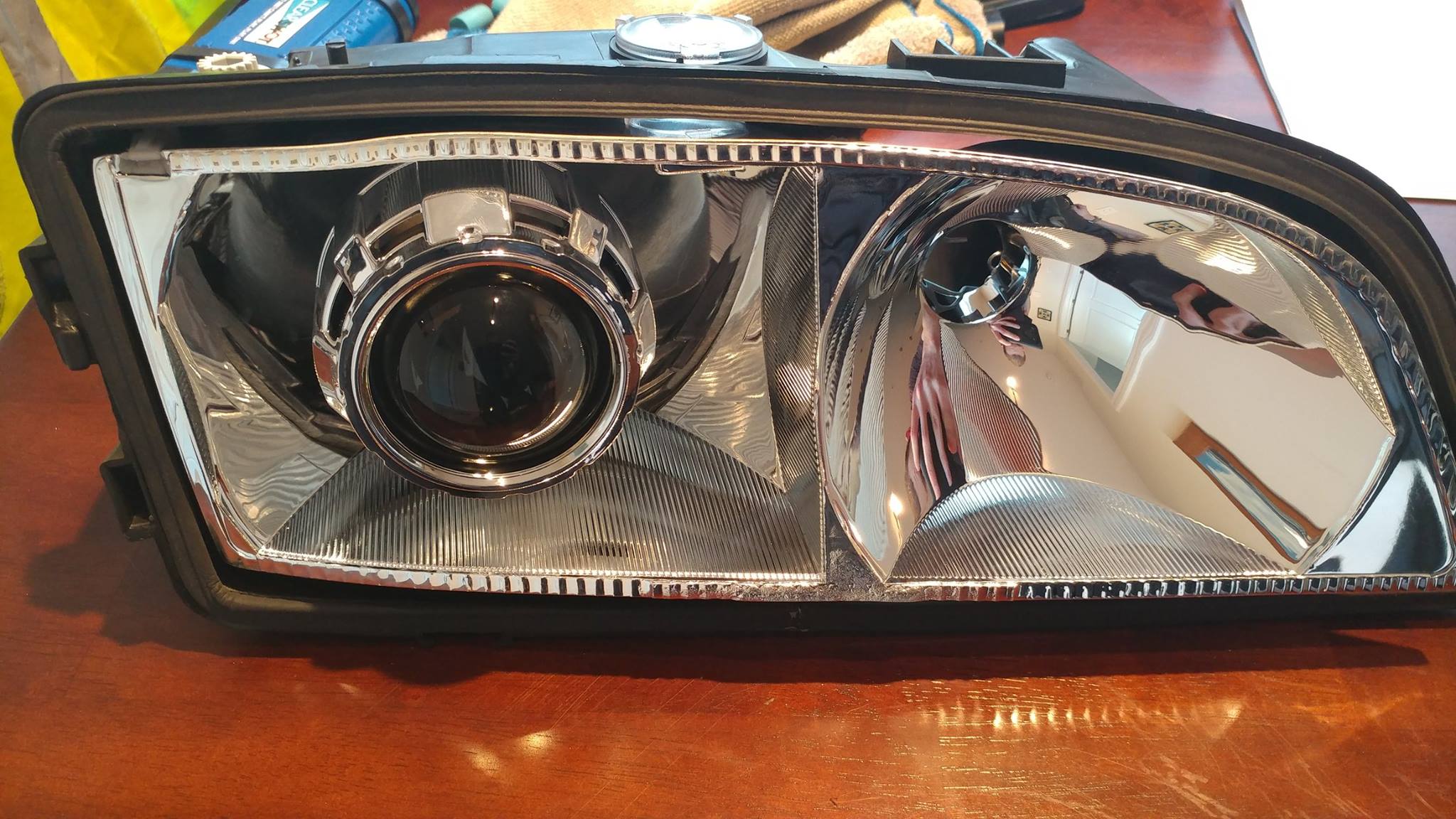

If you want some seriously good light that doesn't endanger other motorists, do a projector retrofit. (See below)

Sorry, not trying to hijack the thread, but...
I got the kit from The Retrofit Source and used stock housings with lenses from the C70 (clear).
-Stock/OEM housings
-Morimoto Bi-Xenon Mini H1
-Clear lenses
The bi-xenon is cool because you can have high and low beam all-in-one. Additionally, you can do like I did and still use the stock high beam slot as well and essentially have dual high beams. In this case I did use LEDs for those, because with high beams I'm not worried about the potential light scatter. The results are incredible.
