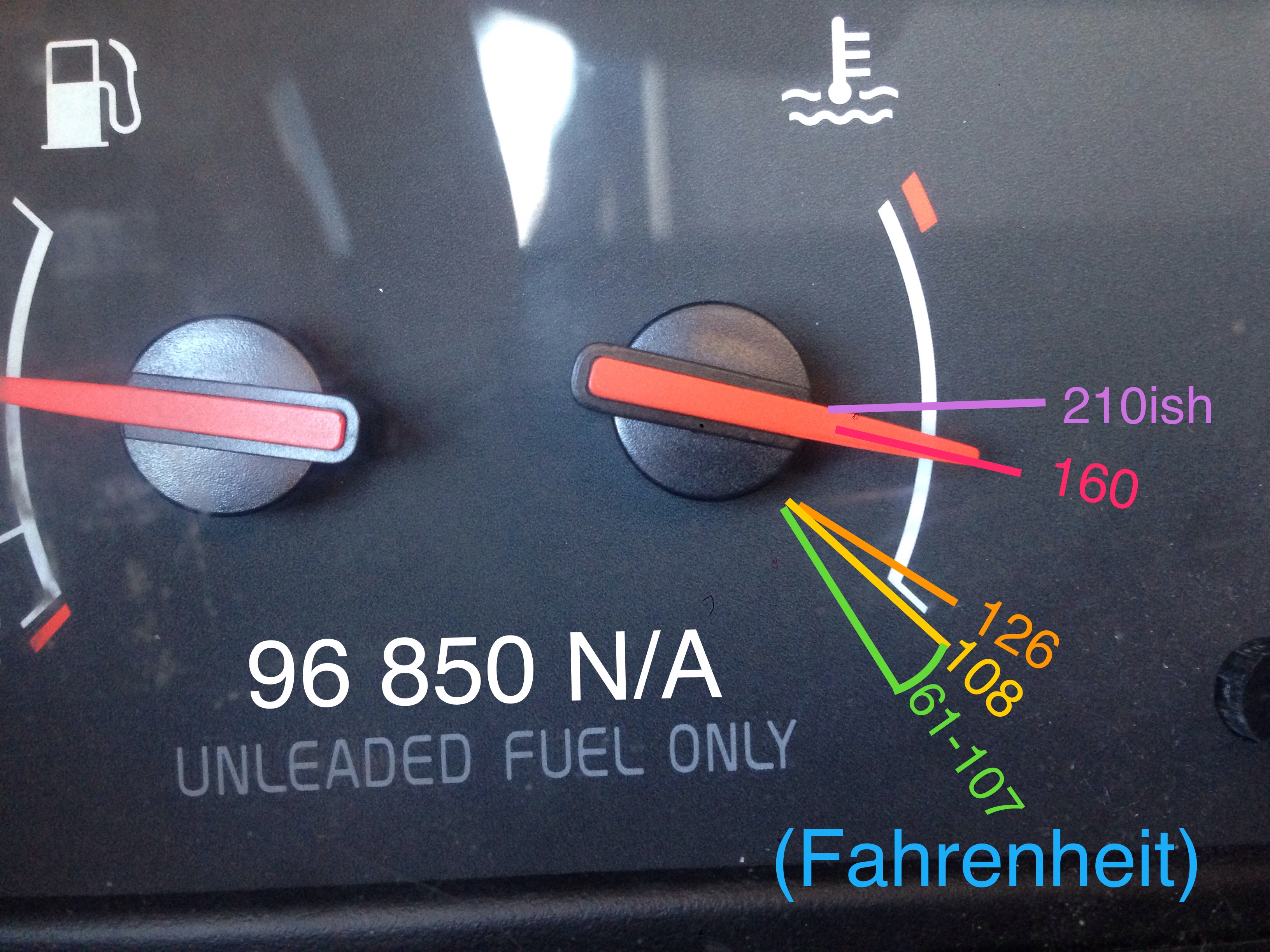

Tried to go for "Just barely warm enough to nudge the thermostat" approach on my 3(!) drive cycles today (mind you, that's a 50 minute wait between each..!) .. NO DICE
Going to reborrow friends OBD and check what real number corresponds to that spot on the gauge to see if I've even been in the right temp today.. I hope it reveals I wasn't, just for the sake that there may be an easy fix at the end of all this..

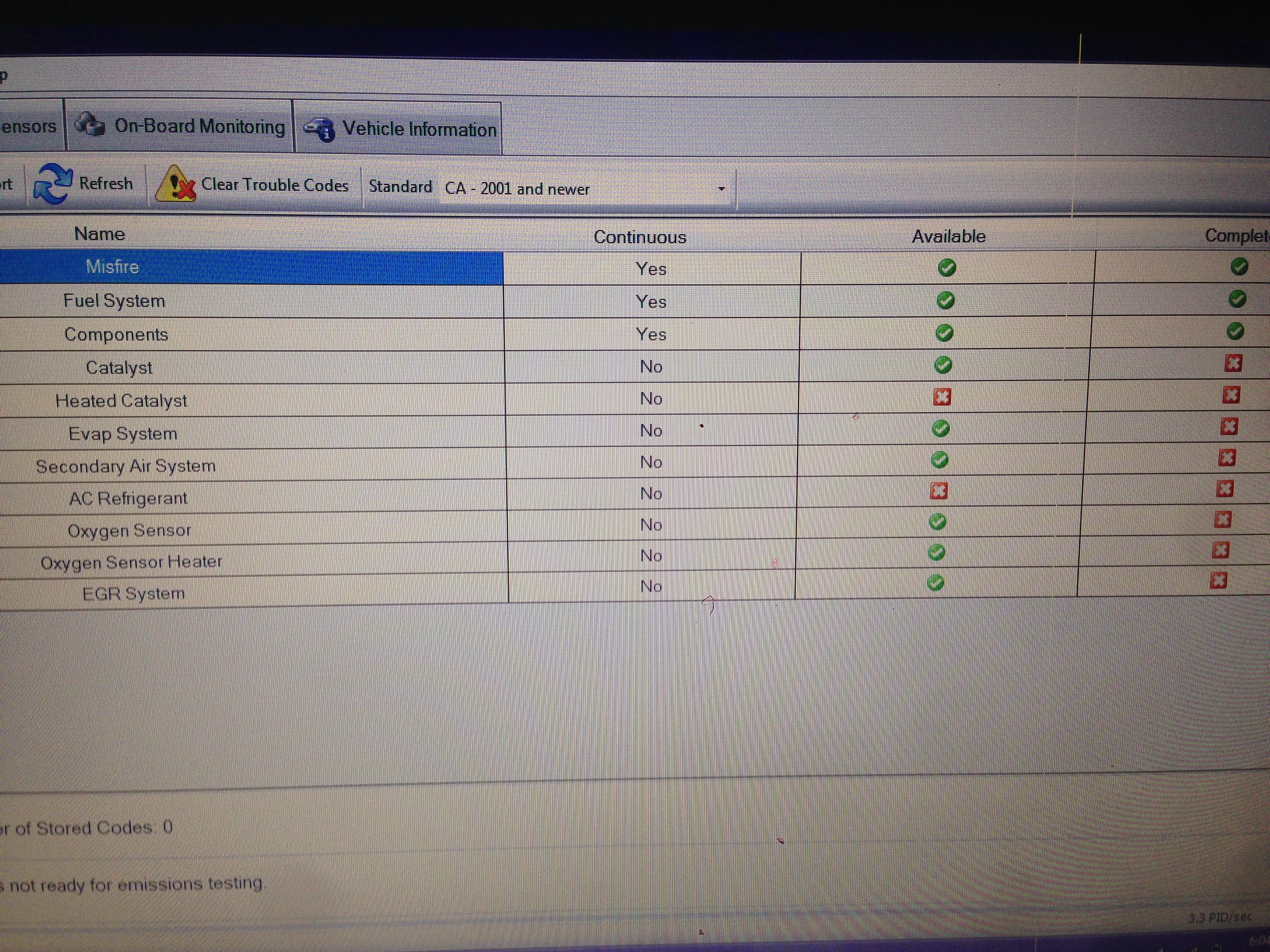

Here's a ref of the readiness codes if anyone's curious.. if this pattern of unreadiness is indicative of anything, please let me know!
Scan from better OBD
Posts: 36137
Joined: 17 Feb 2013, 17:54
Has thanked: 1609 times
Been thanked: 4064 times
Are you sure those are readiness indicators?
If the continuous monitored things aren’t going ready almost immediately, you have major issues in the ECM or wiring
erikv11
Posts: 11910
Joined: 25 Jul 2009, 14:03
Location: Iowa
Has thanked: 311 times
Been thanked: 817 times
Post by erikv11 »
Look at the image, the continuously monitored are the three that are showing ready.
Is this car a turbo or non-turbo?

96(?) 850 N/A Base ; new O2 sensors 2-3 years ago
Followup to whoever mentioned I buy some additives to "clean" my O2 sensors, I've been told the regulations surrounding additives around emissions are so tight, all the stuff is different colored ethanol, a snake oil scheme for the desperate. *** At least in CA
Going to check the engine temps against the needle position I started at yesterday, hopefully starting temp should be a lot higher than ive been working with and I was out of range this whole time...

abscate wrote: 08 Nov 2018, 04:48 Are you sure those are readiness indicators?
I read about this: readiness monitors are either 'Continuous' or not. 'Continuous' monitors are constantly being checked as part of normal operation, whereas the other monitors need specific conditions to be tested.. a "Drive Cycle"
(I'm not trying to be snarky here, I want to be as clear as possible for whatever poor soul later is in my shoes and has to reread this thread)

Just finished checking the temp gauge against the OBDII Temp readout.. turns out I've been starting all of my 'TRIP's around 130-145, and before that- at a cold ~60.
Still.. after 600-700 miles of otherwise perfect driving conditions, I can't imagine the system would be so picky that 10 degrees would actually make a difference.. cautiously hopeful...
