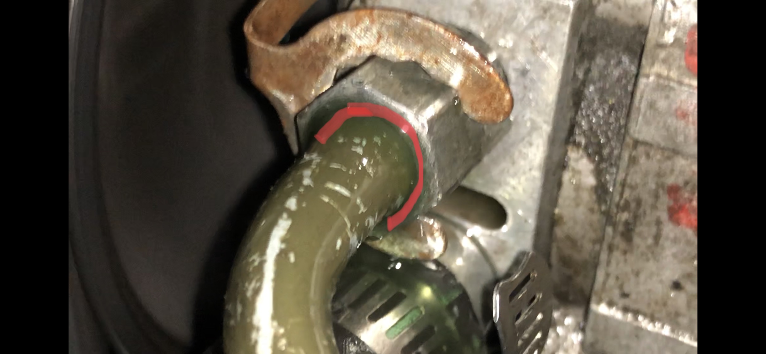

Over the past week or so, a leak has developed seeping from the power steering pressure line. Specifically, it’s coming from the joint between the pressure line itself and the nut that attaches it to the pump. At idle it produces a steady trickle of fluid, and when you actually try to drive the car and turn the wheels, it dumps nearly the entire contents of the reservoir. See attached photo, red line indicates leak area.
The leak occurs only when the pump is running.
My most recent work with the power steering system was last week when I flipped over the gasket on the power steering reservoir lid to stop a leak that had been showing up there. A few months ago, I replaced the o-ring on the fitting for the high pressure line while I had it disconnected to work on the radiator.
Thoughts I had were: 1. Did I wreck the new o-ring when I installed it? If so, why didn’t it start leaking immediately? 2. Did I get a bad o-ring? 3. Did fixing the leak at the reservoir cap shift a pressure leak to the next weakest link in the chain, and am I simply going to be playing PS leak whack-a-mole until basically the whole PS system is replaced? (The very first job we did when we got this car was replacing the power steering high pressure line, because it was leaking (known when purchasing).

Looks like the locking washer is well in place and prevents the nut from loosening.
I've been removing and replacing the same oil seal for too many times, yet to have any leaks there. So the genuine seal even when it looks beaten up, if it's cleaned well it's good for long time.
Upon driving the car, does it seem to be a lot of pressure when removing the cap?
My only fear is an over-tightened nut, which would shear the threads. The pump is made of alloy so not that hard for this to happen.
Otherwise the seal may be busted
I'm also thinking of a lot of debris blocking the filter inside the reservoir, but less likely.

It is really easy to mess up the Oring there. Pull off the nut and line, pull off the Oring and it should look perfect. Any folds or distortions, replace it.

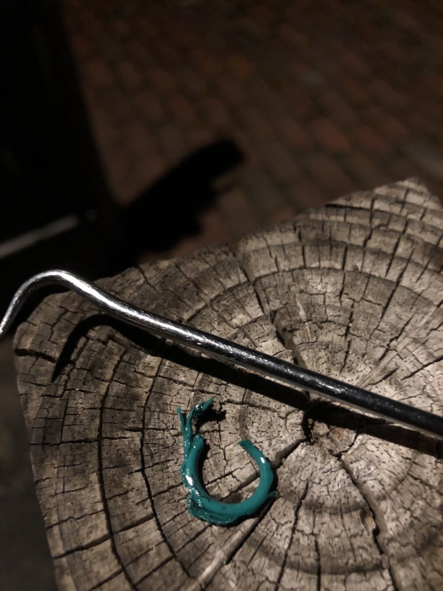

This is what I found upon removal of the pressure line from the pump:
In this photo you can see how it was severed. It was already like that when I pulled it off the line:
I believe this happened due to me improperly aligning the line when I re-inserted it the last time. I think the o-ring just got caught on the side and then eventually tore. Part of the reason for the alignment issue is that I had reattached the intercooler pipe and the oil dipstick tube before attaching the power steering line, which didn't leave me much room to work with. This time, I moved/removed both of those obstructions and inserted the power steering fitting first, ensuring that it was not at an angle at any point between insertion and tightening. Then I hooked the other items back up. There is no longer a leak coming from the pump.

Neil - I got your PM. No, you can't superglue that O-ring back together and reuse it.
