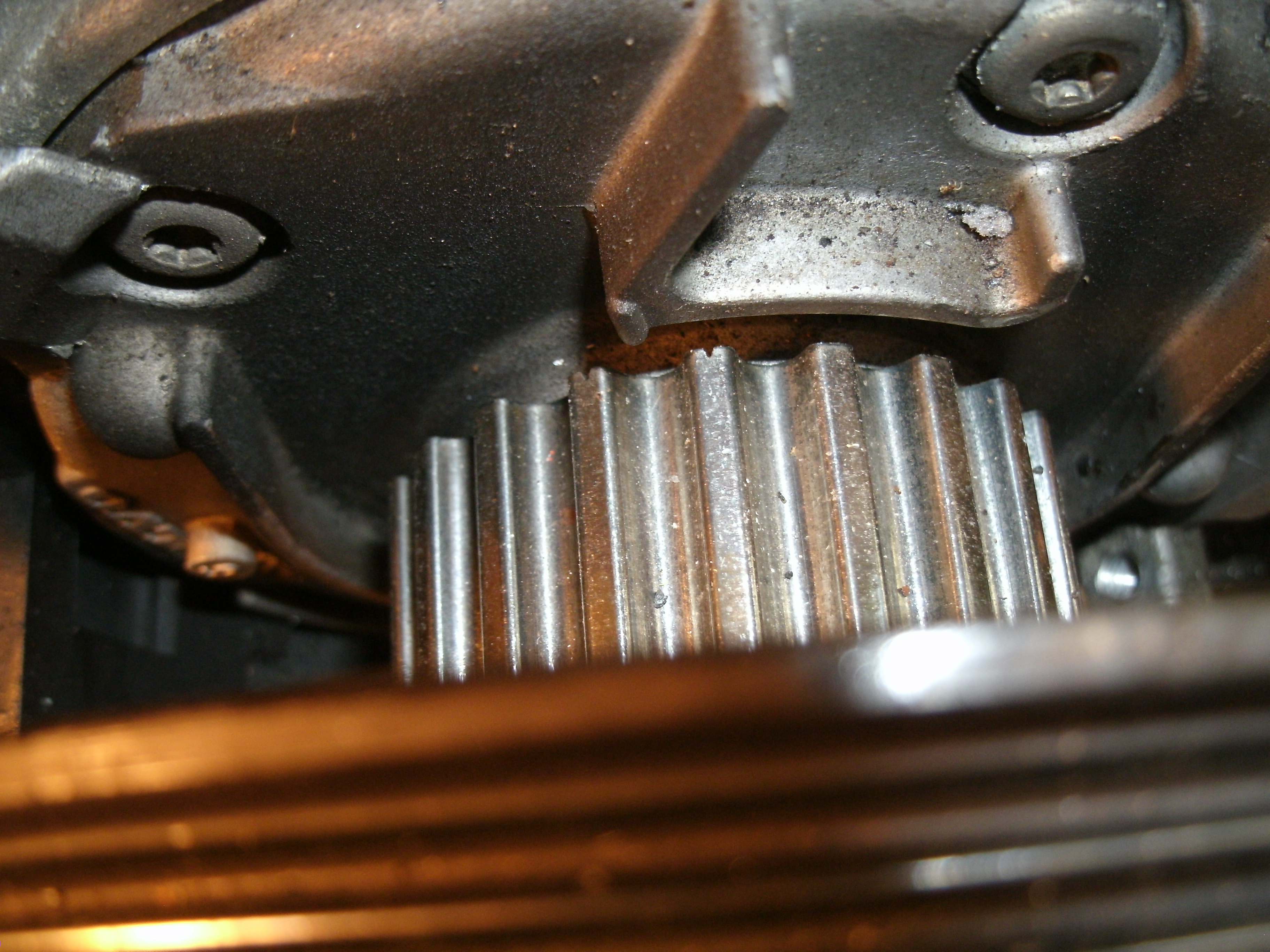

The marks are a bit tough to see. On your '95 it likely looks like this:
If you zoom in on the picture you can see the tiny notch at the rear of the sprocket.

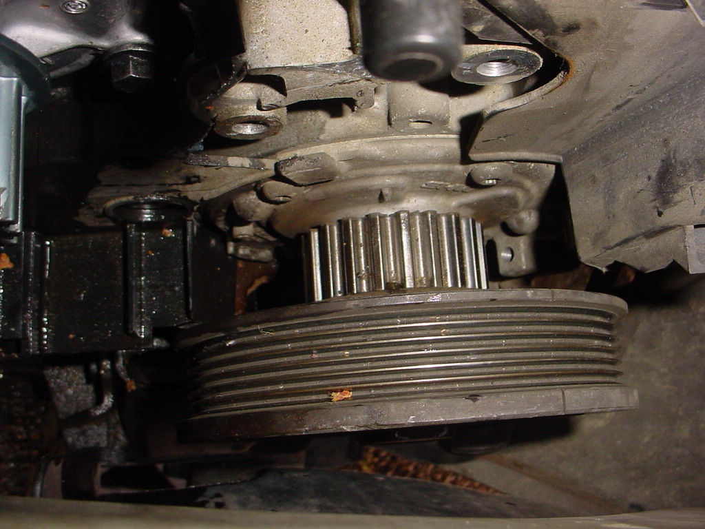

But it may look like this:
On that style there are two tiny notches and the timing mark on the oil pump gets centered between the two marks.

Thanks those pictures help tremendously, wasn't sure what I was suppose to be seeing the first time around.
