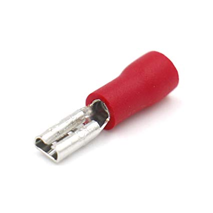

I have dealt with this problem and it is junk electrical connectors. Many car makes have this problem and a part of it is the terminal of the bulb is not inserting into the female terminals in connector very deep. The female terminals that work have a back up spring and their grasp of the bulb male terminal is much stronger.
I have 100% success (so far) with using a terminal and covering it with heat shrink and sliding it onto bulb terminals with no plastic connector body. That way the insertion depth is maxed out.
Use a new bulb as the overheated terminal in bulb will have surface oxidation. Many times the problem is a vicious circle of bad connector over heats recent bulb. recent bulb burns new connector. another new bulb gets oxidized connections from the last bulb oxidizing the terminals in the replaced connector. etc. etc.

- 4mm term.jpg (8.27 KiB) Viewed 1310 times

Jimmy57, using a good old fashioned connector is an interesting thought. the H11 terminal connectors I've been using have been allowing me to completely seat the bulb so the side locking straps engage fully with the bulb but the 18 guage wire attached to the terminal plug does seem a little thin for the heat generated with the sylvania halogen bulbs I'm using.
Thank you both for your excellent insights. I think I'm going to buy a new bulb and splice in a new connector to see if that solves the "vicious cycle" oxidation problem. If that doesn't work, next I'll try the single connectors with shrink tape. I can see how the additional metal associated with the single connectors can create an additional heat sink to dissipate the temperatures associated with a halogen fixture.

The plastic tabs latching is not the issue. If you measure the plastic connector depth into bulb, the distance the terminal is up inside the plastic connector, and the length of the terminal of the bulb then you see that terminal to terminal connection is shallow. This leaves a small surface area for the current flow. The problem almost never occurs until the first bulb failure, I have never seen the problem myself until after the bulb was changed. Many terminals have a coating that is applied using an electrostatic charge and vaporous metal. It is as thin as they can make it. Unplugging and plugging in the connector scrapes through the inert metal layer that keeps corrosion and resistance gain at bay. The loose terminal repair method works but it would never be an assembly line connection solution as the best way to assure something connected is to give it a physical feel and a visual confirmation. Low effort for assembly is also a consideration.
