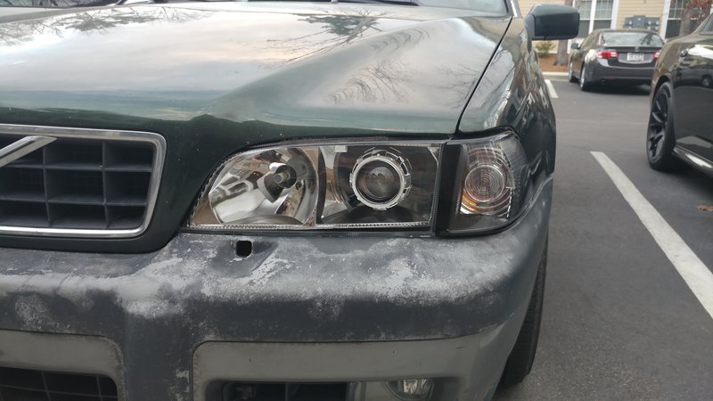

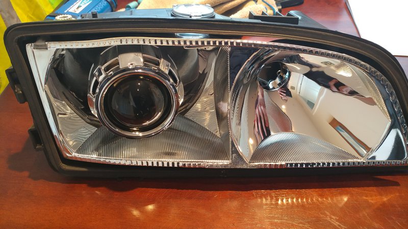

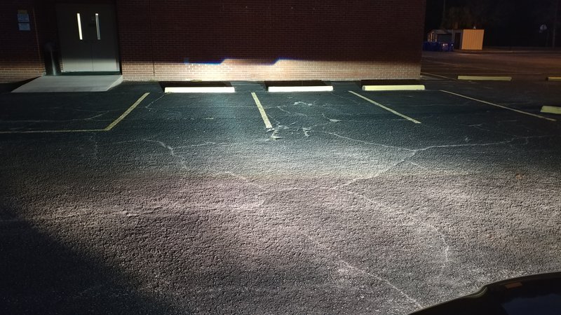

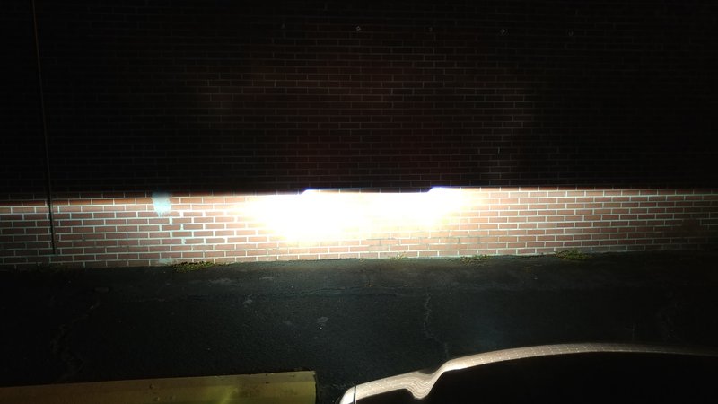

Hi Ed, Ed here.
You have a few options. Cheapest would probably be to replace the whole assemblies with some new aftermarkets and use normal bulbs. Please do not use any LED or HID lights in any of the stock halogen light setups. It causes light to shoot everywhere and cannot be aimed properly.
If you want the best light, do a projector retrofit. I got a mini H1 HID projector kit from "The Retrofit Source" as well as clear glass lenses (C70 lenses) and installed them on the stock assemblies. I can link to the kit I got, and to the store I bought the clear lenses from. A bit expensive... yes, but with the amount of miles I drive, often at night, I have no regrets. The results speak for themselves:
2000 V70XC - 340,000 miles

I have LEDs in there. They're super bright and because they're high-beams, I'm fine with the bit of light scatter. The projectors also act as high beams (they have a shroud that is moved by a solenoid when you activate high beams). So I basically have two high beams. When you're out on country roads at night with no oncoming traffic, the results are incredible. Also useful for waging photon warfare with the idiots who drive around with terrible HID low-beams.
