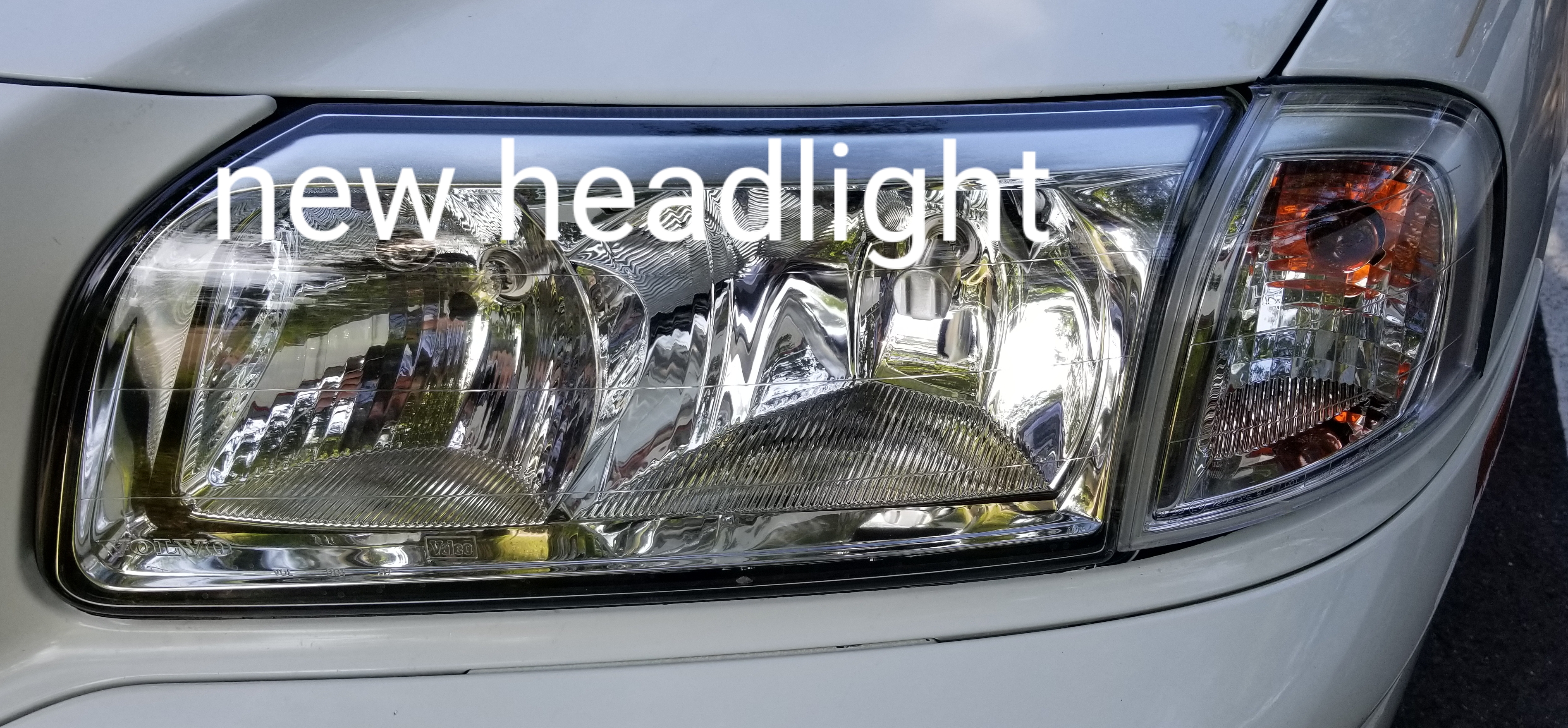

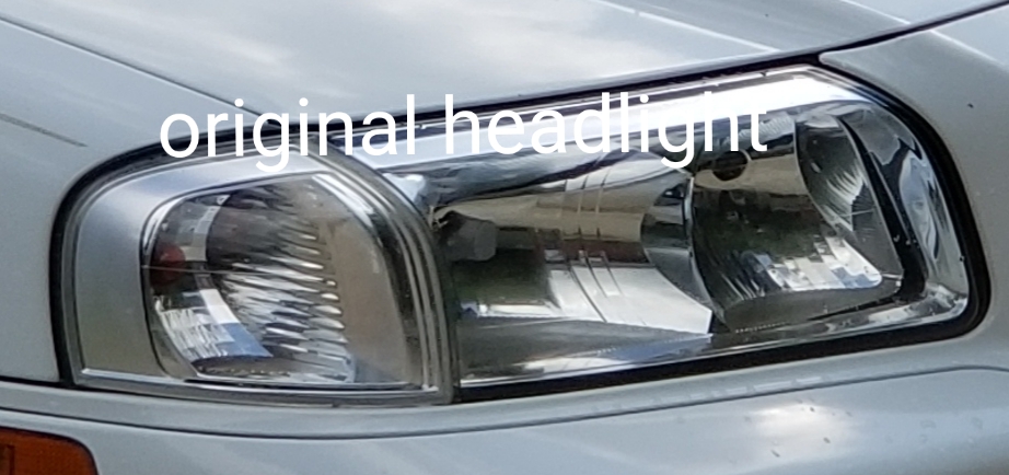

The reflectors burn out from the heat of continuous running headlights (daytime running lights) over years. 2006 should have glass lenses like my 2004. On my 2004 S80 I had my headlight housings replaced this year due to burned reflectors and it was a night and day difference. So rather than replacing the bulbs with some technology or bulb color you may consider housing replacement. I had Volvo replace them and attached turn signals at a total cost of $1,500 parts and labor, but several much cheaper aftermarket housings are available.
Notice the reflector of the new housing has a updated reflector design and how much brighter the new reflector is. Your car is likely suffering from the same problem. June

June those new updated lights do look much better design wise.

Looking at the pictures side by side the new turn signals have matching updated reflector design to match headlights. Volvo thinks of everything! LOL I love the new lights, worth every penny! JuneSuperHerman wrote: 28 Nov 2018, 16:40 June those new updated lights do look much better design wise.

That is night and day indeed. Tip: replace the amber bulbs with these chrome ones, looks a lot better imho and gets rid of the "fried egg" look. It looks like I already have the updated design in my car if I compare my pictures below.
