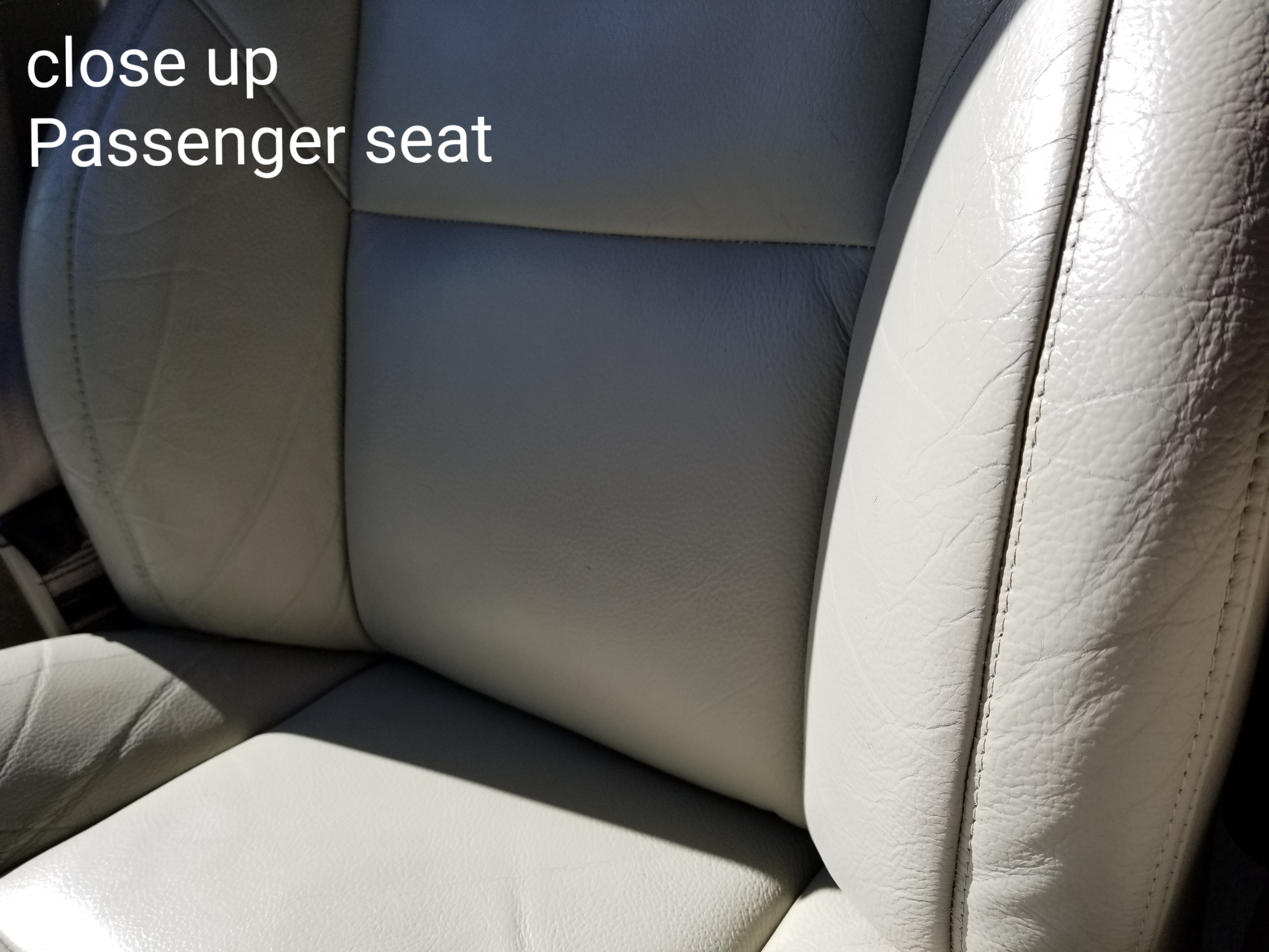

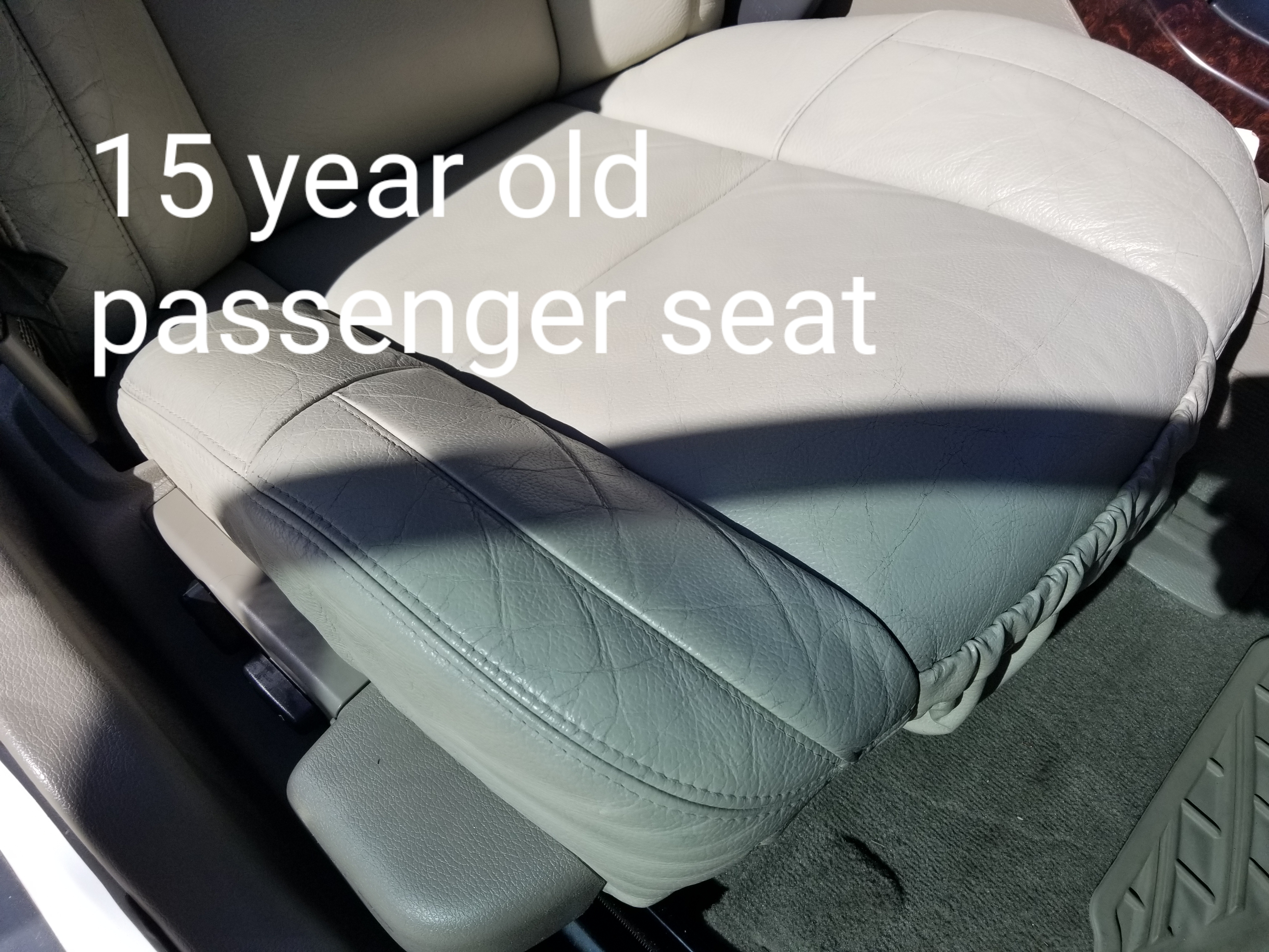

This is Wednesday day four after applying the leather oil. I applied three heavy coats on last Saturday on all the original leather. The seats are amazingly softer and the product gives a light scent of new leather. Seats are long dry as all the oil was absorbed on Sunday. Today the car sat in the morning sun for the first time after applying the oil and heat seems to have made the leather softer. This product is simply amazing! I took some photos of the leather today so see for yourself! June

This is Saturday and though no additional oil has been added since the three initial applications last Sunday the softness/pliability of the leather is better than Wednesday when I last updated. The surface is dry to the touch so obviously this product continues to work internally below the surface. No other product did this. I will take photos at the next application because while the product is wet on the surface the dark lines and cracks appear like the leather is ruined. Then a few hours later they disappear with the product.
