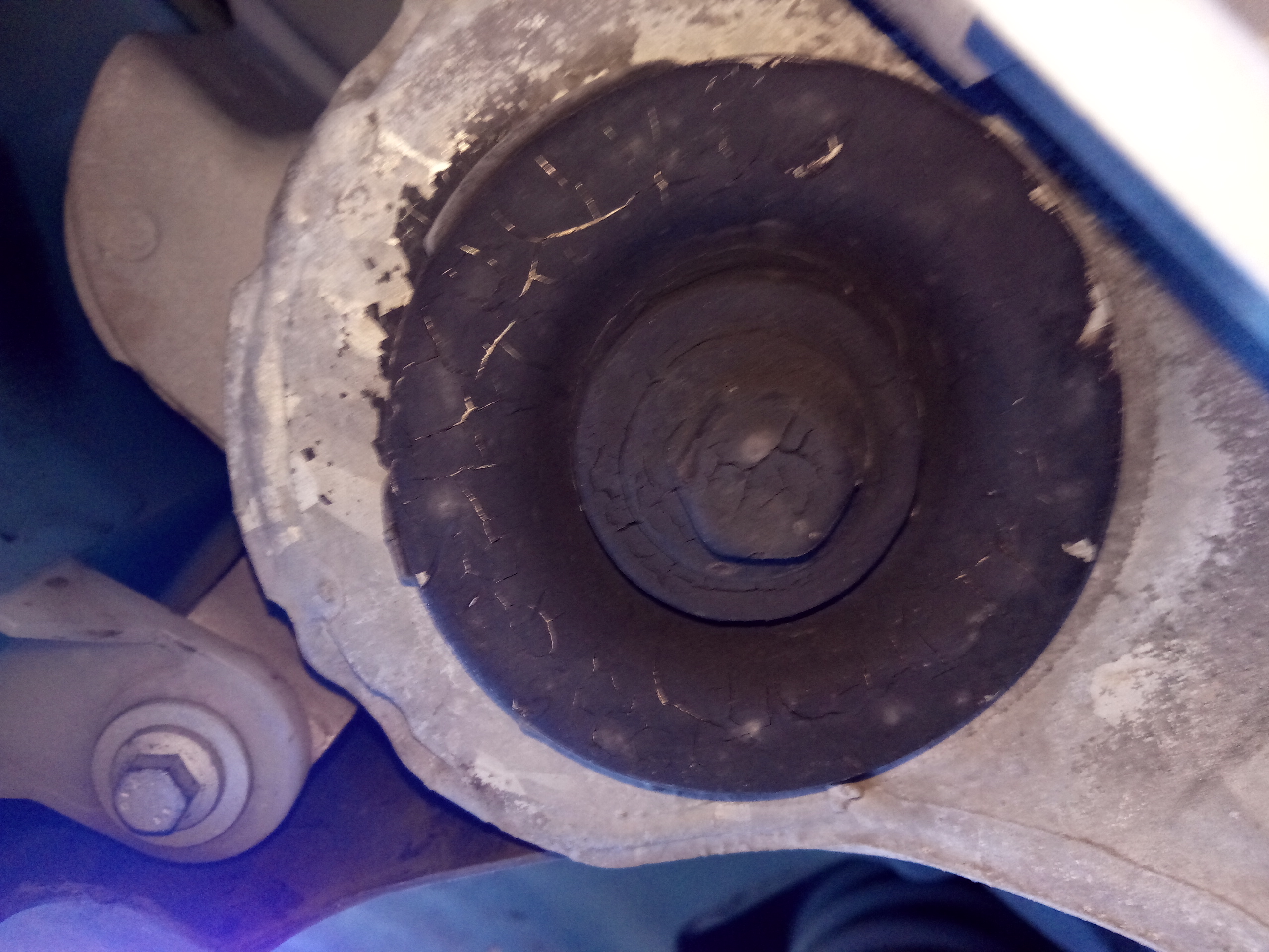

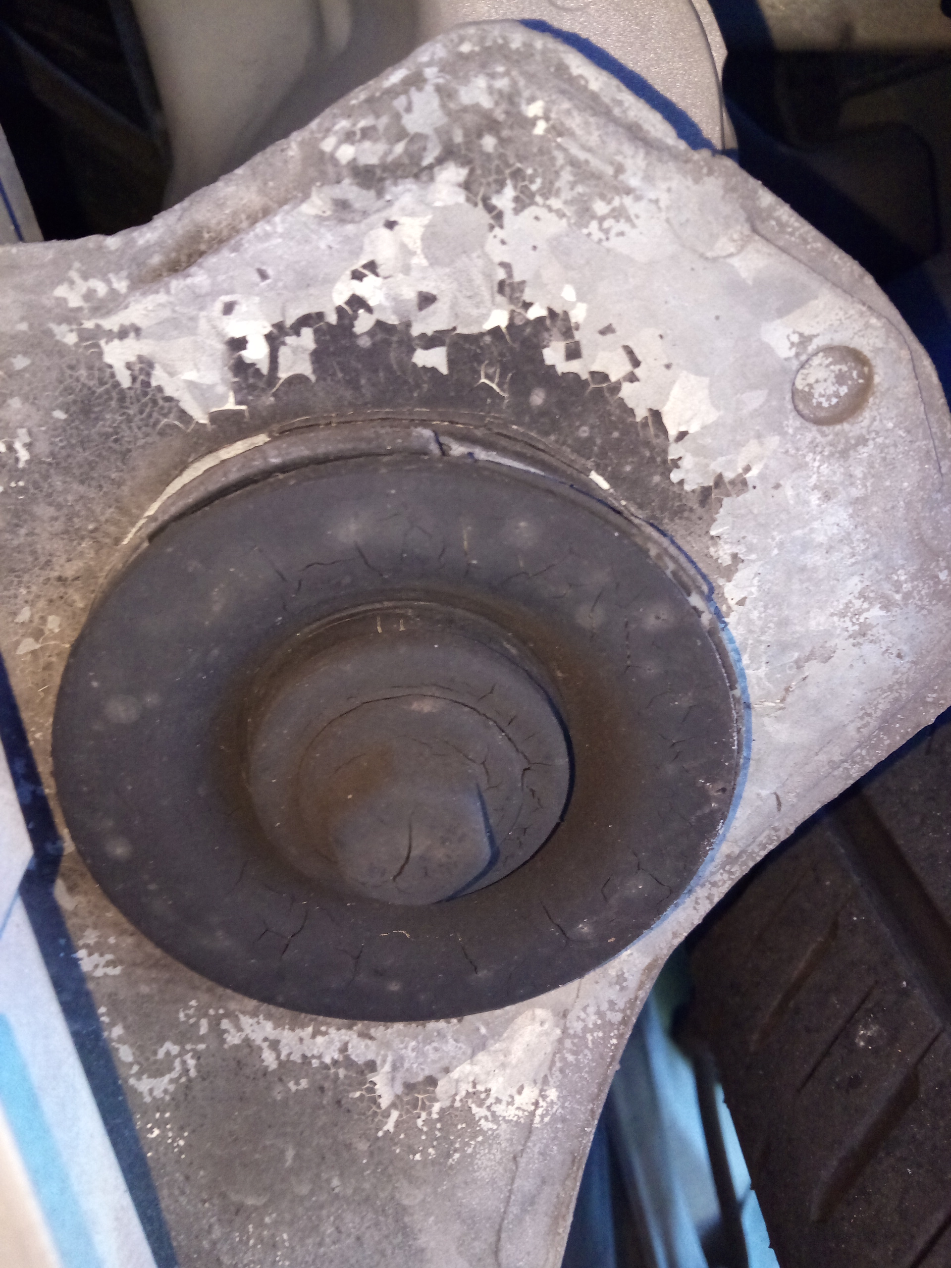

I don't know if these are called bushings front right and left.I think I need to replace them and which make should I get.
2007 XC 90 Front bushing

From your pictures I cannot tell what the part is. It is too cold outside to look at mine.
Can you take a picture from further away so that part identification can be made?

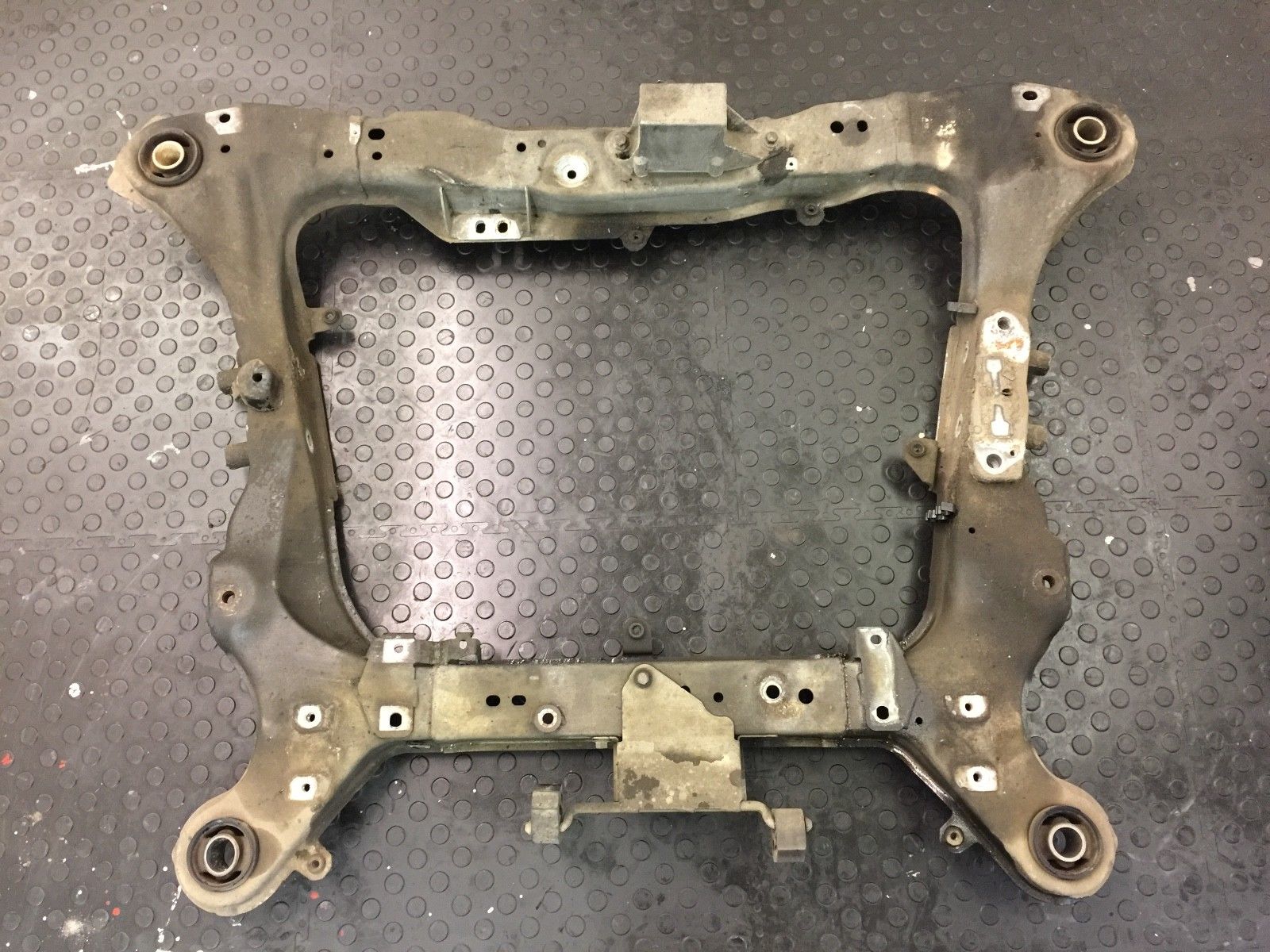

I had a feeling your first photos were of the subframe busings, but TX undercarriage age differs than MN.
Usually the subframe bushings last a long time, but in Houston I have heard the heat does cause them to age quicker.
What are your symptoms other than they look aged?
The bushings actually don't look that bad - what I see is cracked undercarriage paint of the really large painted black washer. The washers cover the actual busing. You can see this in your last photo of the engine cradle subframe.
You have three options 1) leave them alone, 2) install some IPD inserts, or 3 replace them (which is not that easy).
