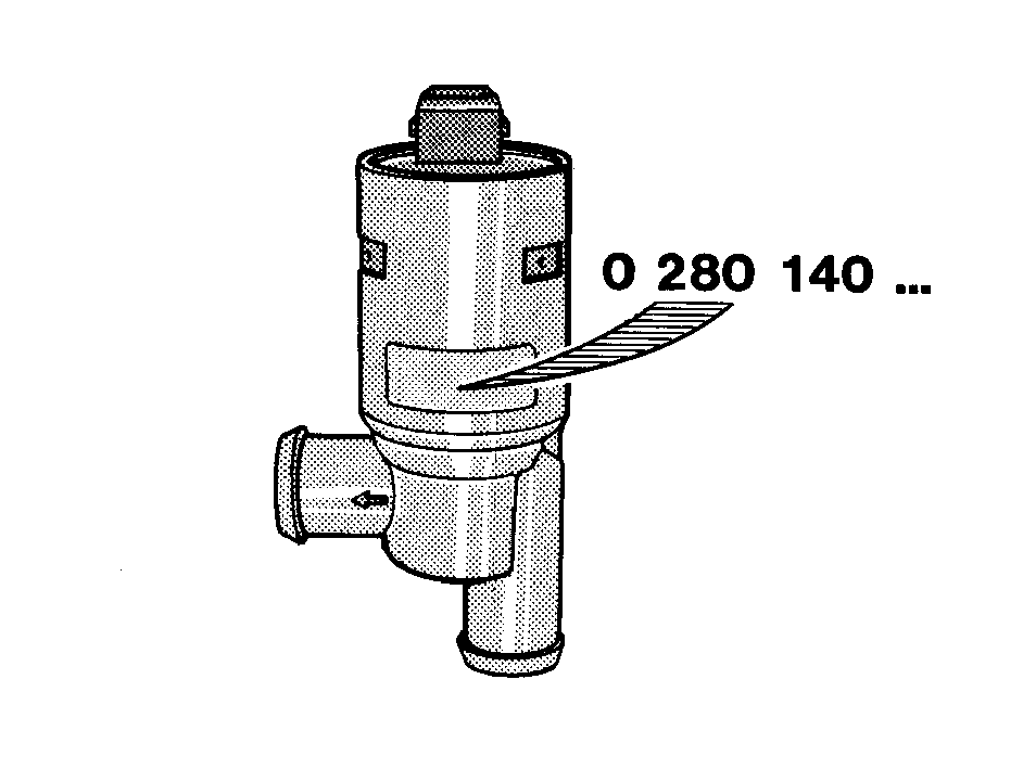

Idle air control valve (IAC). You might try cleaning out the IAC with MAF sensor cleaner or Carb cleaner.
It could also be leaks in the intake manifold gasket that seals up when the engine warms up. You can locate intake manifold leaks with starting fluid. Spray the starting fluid around the intake manifold gasket when the engine is idle hunting. A leak will suck in the starting fluid and you will hear the engine surge.
