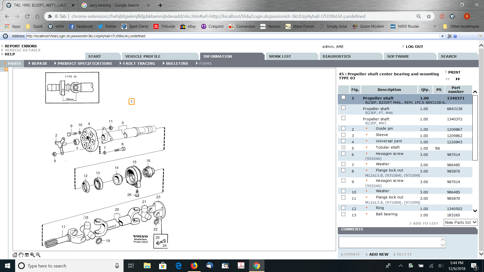

While changing the support hanger I lost track of where the thin cups go
Anyone know where such a parts diagram is located with excruciating detail?
Thanks>

Rick Thanks however I failed to mention the 'type' of which this illustration is type 3. I need to find replacement for 12 and 14 which are presumably the same however the google image doesn't transfer scroll function to see 14, and on other types may be different. Anyone know a direct link to volvo parts images which aren't a browser copy? Thanks

driveshaftparts.com has the 1340501 center support complete for $30. Not genuine Volvo but if it lasts half as long then that would be 12 years and a gob of miles.
It is VERY important that you slide the two piees of shaft back together in exactly the same place. It may be marked but if not then add some marks. The driveshaft is balanced and it needs to be phased correctly for U joint function with no vibration but it needs to be put back where found due to the balancing.
