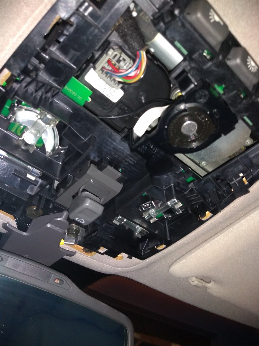

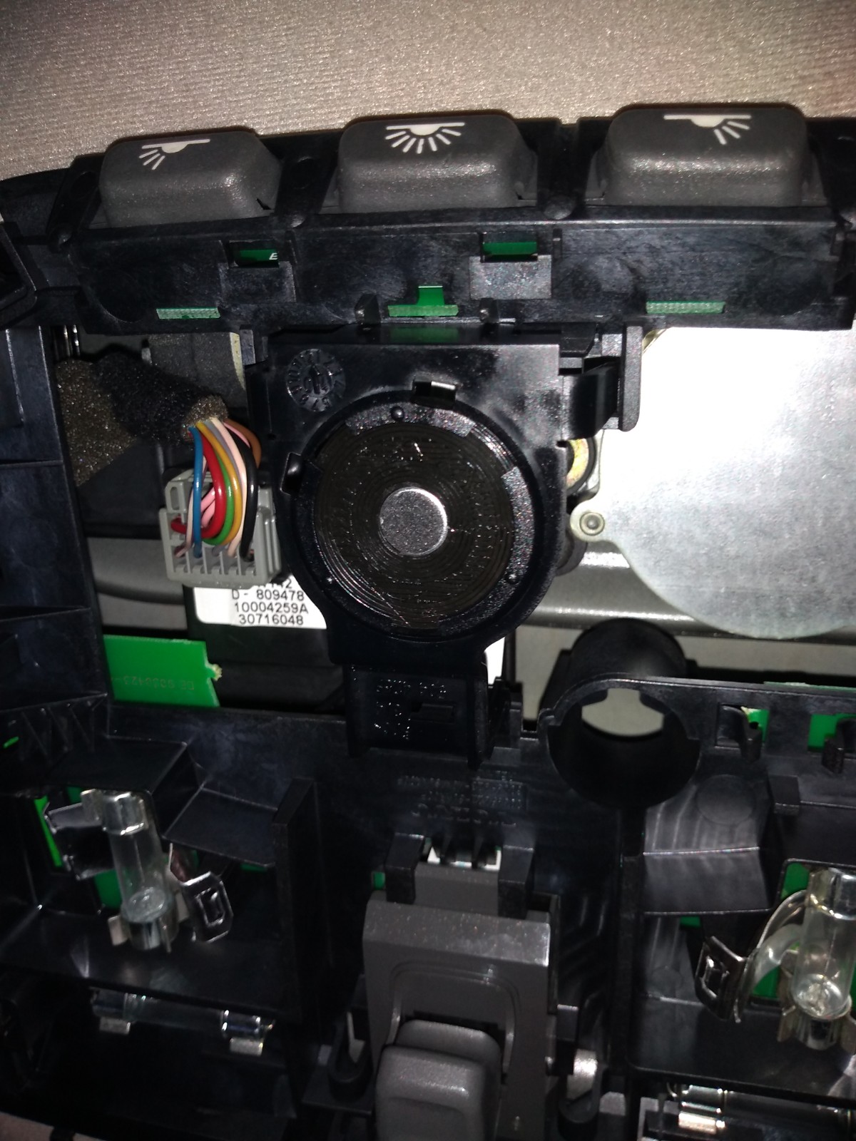

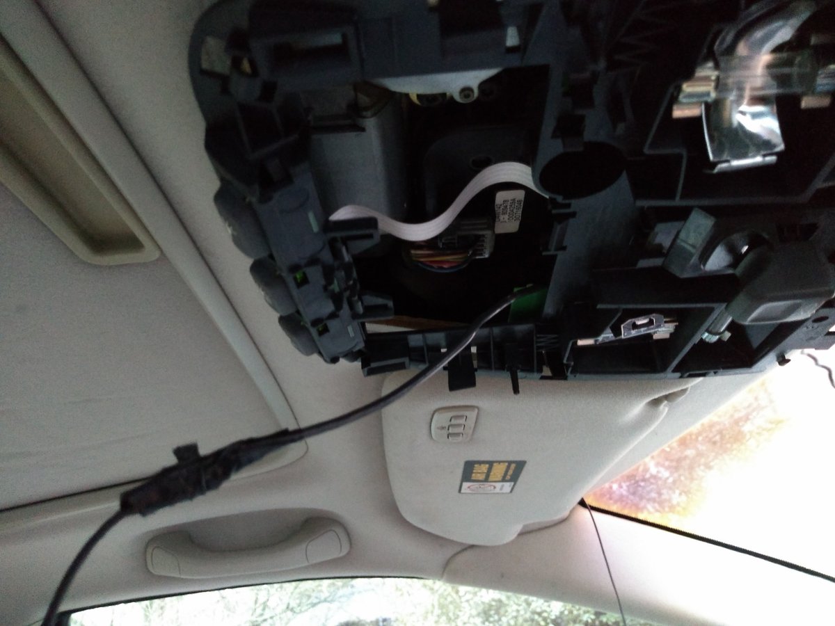

Few months ago I installed an Android HeadUnit radio with all the modern infotainment features, including hands free calling. Problem is the microphone hangs from the headliner and looks bad. I remembered early versions of the S60 had a built in phone option and the doom light still has a mic grill, so I opened it up to see if it was possible to install the mic there.

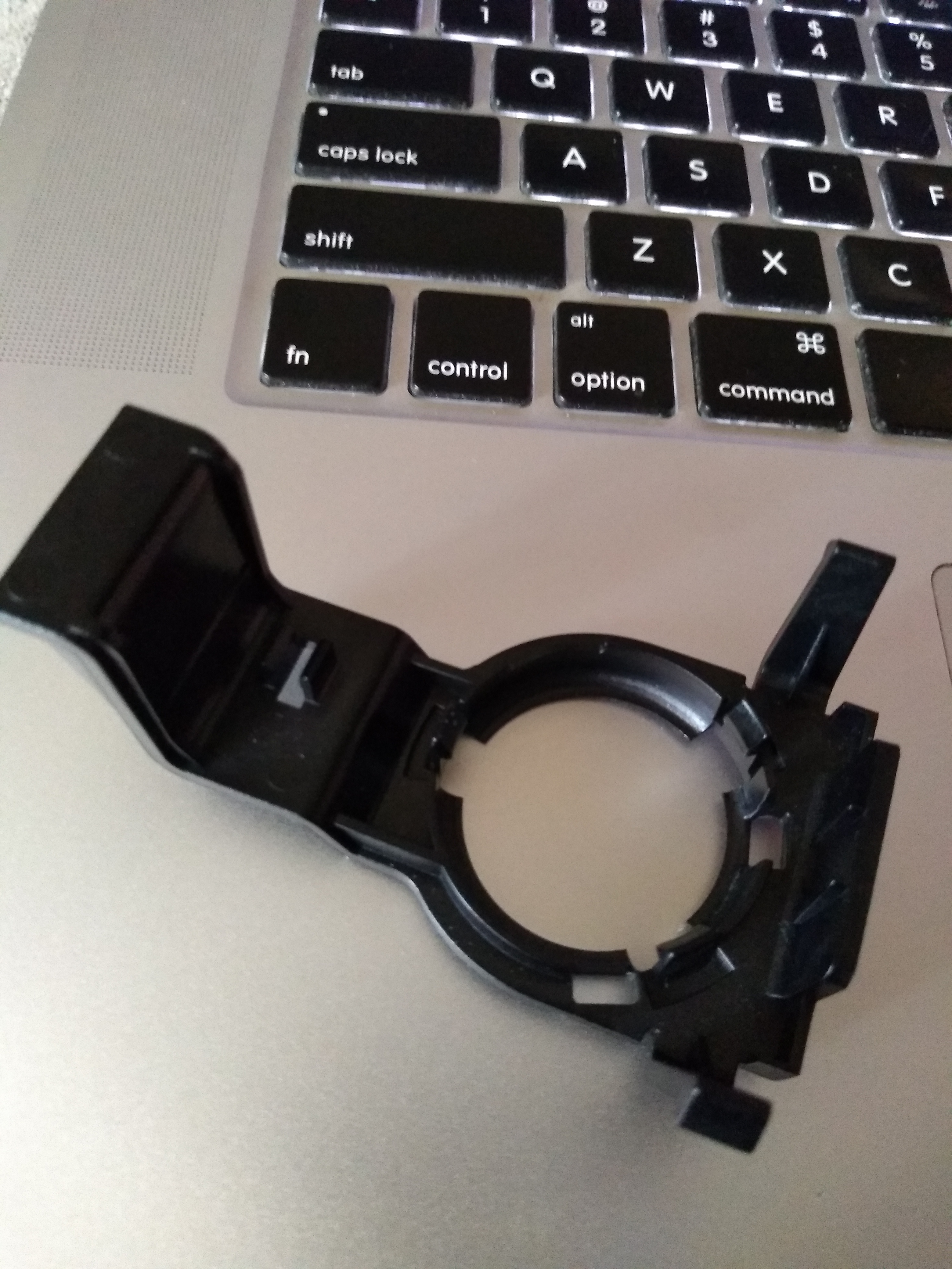

Found the old microphone holder

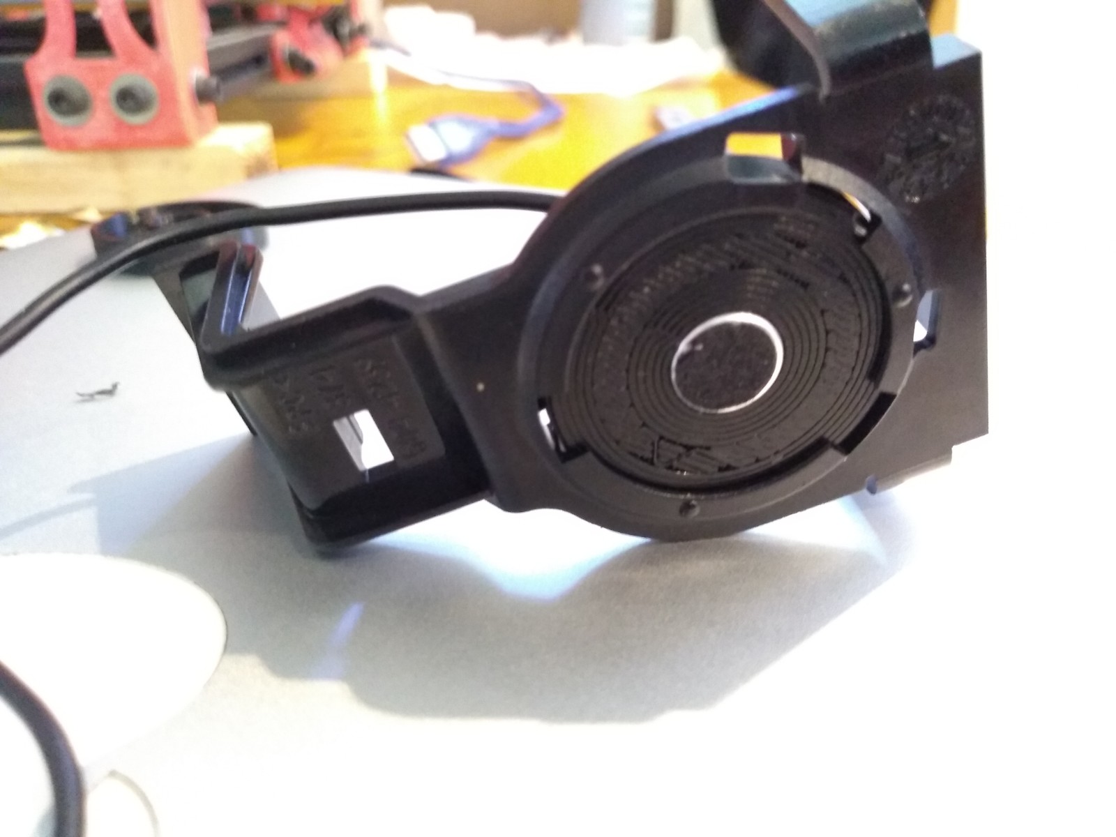

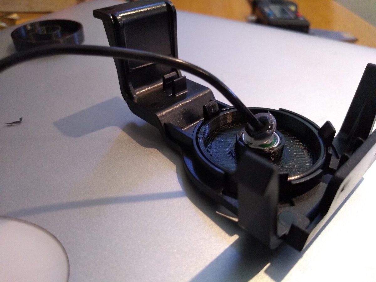

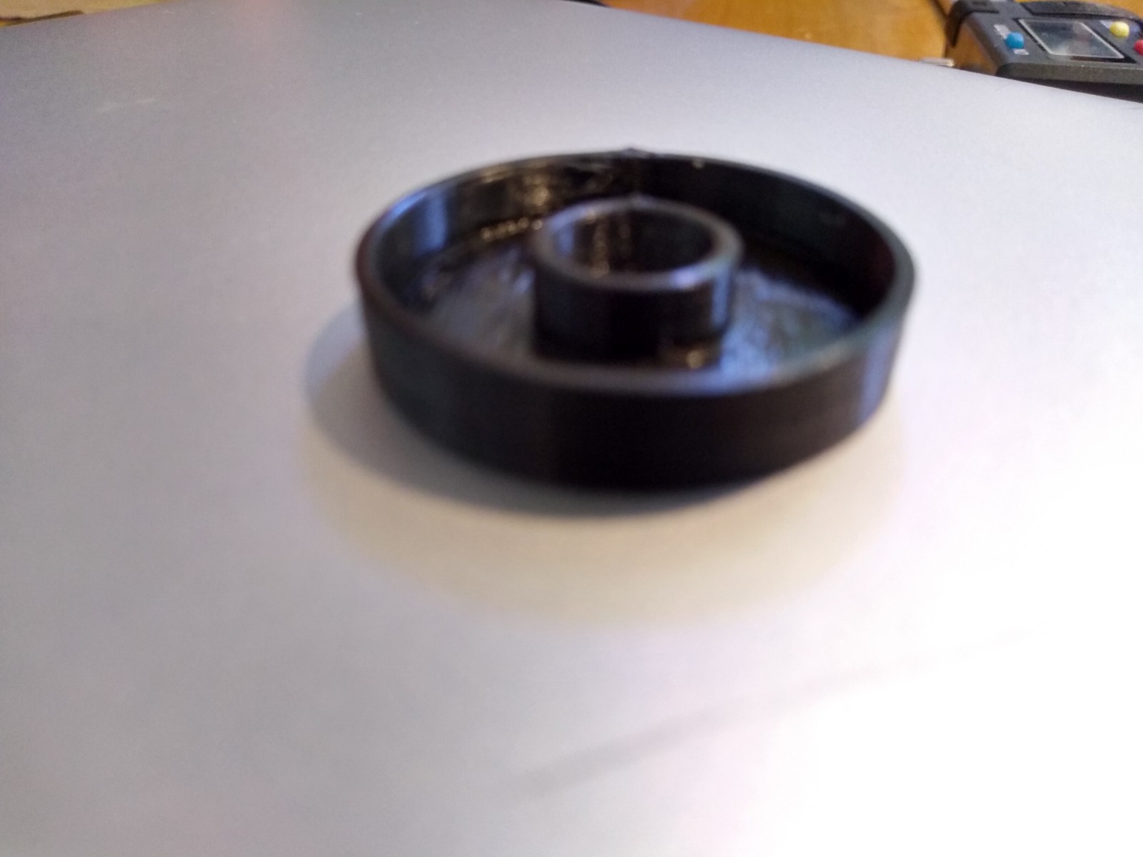

Just needed to figure out how to install a mic, luckily I have a 3d printer and created this.
Fully assembled, w/ mic. The hot glue is for strain relief so the wires don't break due to vibration. The mic is the one that came with the head unit, using wire cutters I removed the mic from the plastic boom.

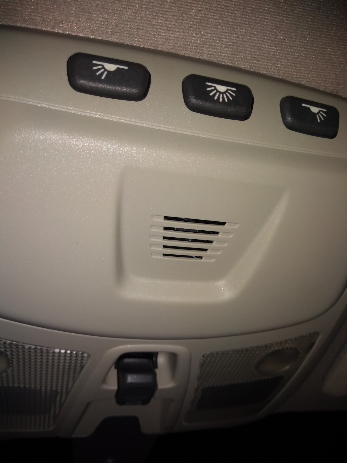

Got around to installing it this evening. Looks OEM!!!

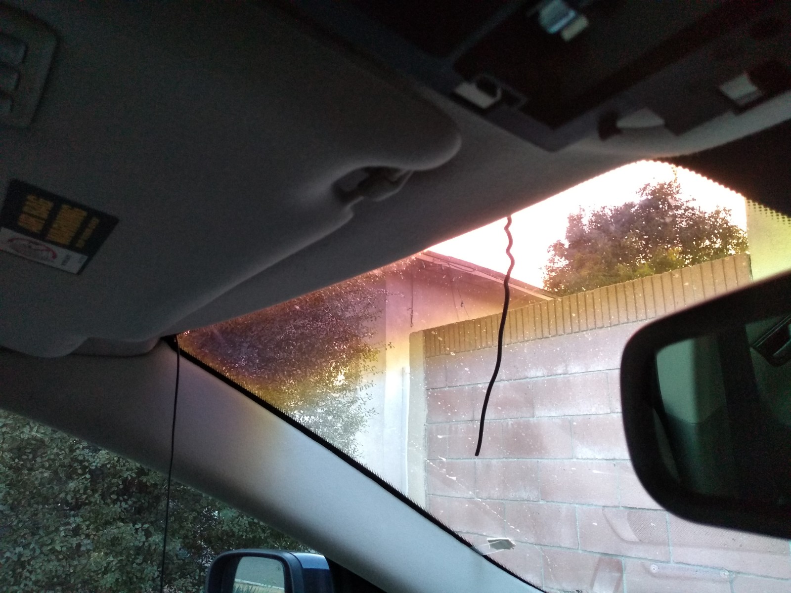

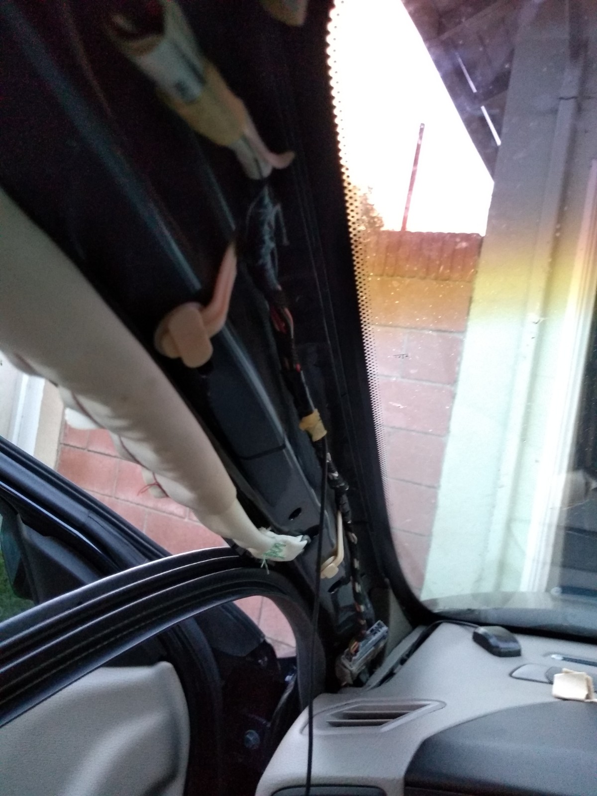

Installation wasn't to difficult, I had to loosen black doom bracket to feed mic wire. Using a 12 gauge solid wire I fished the wire through to the windshield and then taped the mic wire and pulled everything through.
I removed the A-pillar to run the wire down behind the dash. OrageX has a great instructional video https://www.youtube.com/watch?v=X2fi1r9eZQA. Every few inches I taped the wire to the existing wire harness.
Finished look!!
