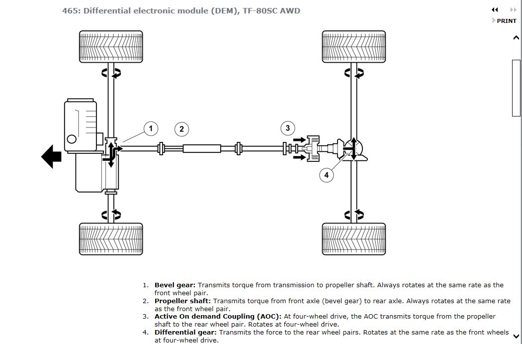

I'll look forward to someone trying to explain this. FWD car with a bevel gear to transfer power to the back, engagement of rear differential controlled by a wet clutch as a function of front wheel spin.
See diagram-
edit 121218- Replace diagram
