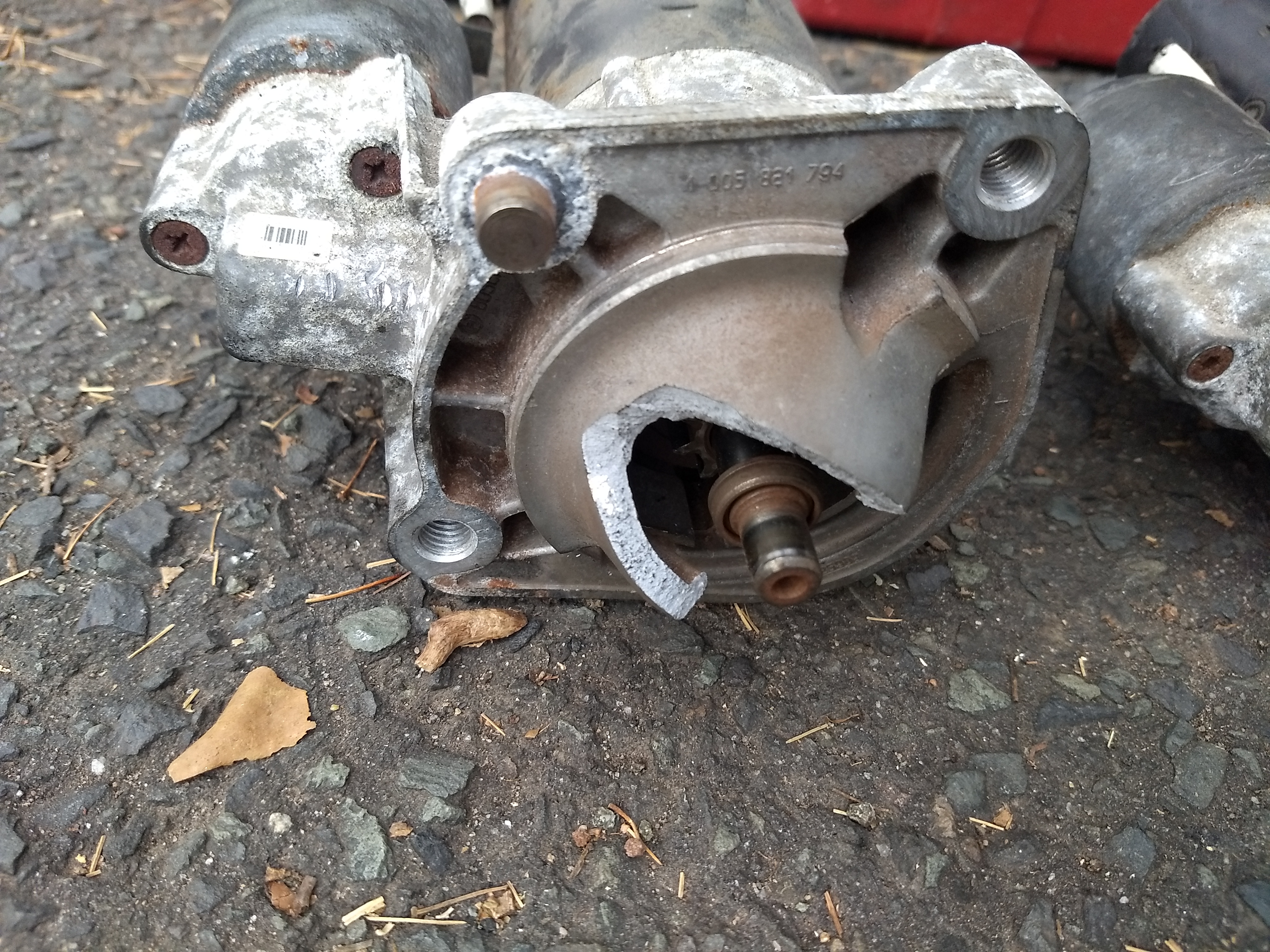

Well, I figured out why the starter had made the spinning sound in the '99 V70 XC AWD. It wasn't a bad bendix. The flywheel has a few mangled and missing teeth.
With the starter motor out, I popped off the right wheel and turned the engine by hand. I couldn't see clearly but managed to take a video of two full revolutions.
Is a new flywheel pretty much the only option?

Ouch, that doesn't look good. I don't think there's an option other than a new flywheel.brunocerous wrote: ↑14 Dec 2018, 17:21 Well, I figured out why the starter had made the spinning sound in the '99 V70 XC AWD. It wasn't a bad bendix. The flywheel has a few mangled and missing teeth.
If you want to replace it, I have one in the shed from my V70 with good teeth! I'll double check, but I'm pretty sure it's the same for the 4 speed auto.

Whoa, that would be great!
But what would cause such damage?

Bruno...someone managed to crank that puppy while running , which is quite an achievement.remote starter maybe?

When I took off the old starter, I fished the missing piece of the bell housing from the flywheel. Breaking that piece (not by me, I don't think) was quite an achievement!

Ouch, somebody really did a number on that flywheel and starter!brunocerous wrote: ↑15 Dec 2018, 05:12 Pleats! That almost made me spit out my coffee!
According to the parts diagrams the flywheel I have should be compatible with your XC, I'll double check in a little bit to see if there's a number on mine. Just let me know if you want it!
