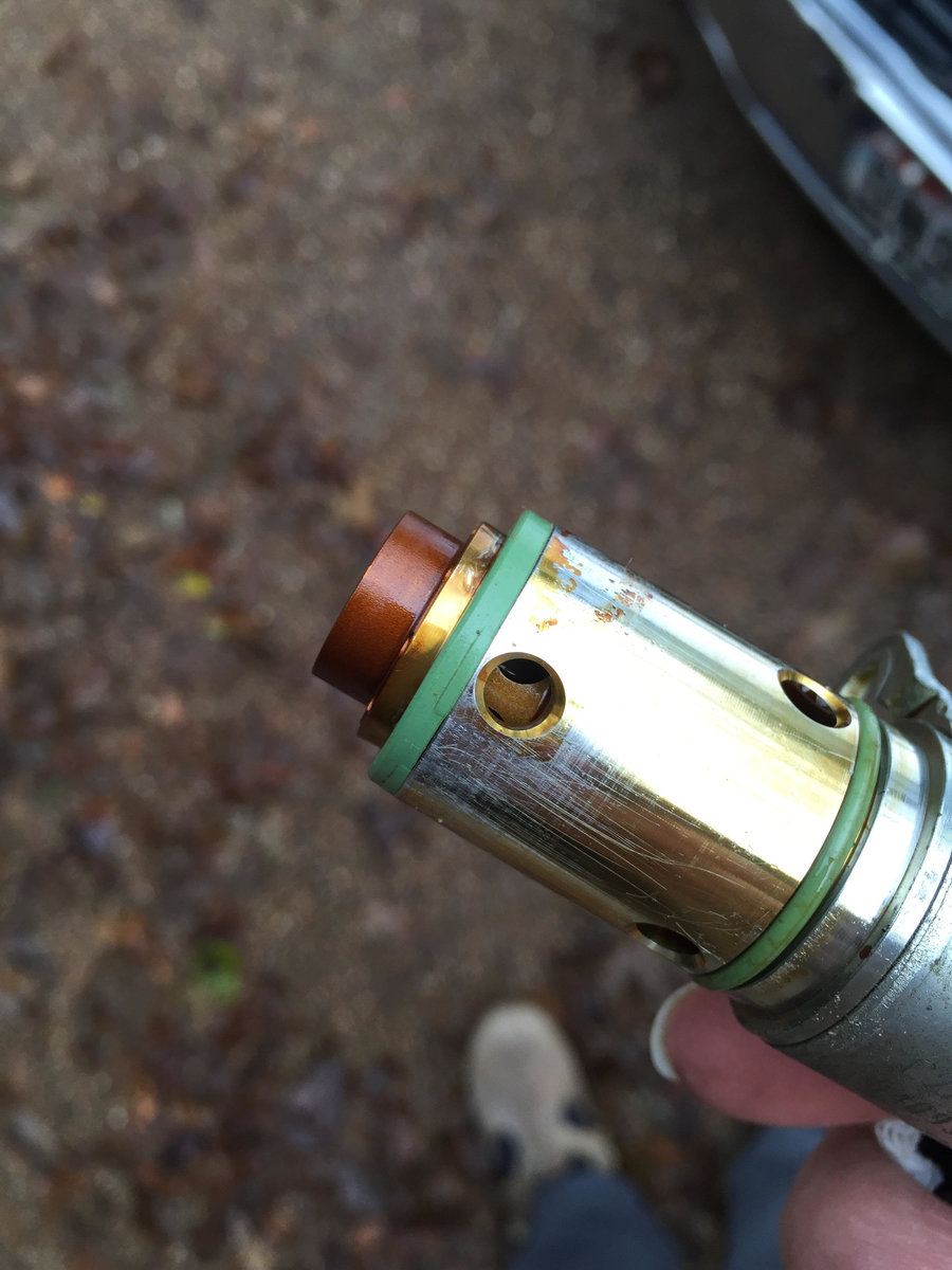

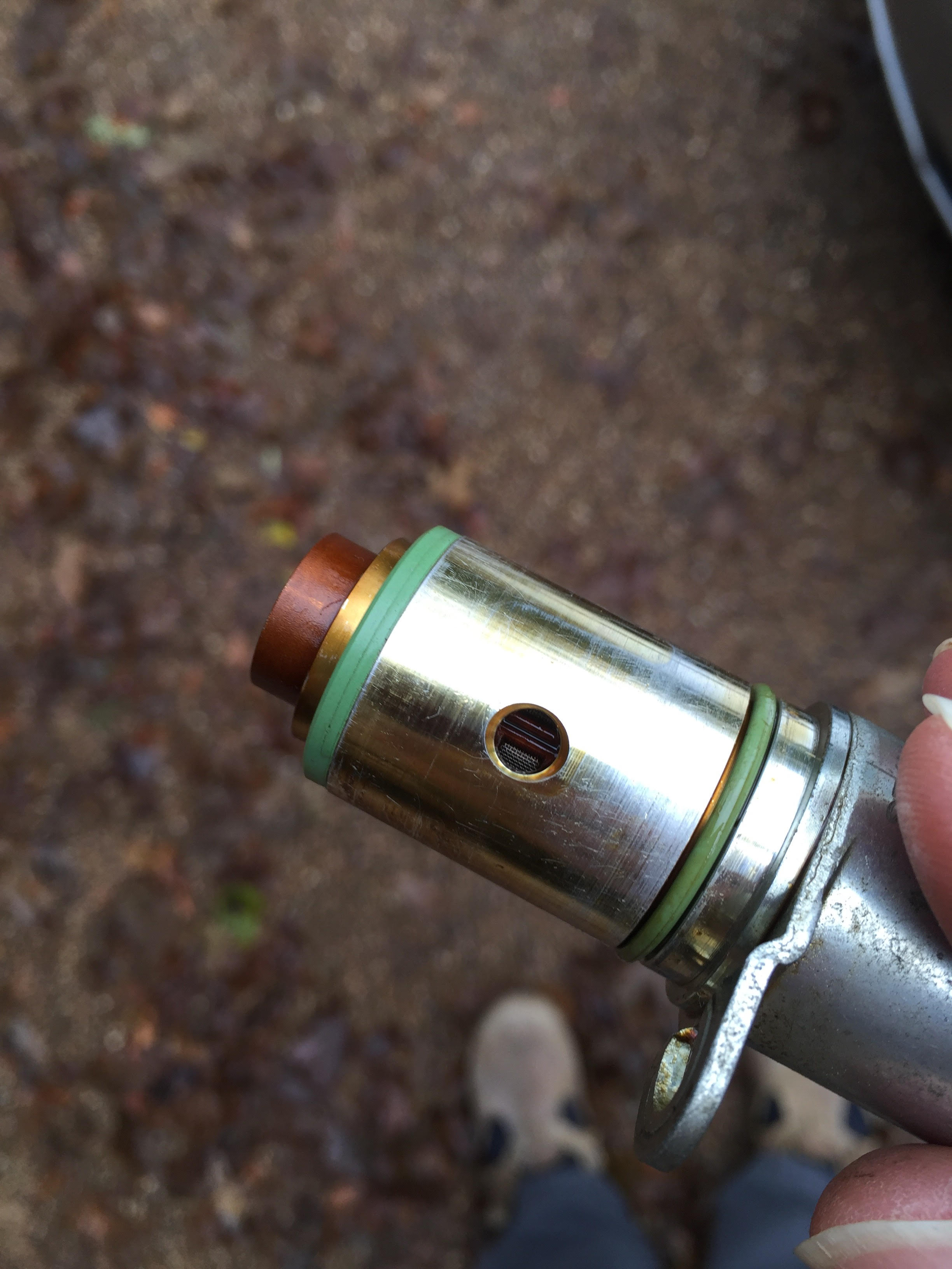

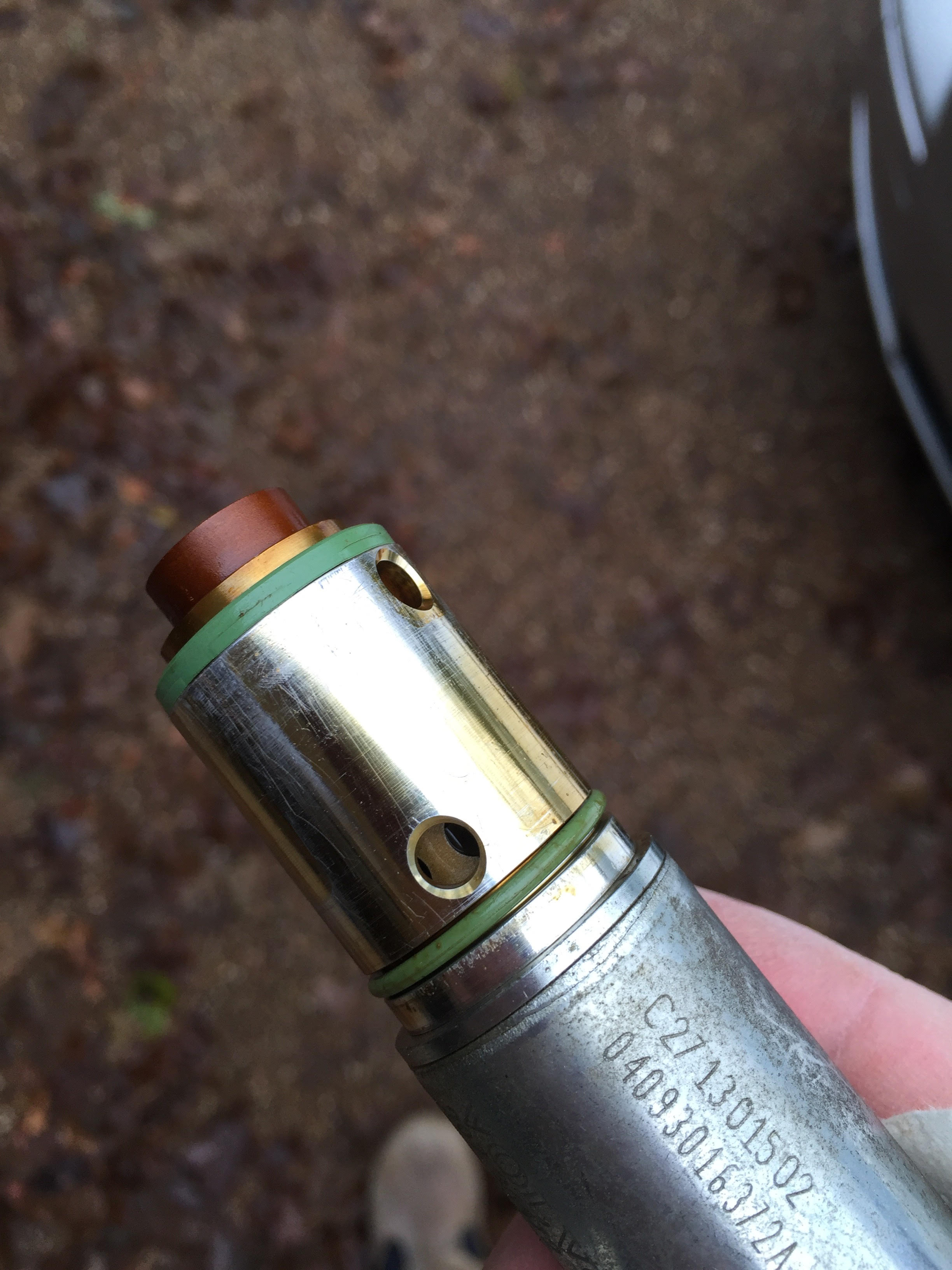

In looking at the VVT solenoid, I noticed that the holes in the outside of the body did not line up with holes beneath the outer layer, as if the whole outer jacket were twisted out of alignment (see photos).
Are these holes supposed to be aligned? It seems like (theoretically) a misalignment could be causing a buildup of oil pressure that might result in my leak-- but that's only my theory.

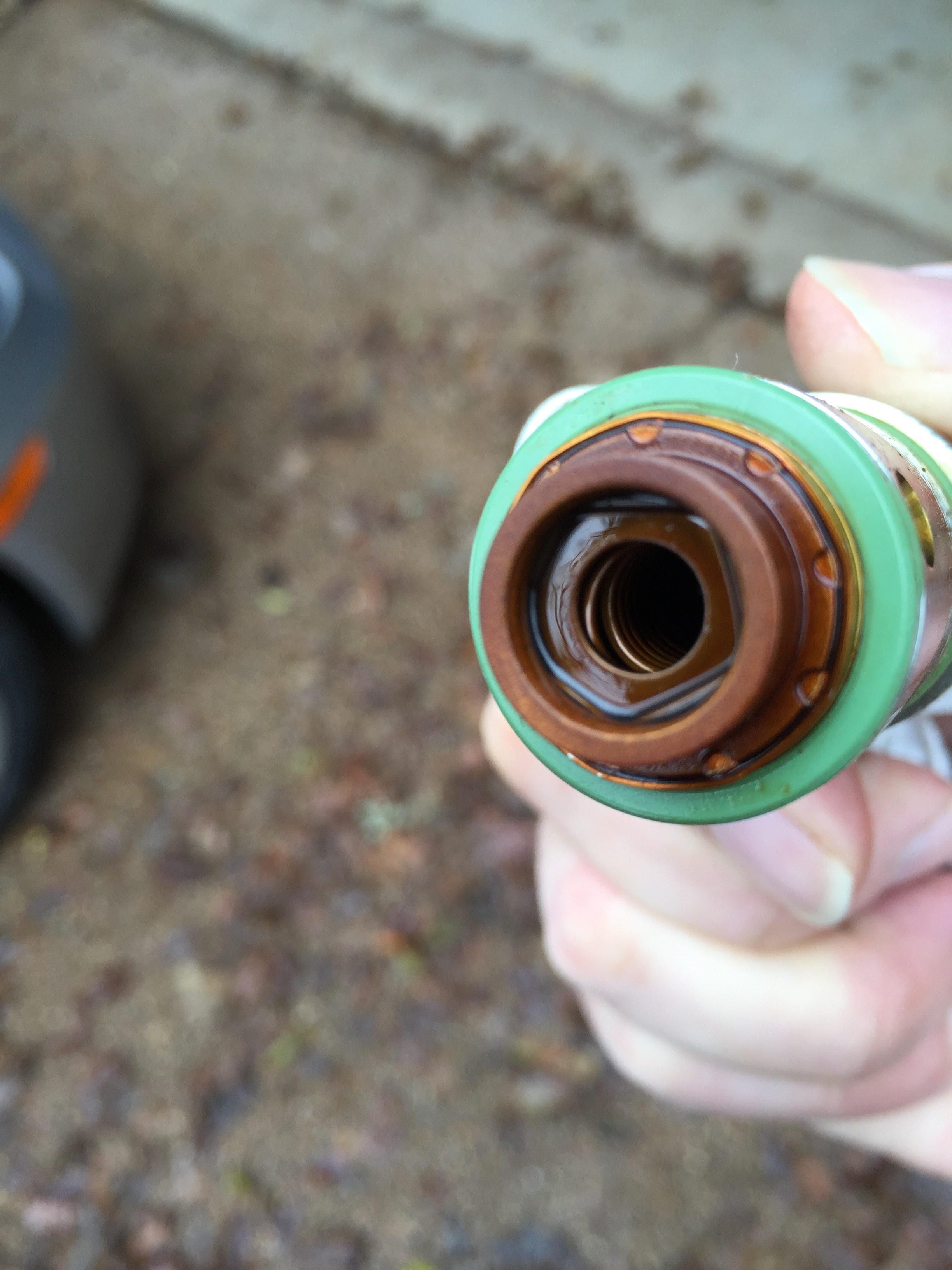

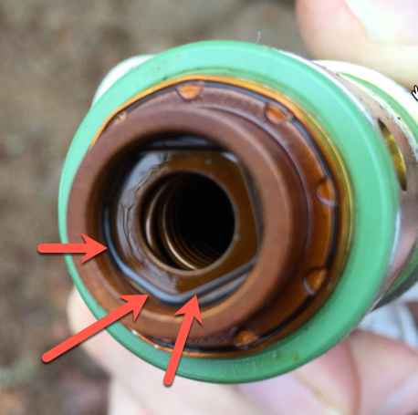

Also, I have not yet disassembled the solenoid-- since the 12V test moved the plunger i decided up till now to leave well enough alone. But actually looking at the solenoid, I don't even see any obvious way of disassembling it-- the only thing that looks like a possible "wrenching point" would be the 9 dimples in the ring visible in the end view. My solenoid setup is different from the one shown in your link on cleaning-- mine goes into a bore made directly in the head casting-- no separate removable holder casting like shown in your "instructions" link. Instead it has the smooth metal cylinder/sleeve still surrounding the plunger-actuated "business end" of the device, and its not clear how to get that metal sleeve off.

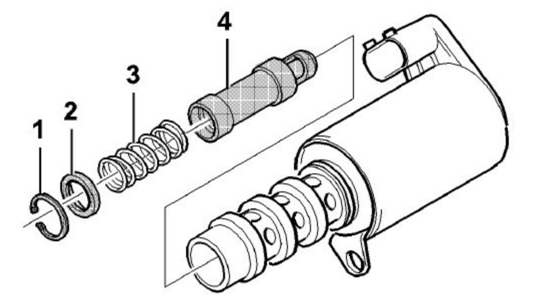

I don't know anything about these cars or that part.
However, take a look at the link that RickHaleParker pointed you to.
In step 3 (VVT solenoid: cleaning) it says:
Remove :
snap ring (1)
washer (2), spring 3, and plunger (4)
Those numbers correspond to this diagram.
#1 is the snap ring and I think it is visible (maybe??) in one of your pictures.
I'm guessing that is the snap ring only because according to the parts diagram, nothing else should be in front of the first washer.
Again, I don't know anything about these parts. Only deducing based on parts diagrams and your picture.
