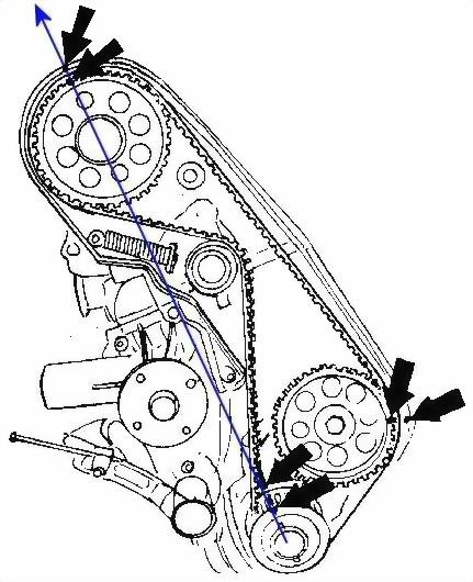

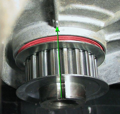

waynegarbo wrote: 18 Dec 2018, 15:20putting the pulley back on, should I snug it, then put the belt on, then tighten it?
Bolt requires about 37 ft-lbs torque....In your situation, I'd install timing belt, then maybe have someone hold cam with vise-grips clamped between two holes, so that a downward force would be used to hold...palm on top side of vise-grip...pressing downward..
IIRC, another way, take the old timing belt, wrap it around the cam's teeth, then vise-grip both ends of timing belt; if vise-grip is on left side, and wrench is on right side, one can exert downward force on both sides. Myself, I don't use a torque wrench since 37 ft-lbs via 1/2" break-over bar is something I have a feel for. YMMV.
A person could fabricate a counter-hold tool

Two things: vice grip all the slack, then anchor the belt with my left hand? wouldn't a shorty wrench counter leverage with my right hand since my left is not able to help?

waynegarbo wrote: 19 Dec 2018, 10:17shorty wrench counter leverage
37 ft-lbs torque - Generally, one uses a smaller length 3/8" ratchet, and its a firm pressure...YMMV
Yes, grab the slack, then clamped down vise-grip....both hands are pushing downward....been there, done that.
