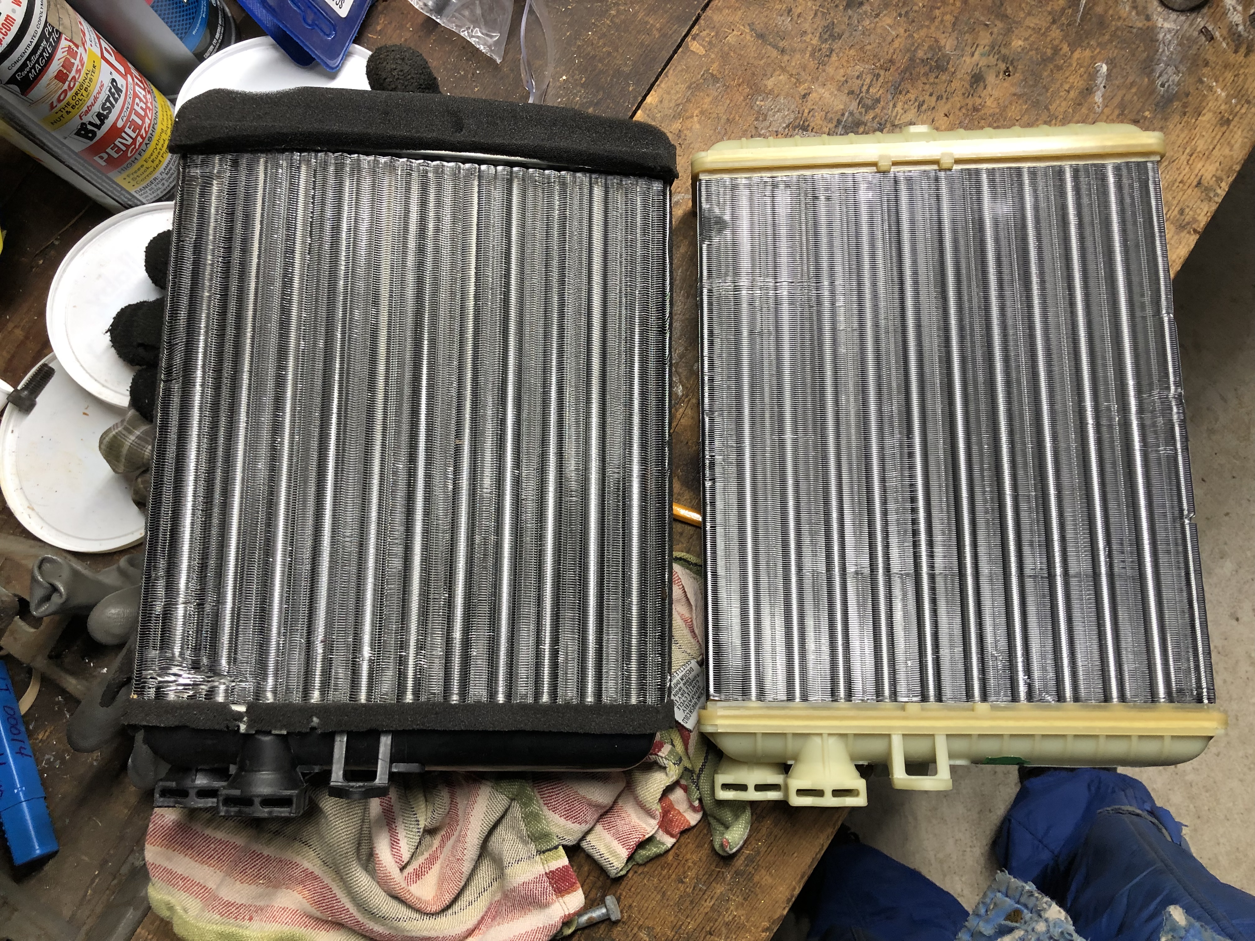

I replaced the core today. I put some additions to others' notes in the post at viewtopic.php?f=9&t=84522
I think the core was the problem. it flowed great but had poor heat transfer. Once I finally got it out, I compared it to the Behr core that I had bought. The Behr core has twice as many cross tubes, and they are smaller diameter. The previous core has 11 tubes on each side, all in a line. The Behr has about 22 staggered ones on each side, for a total of 44.
So I think the advice to get the Behr core is good.
The other one I believe came from ebay, but had no manufacturer's markings. It might be OK for a mild climate but really didn't cut it in Wisconsin.

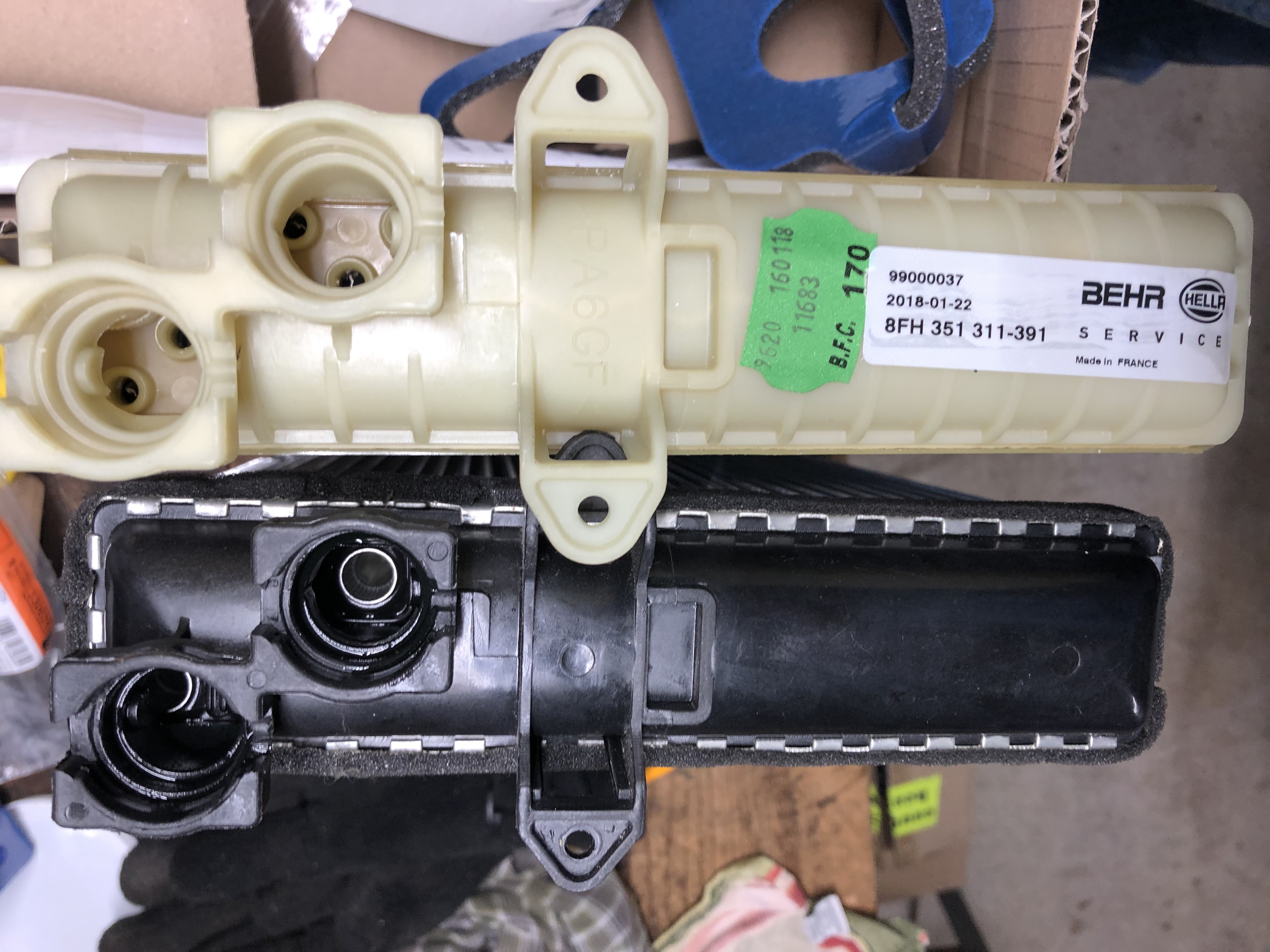

Yes! Heat is back and strong like I remember it used to be!
It took a long time to decide to change the core since it wasn’t obviously bad, but clearly it didn’t have the same heat transfer properties as the OEM one. Here are photos for comparison.
Note the different size and number of tubes, visible through the ports.
