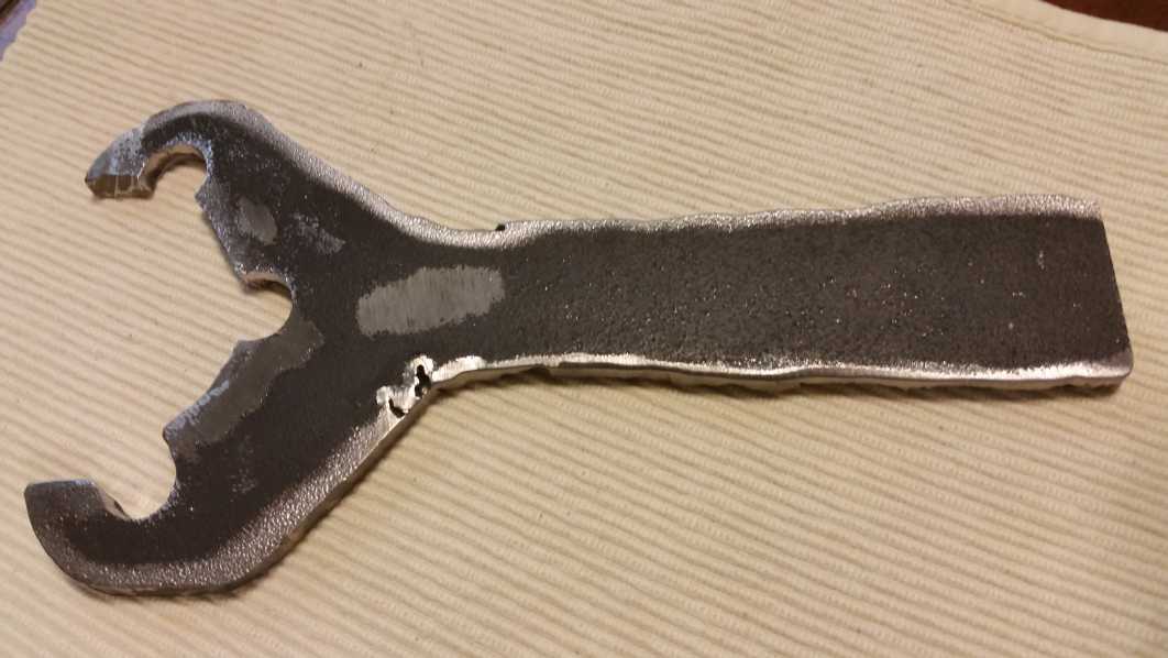

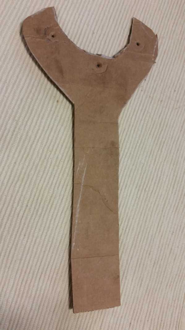

I removed the drive-shaft, and as it freely spun, I needed the volvo tool. I made one.
Cut out a cardboard around the needed shape [like a Y] and tap on the socket head screws to indicate where the holes are needed.
Lay this template on a piece of steel, and punch through the middle of the impressions to mark hole locations on the metal [I used 1/4 in plate steel]
drill them with a 1/2" drill, cut out the rest with a plasma cutter or other grinder/saw. [2 pictures] I also had to remove the bevel gear and the sleeve and bevel spline were both stripped.
I decided to keep the bevel gear out of the car. I was worried the sleeve would come out, but it did not budge and likely would have to be forcibly removed. I added an insurance policy of a small bracket that uses a bevel gear bolt hole, and extends over the edge of the sleeve. If it slips, I should hear the grinding, and know im in trouble. I have a few hundred miles so far without issue.
