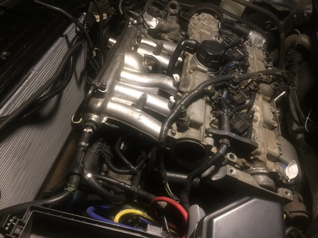

Removed the throttle body and throughly cleaned outer surface of intake manifold. It is back to silver and shinny, doesn't look old at all. You can hug it tight wearing white shirt. What is the color of intake in R-Design, Ferrari Red?
The under surface of intake and throttle body was wet with engine oil. Wetness was visible inside the intake where throttle body is mounted. Where is this oil vapor coming from -- excessive?

My intake manifold was also lined with fresh oil. To my knowledge it indicates the narrow plastic PCV pipe is doing it's job and not clogged?

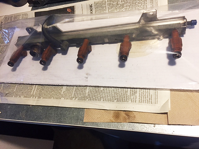

The fuel rail with injectors is yet to be separated and serviced -- keeping dirt away.
I've picked up replacement Volvo o'rings.

Intake looks new after simple green scrub.
