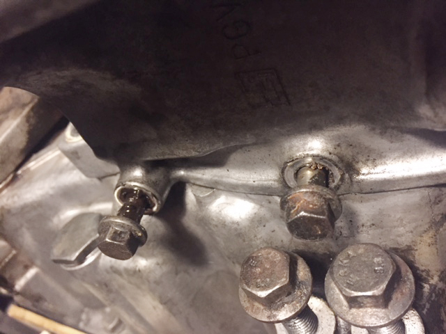

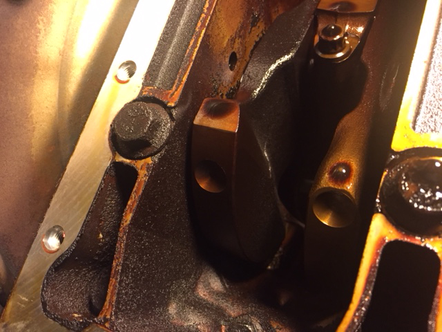

One of the four long oil pan screws on transmission side is soaked with oil.

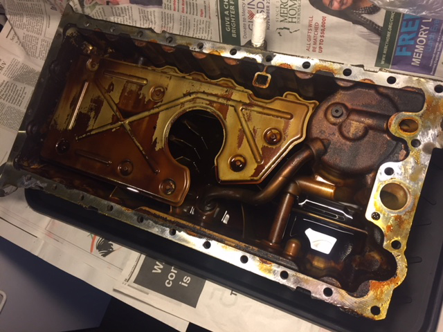

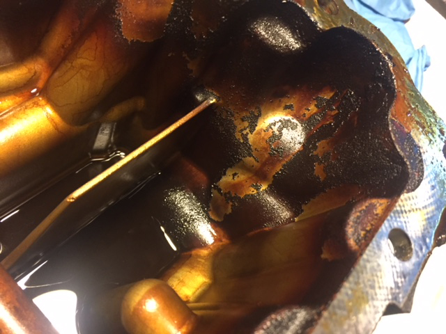

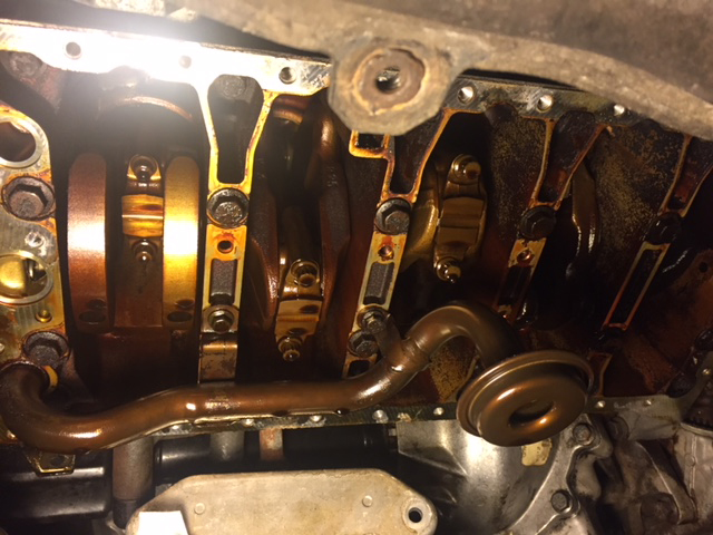

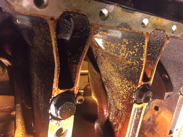

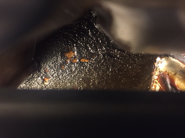

Your thoughts on build up, cleaning, future oil change interval, and...?
Posts: 36149
Joined: 17 Feb 2013, 17:54
Has thanked: 1610 times
Been thanked: 4068 times
Not bad at all - how many miles?

Looks pretty decent for vehicle of it's age. When I drop my pan I'll first pressure wash it. I'll then scrub it down with denatured alcohol.
If you want to use Simple Green then dilute it and rinse it off that aluminum pan as quick as possible.

abscate wrote: 27 Dec 2018, 14:08 Not bad at all - how many miles?
190,000+ miles.

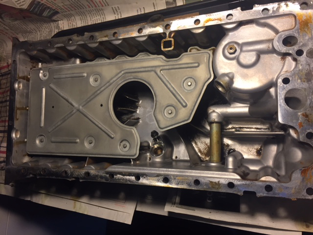

XC70Rider wrote: 27 Dec 2018, 14:47 Looks pretty decent for vehicle of it's age. When I drop my pan I'll first pressure wash it. I'll then scrub it down with denatured alcohol.
Poured two cups of simple green 50/50 mix then used long handle parts cleaning brush for an hour. Rinsed with cold water. Easy access surface came out clean, but hard to reach area under the plate needs 2nd round -- texture like dirt mixed with oil.

Ow wow, what a difference!

Little bit of turbo sludge but not bad. We're you running synthetic?
Cleaned up really nicely.
I had to do a sludged VW 1.8T that was losing oil pressure at idle that was comparable. Might have pictures to compare somewhere.
