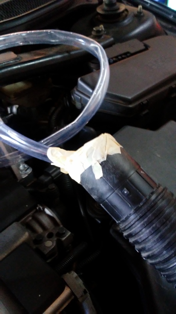

1. I removed the heater hose lines from the firewall and vacuumed the coolant out. I didn't want to deal with all that coolant spilling inside the car. Not a drop spilled from the core when I removed it.

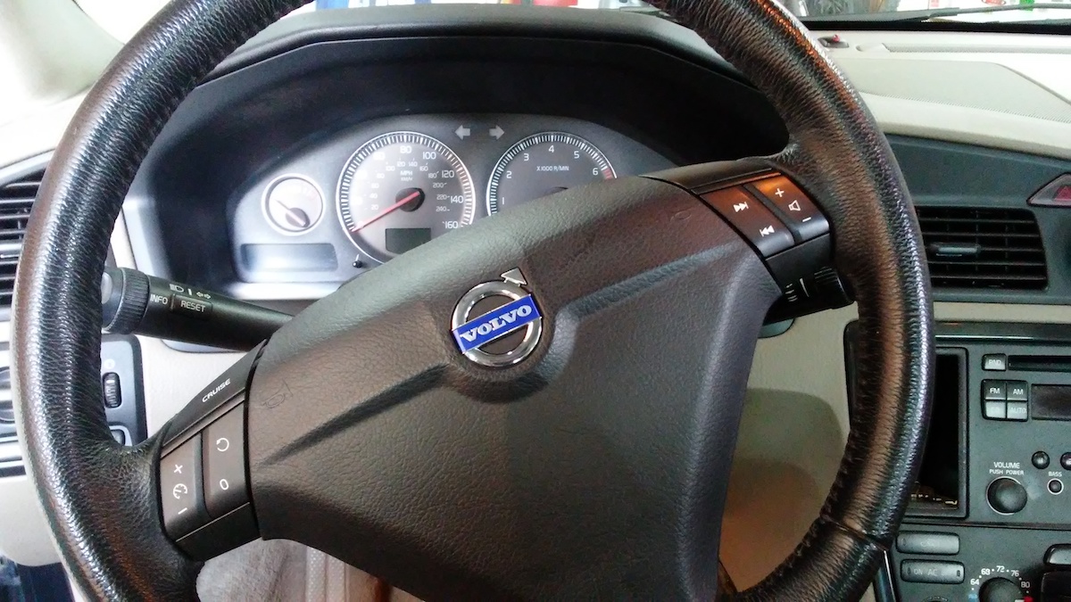

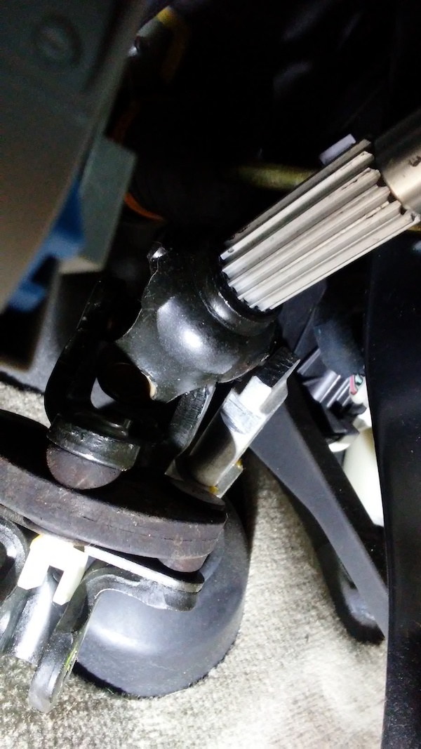

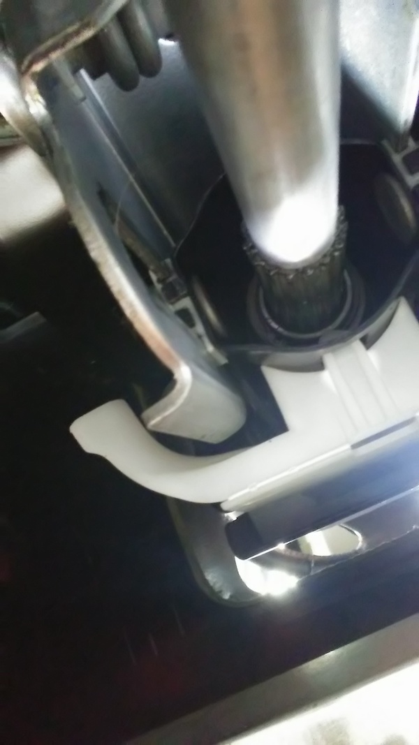

2. Removing the steering CV like joint is critical. I couldn't figure out how to just maneuver it out of the way. Once you remove the bolt, as documented in the video, just pull the CV joint part straight down and out. NOTE: With a sharpie, mark a spline that points directly down, otherwise it might take a couple attempts to get it installed correctly so the wheels and steering are both straight at the same time.
The CV part and splines you want to mark The view of the part entering the steering wheel What happens when you don't install it correctly. I was driving in the straight line with the wheel like this.
Other then these additional steps the process is exactly like the video.
