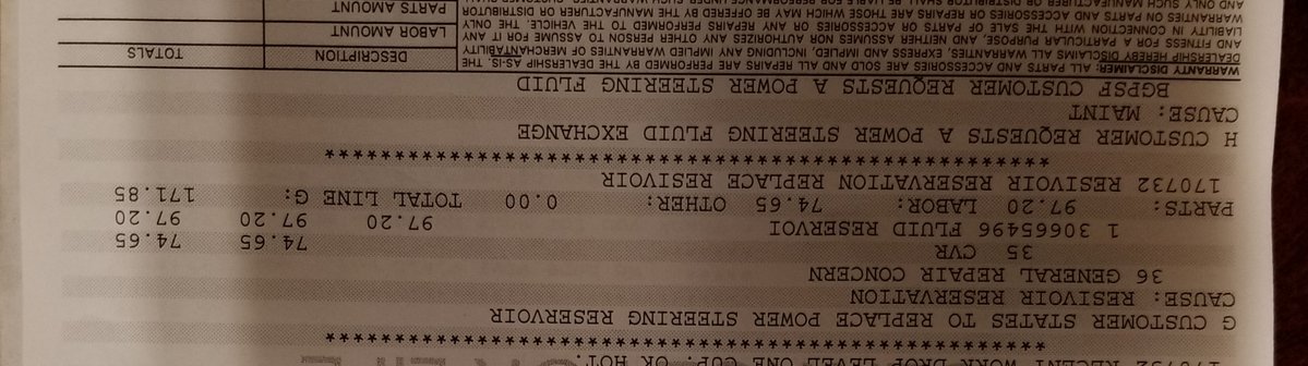

Mine was replaced with genuine Volvo parts by my dealer. So I agree Genuine Volvo only on the reservoir. June
I added the line off my bill. $171 parts and labor.
