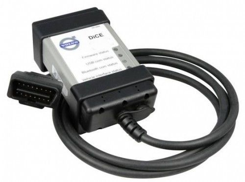

Most scanners can't pick up all the sensors accurately. In this case I feel it's time to pull out the big guns.
