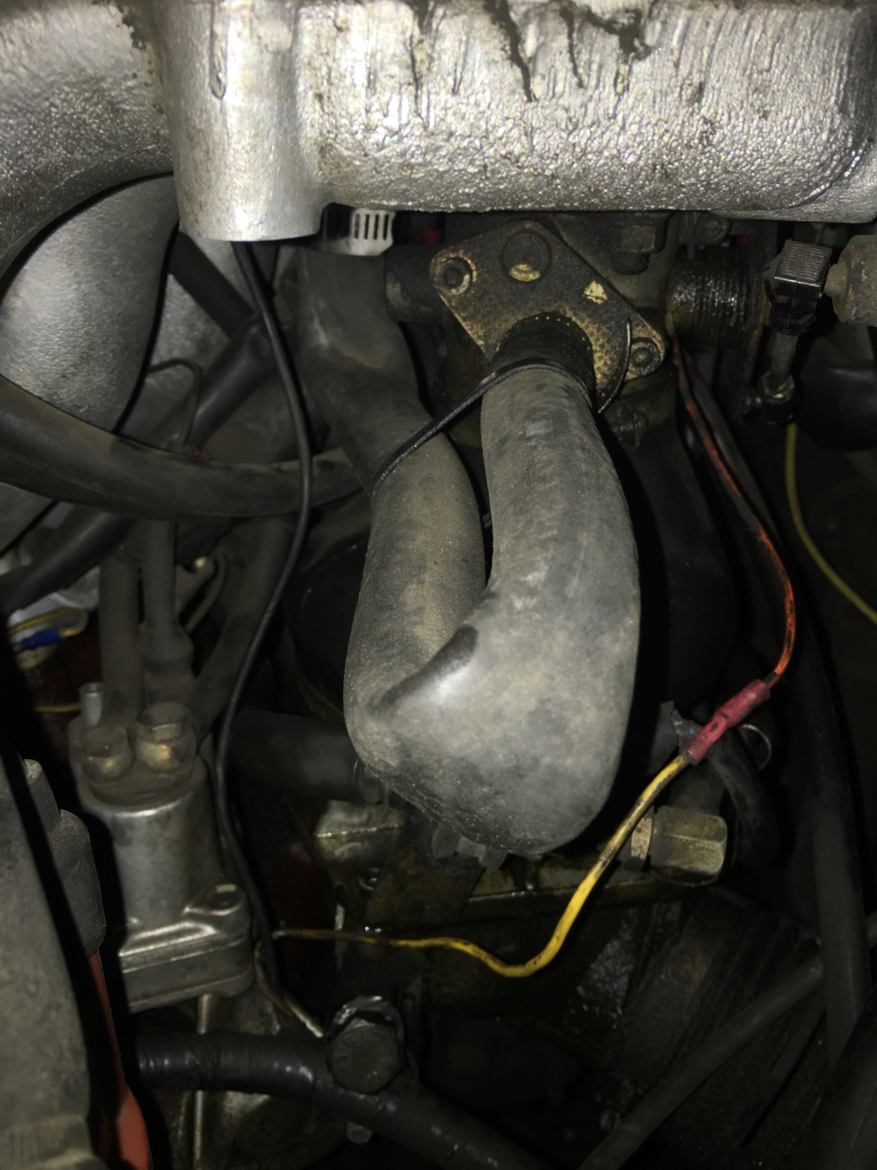

So my 1982 245 has a very high idle -- especially in park/neutral -- and I've been trying to solve it.
While attempting to fine the idle adjustment screw I discovered what appears to be some very rigged solutions to past problems. I purchased the car from a woman who had a Volvo mechanic basically hobble it together out of two parts cars and I'm slowly discovering more and more interesting fixes to solutions. I'm a very very amateur mechanic so bear with me here.
I'm wondering what this 'fix' is:
As you can see its right below the intake manifold. From what I can discern from the manual I have it seems like this should be where the idle adjustment screw/etc is? I'm assuming this being weirdly zip tied etc might have something to do with my high idle as it seems like this would change air flow/etc.
ALSO:
Off of the air flow sensor I discovered this hose coming off the front with a screw in it -- I'm assuming to 'seal' it... what is there? Where should it be going?
ANY advice/ideas would be amazing. I recently moved across the country (to Philadelphia) so I don't have the wealth of resources I had in Portland to have somebody just take a look at it when things are over my head.
​​​​​​​Thanks.

MoonsMoons wrote: 24 Jan 2019, 18:051982 245 has a very high idle -- especially in park/neutral
Based upon a 1981 VW Rabbit with Bosch CIS, the
1. sensor plate is not coming back down to where it should be, or
2. intake manifold is sucking air via vacuum hose, brake booster, etc. all air must pass thru sensor plate, or
3. Auxillary Air Valve (Air Control Valve) is wide open...defective
Without seeing engine, I don't know what that kinked hose is about

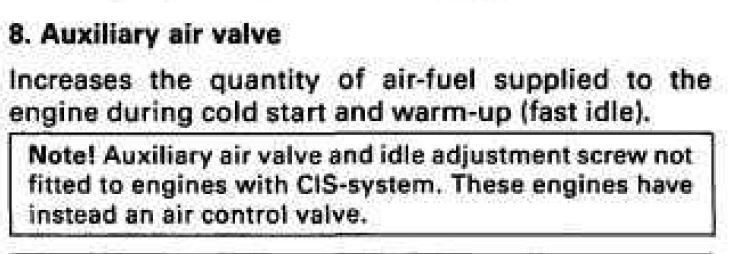

This capture below was for Volvo's other engines of that era

I have CIS shop manual for your year, but apparently, there is an Auxillary Air Valve
If yours does not have one, then this may be what that kinked hose was about

93Regina wrote: 24 Jan 2019, 20:29 I have CIS shop manual for your year, but apparently, there is an Auxillary Air Valve
I'm not finding an auxiliary air valve OR the idle adjustment screw -- which from the second photo you can see are part of the same loop.
Again I'm no real mechanic -- so I could be missing the boat entirely here but from what I've been able to discern this seems right.
Also the bolt 'plugging' the hose seems like that could be a big part of my problem as thats basically where air sensor and throttle body meet -- I'm wondering if the terrible streets and potholes of Philadelphia loosened that 'fix' and now that is leaking air -- whereas before the bolt plugged it. When I investigated it I found a bunch of mauled rubber from where the bolt meets the hose. Maybe when they first put it in there it ate up some of the rubber and formed a good seal.

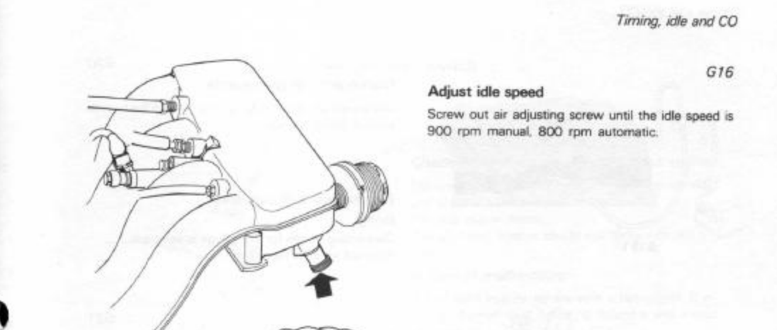

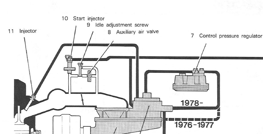

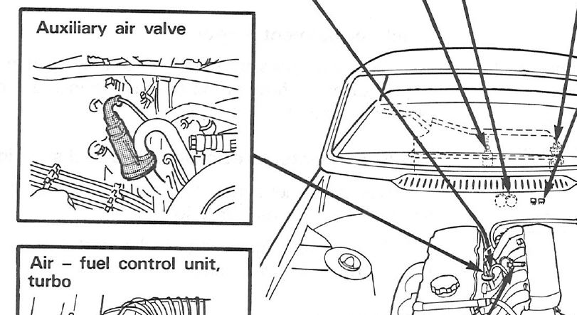

So did some digging and found this:
Screen Shot 2019-01-25 at 10.23.33 PM.png (314.24 KiB) Viewed 1542 times
Which seems to line up perfectly with the hose with the zip tie on it. Any ideas about that?
Screen Shot 2019-01-25 at 10.30.47 PM.png (361.4 KiB) Viewed 1542 times
Screen Shot 2019-01-25 at 10.26.49 PM.png (334.77 KiB) Viewed 1542 times

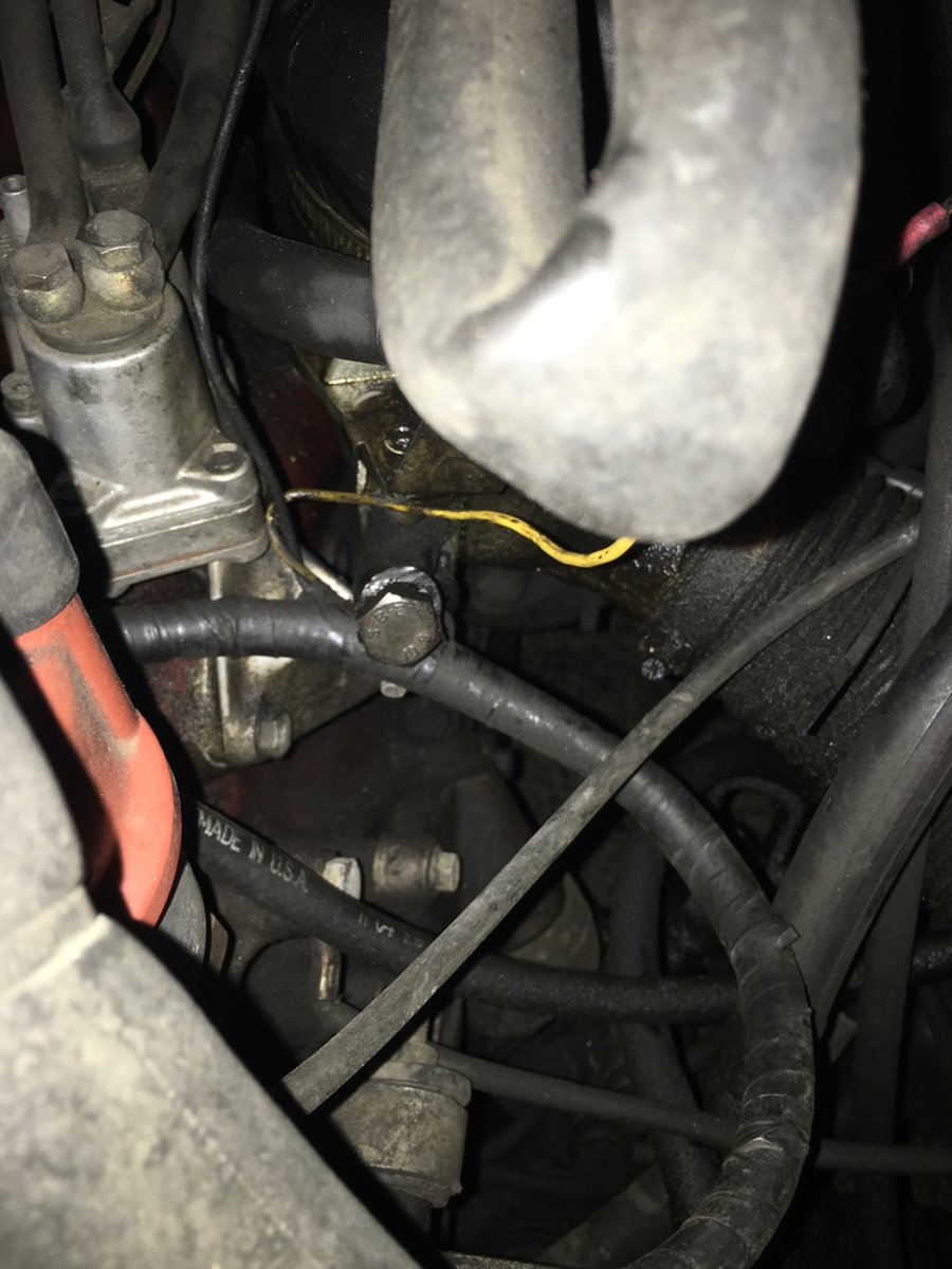

At the front of the bottom of the air flow sensor appears to be the hose that is plugged with a bolt. Any idea what that is? I can't find any information in this manual to tell me what that part actually is.
And:
Screen Shot 2019-01-25 at 10.33.41 PM.png (252.99 KiB) Viewed 1542 times
I'm still not finding this idle adjustment -- I'm really confused by that.
