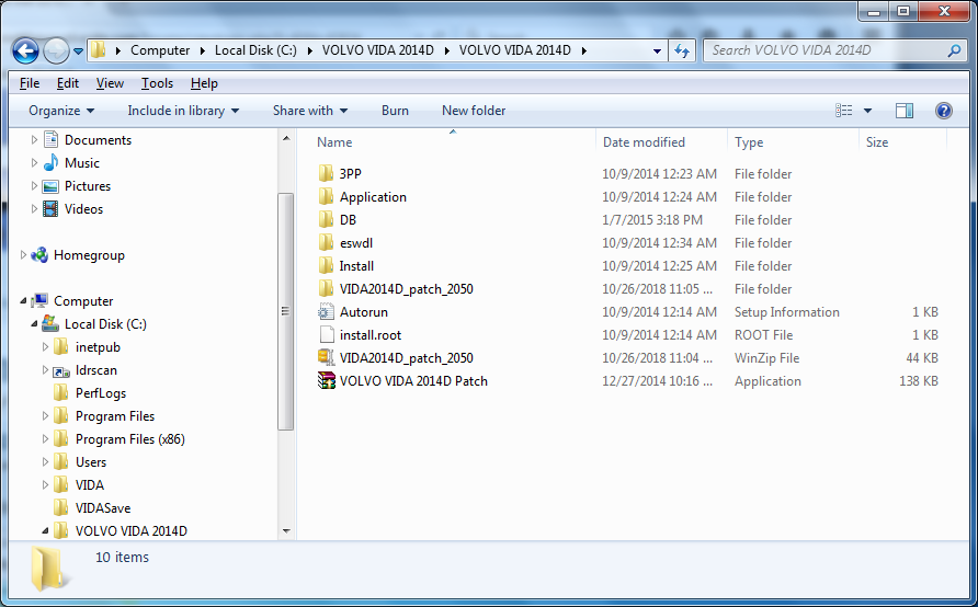

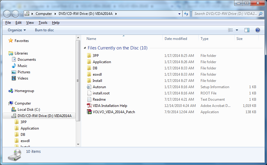

Extreme cold temp helps with staying home and taking care of things otherwise postponed. Here are few:
Still no sign of DiCE Hardware, but DiCE was Recognized and listed under Ports. DiCE Usb Driver x64 and DiCE x64 are there -- progress!
Windows Driver Package - J2534 and SETEK AB -- any conflict for DiCE Hardware?

xHeart: It is getting clear you have a DiCE that deviates from the original design. Do you have a link to the one you bought?

Original 2014A, purchased in 2015, that came with DiCE Device and DVD Media and worked like your set up.RickHaleParker wrote: 27 Jan 2019, 09:49 xHeart: It is getting clear you have a DiCE that deviates from the original design. Do you have a link to the one you bought?
2014D Update purchased in October 2018 via eBay (files only) -- your suspect.
- MVS_VIDA2014D_DownloadedFiles_0227.png (118.36 KiB) Viewed 2210 times
- MVS_VIDA2014A_OriginalDVDMedia_0227.png (121.58 KiB) Viewed 2210 times
