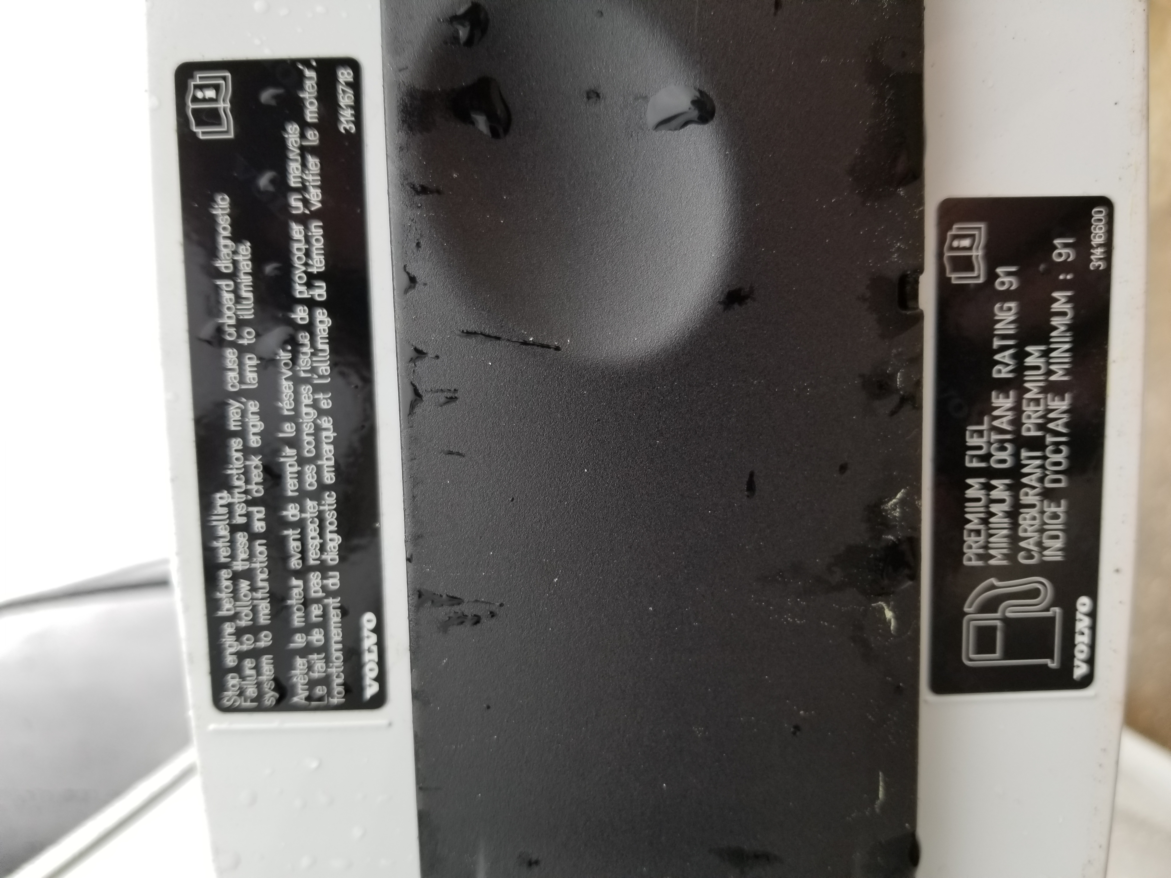

T5 sucks with AWD.... So T5 is best bought as FWD. Otherwise it is as slow as a old 240NA. T6 only is HOT when in Dynamic driving mode with Premium fuel. Notice on the fuel door of all Drive E equipped cars "premium fuel required". It means just that or they drive horribly. It so happens I am in a Service loaner 2018 XC60 and here is a photo of the fuel door. June

As I mentioned above Premium required. So test driving a car you really feel serious about get as much Premium in the tank as possible to get a feeling of the actual power otherwise the cheap 87 most will have in the tank will put you off a perfectly good car.

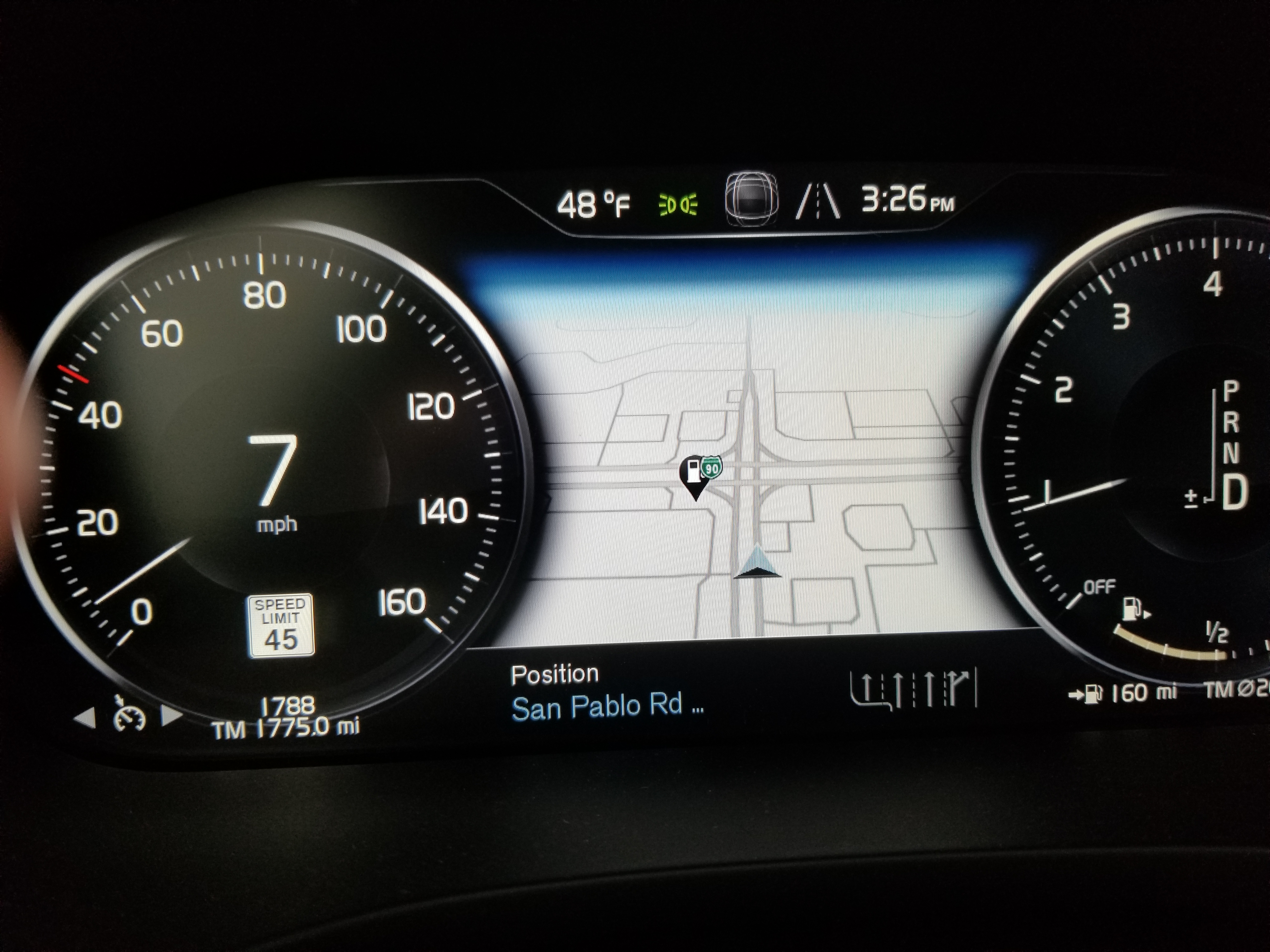

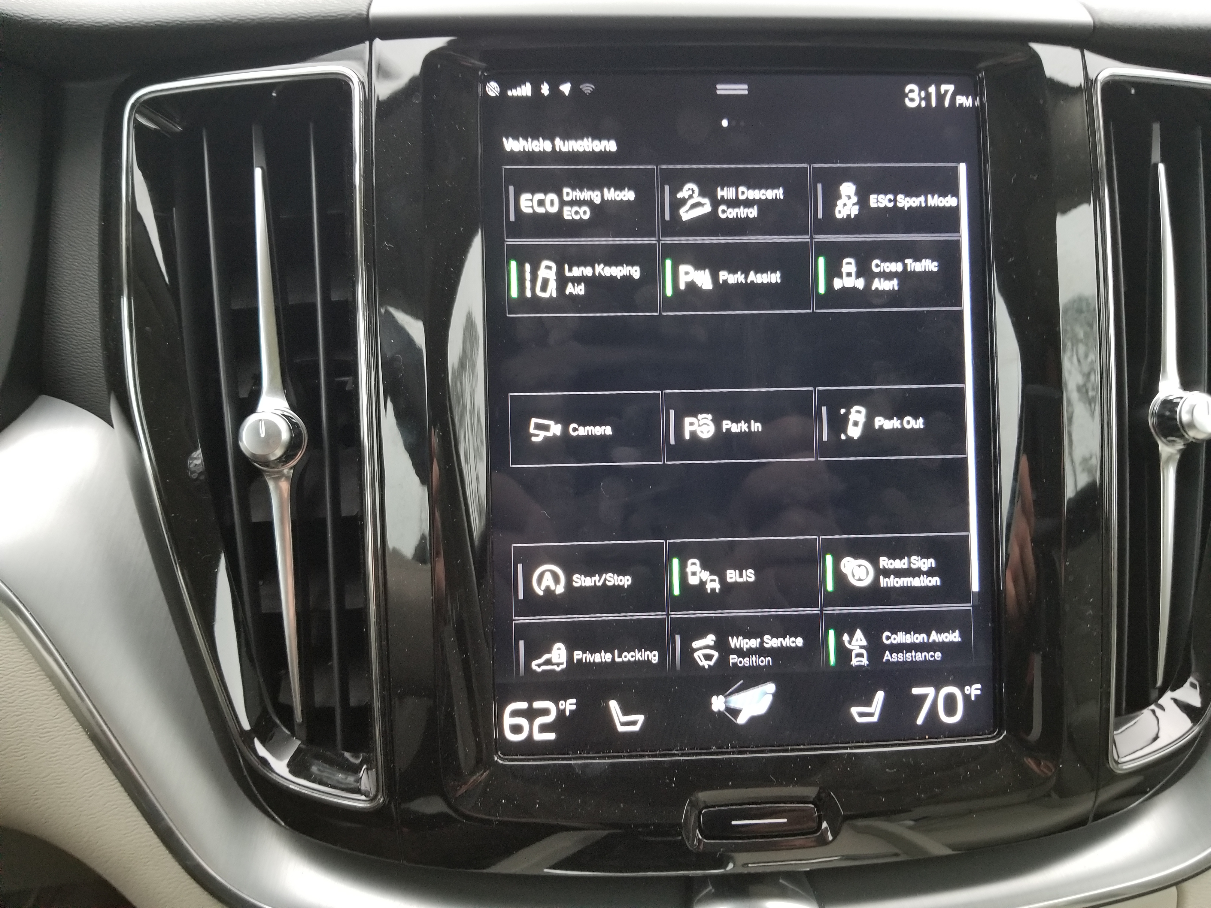

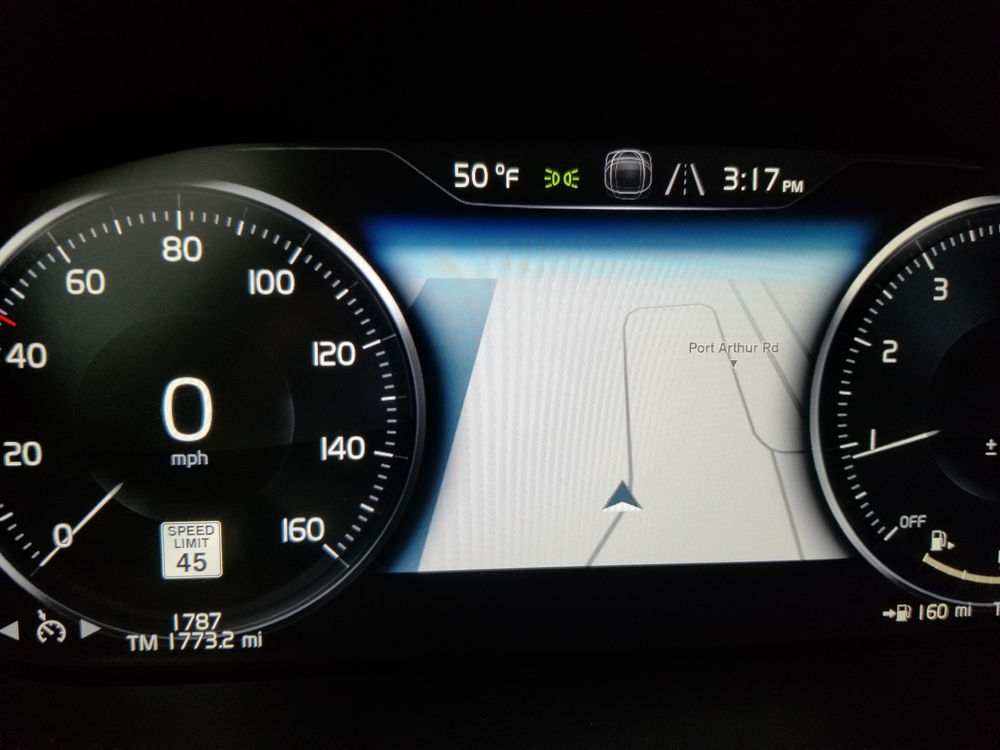

If you get a 16 up XC90 or 18 up XC60 look for this dash. It is optional. Also here is the autostart button. On the old XC60 it is a actual button in front of the gear shifter. June
