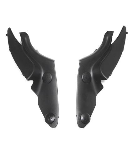

Anyone know where to get these for for an 2008 XC90?
I can only find them on IPD for the S60 V70 XC70.
https://www.ipdusa.com/products/8849/12 ... 0-v70-xc70
2008 XC90 Lower corner windshield & cowilng rubber trim

8662736 for Left, 8662737 for Right, all XC90 model years are the same. Can find in Body and Interior/Windscreen Drainage. Put on new when I had my windshield replaced on the '08, the '05 got a set a couple years ago when one got torn. Nice and easy on the install, some tabs and notches that hook under the fender lip, you'll see what I mean when you get the part and pull the old one off.

Perfect! Thanks so much!
