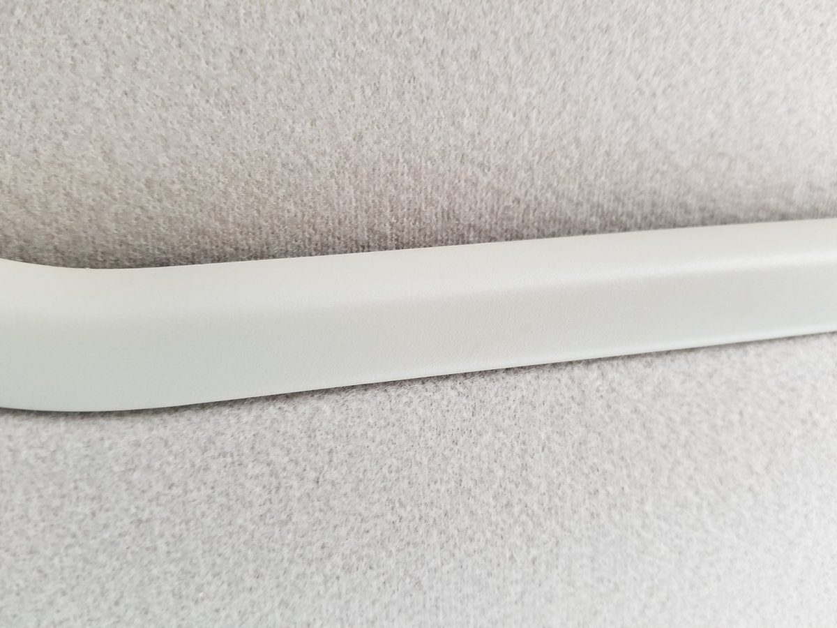

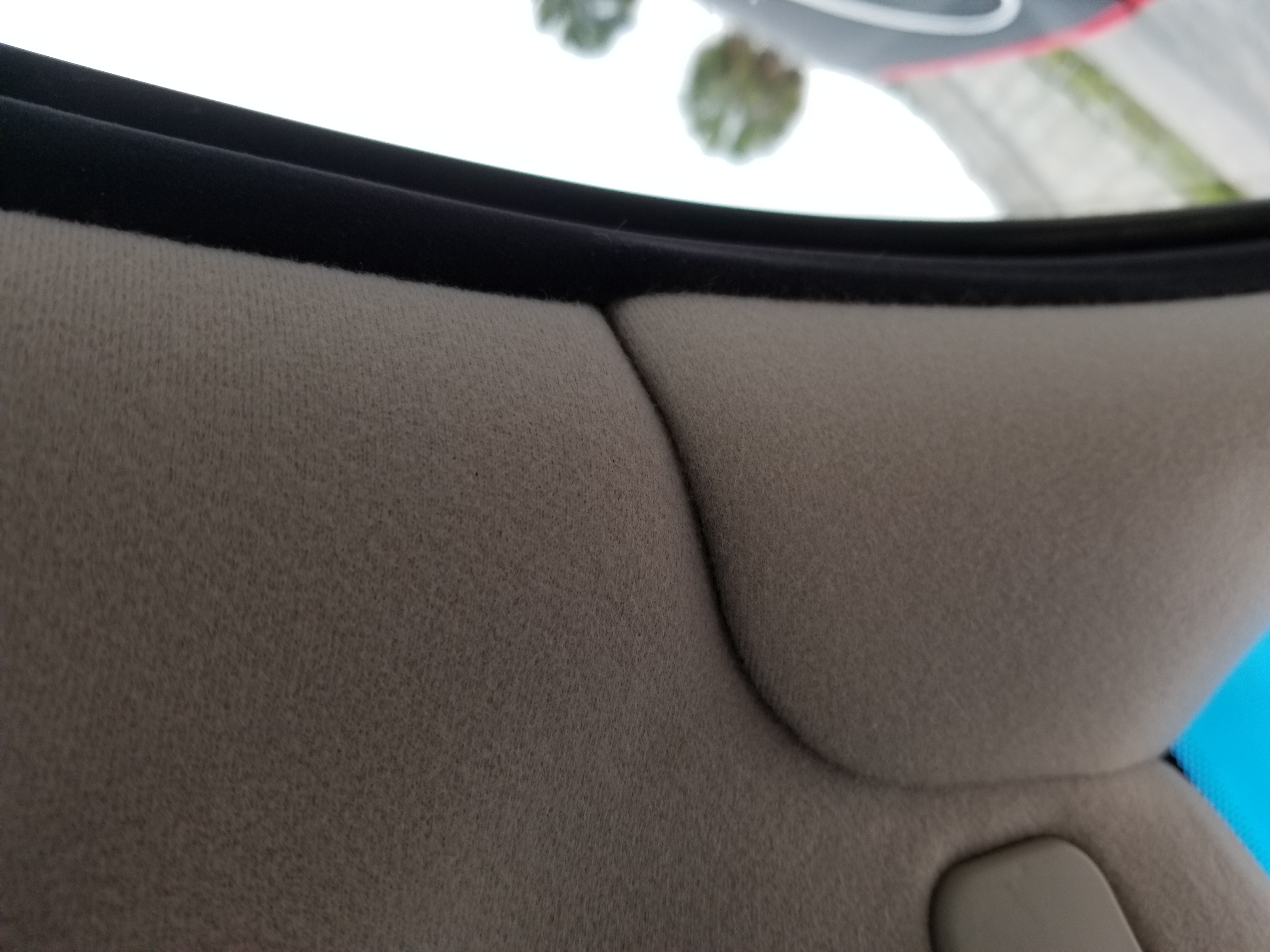

Ok here is the new A pillar and sunshade both replaced with Genuine Volvo, but headliner is factory. The color match is perfect as well as fabric texture. JuneJune wrote: 31 Jan 2019, 12:38It did on mine and I live in sunny Florida. The A pillars and moonroof sunshade match the original factory installed headliner and visors perfectly. You would never know anything had been touched. I am particular about things looking just right or it bothers me. I realize my car is 15 years old, but Volvo still has the parts. So why not? Is my feeling. If someone else can't afford it, then used original likely would be a perfect match. Even the new leather on the driver's seat matched the rest perfectly and doesn't look oddly. When I get my car back I'll snap some pictures. JuneRickHaleParker wrote: 31 Jan 2019, 12:25 Even if you can get an old stock Volvo, would it match perfect with an aged interior .... ?
Addendum;
Found a picture I was able to zoom in to show the color match of the new A pillar and the old headliner. Can you tell a difference? When I get my car back I'll take good pictures and add them. June
