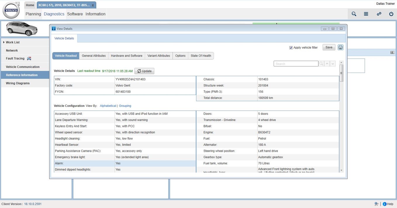

Here is a screen shot showing the tabs. Variant Attributes is a detailed list, like a build sheet, maybe it is the build sheet as it exists in the Volvo system. I have all the pages printed out for my 2010 XC60. It shows features added like Polestar. It isn't called Polestar, it is something like enhanced performance ECM settings (car isn't home and the sheets are in glove box). Options shows the options like you would see on the window sticker and with order code number. The vehicle in this screen capture is my car.
