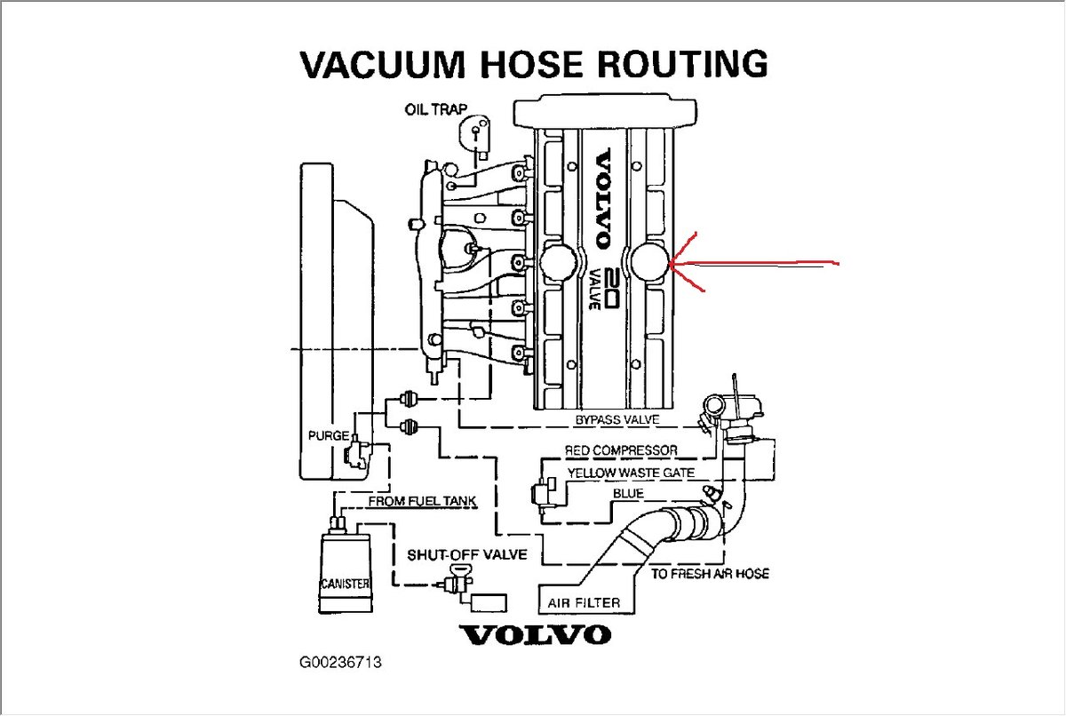

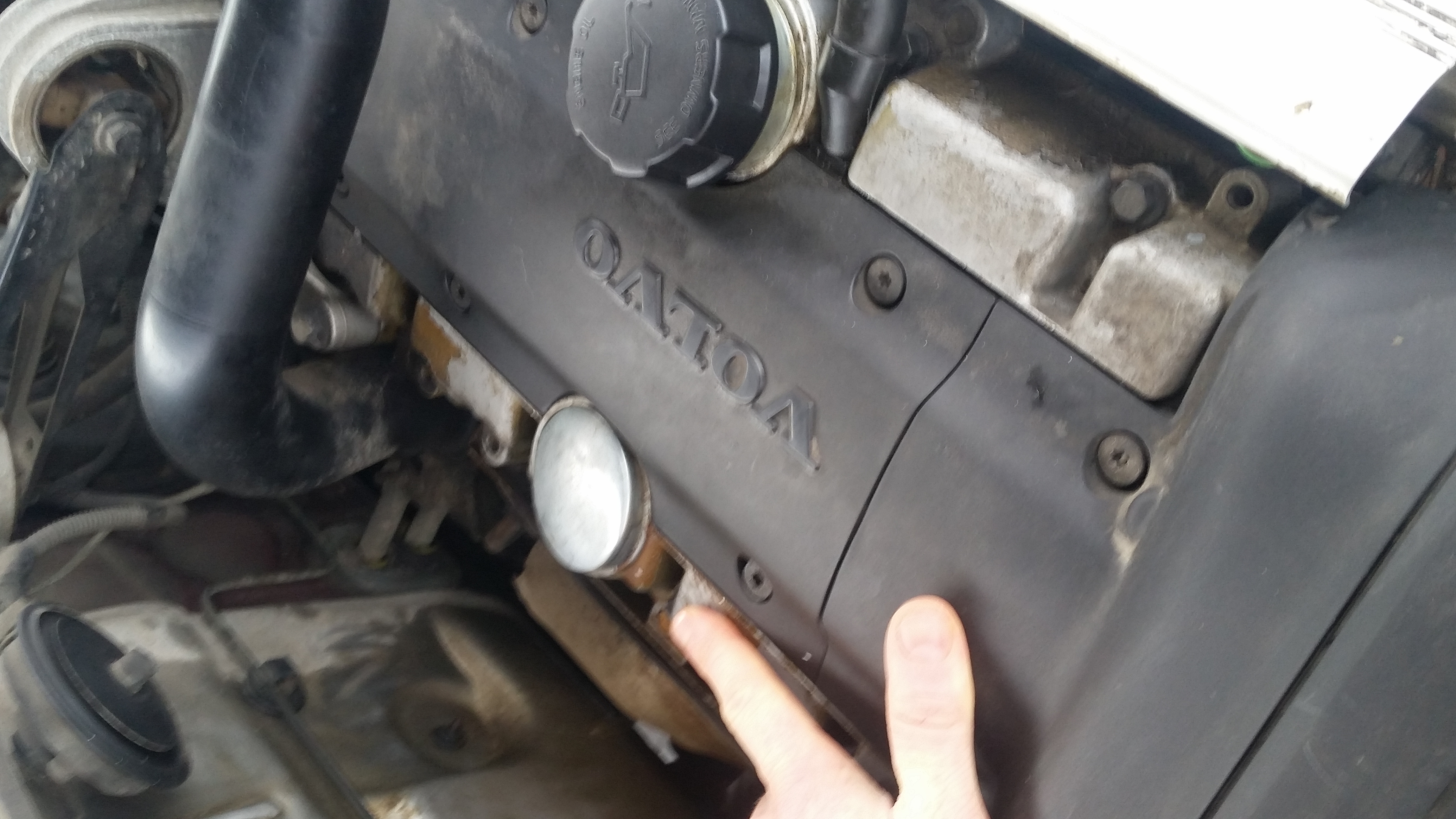

A cylindrical metal part at the top of the engine block used to be flush and is now protruding upwards unevenly. Sorry I don't know the name of the piece, and this has limited my ability to effectively search the forum. I've attached a photo of the part on a vacuum diagram and a picture taken in the engine compartment of the Volvo in question. The vehicle starts and runs well and is not leaking fluids, so I'm wondering whether to consider this a 'disaster waiting to happen' and take action or 'let a sleeping dog lie.'
I noticed the change in position/shape of this metal part at the same time I replaced the radiator following a minor coolant leak. The Volvo is an XC70 AWD 2000.

It is a plug. Check the PCV with glove test. June

Oh that is the cam cover, not the block. Perhaps that will help your searching. June

That is a plug.
As June said, do the PCV "Glove test". You'll wind up seeing an oil leak there at that plug, if you do have a problem with excessive crankcase pressure (Due to a clogged PCV system).
You should be able to tap that back into place, if you're careful and not ham-fisted about it.

I believe that plug is supposed to be installed with a special type of glue

When I check on volvo parts lisle site I think this is the part number for a new plug:
Volvo 1361451

Purpose is so Volvo can locate the Oil filler on either side of the engine.
Take a rubber mallet and tap the plug back down, then keep a eye on it.
Do the PCV glove test.
Glove stands up = Fail.
Glove suck down = pass.
Make sure you tie down the glove as shown in the video so that it does not get sucked into the engine.
[youtube][/youtube]
[youtube][/youtube]
